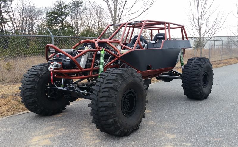

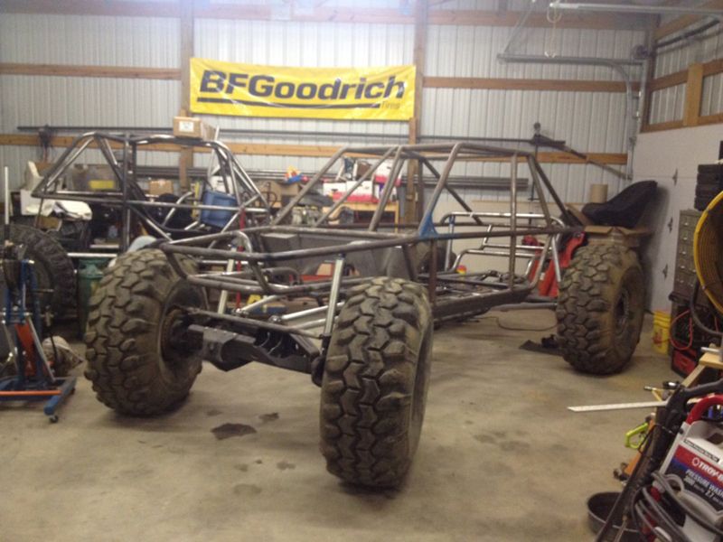

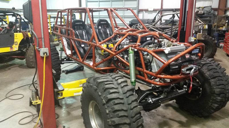

Thought I would post up some pics of a 4 seat buggy project we just finished. Customer brought us an F-Toy chassis on tons, 44s...and a built 468 BB Chevy! We decided the chassis was not going to stand up to the abuse the Big Block was capable of dishing out. So after extensive chassis rework, we belive we have arrived at a capable 4 seat hill killer!
Some specs...
Built 468 BB Chevy with Holley Terminator fuel injection.
TH400
Atlas 3.8
Tons with Detroits, 5.13 gears
16" ORIs
44" Boggers
Trailworthy Fab wheels
Aluminum links
PSC Steering
Corbeau XP, front and back
Artec Trusses
Oliver Driveshafts
