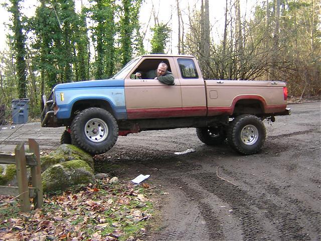

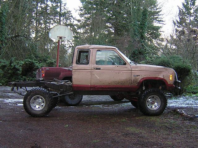

my 87 ranger plus. from 33'' to 38.5''
4'' sky jacker 13'' longer traling airems 2''body lift 33x12.5 procomps.
not bad but not enuff.

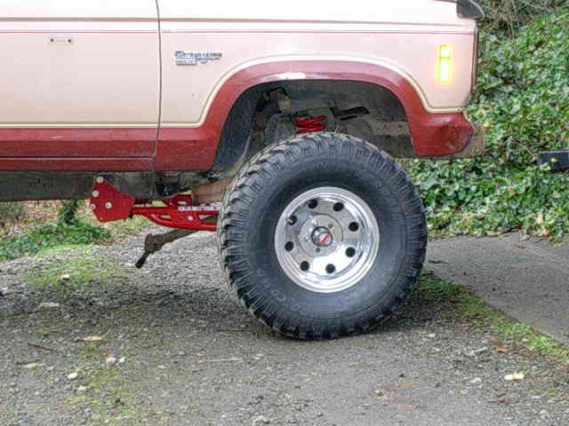

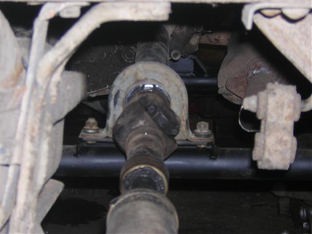

you like that drive line didnt have the trany in it yet

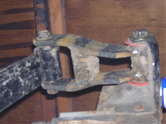

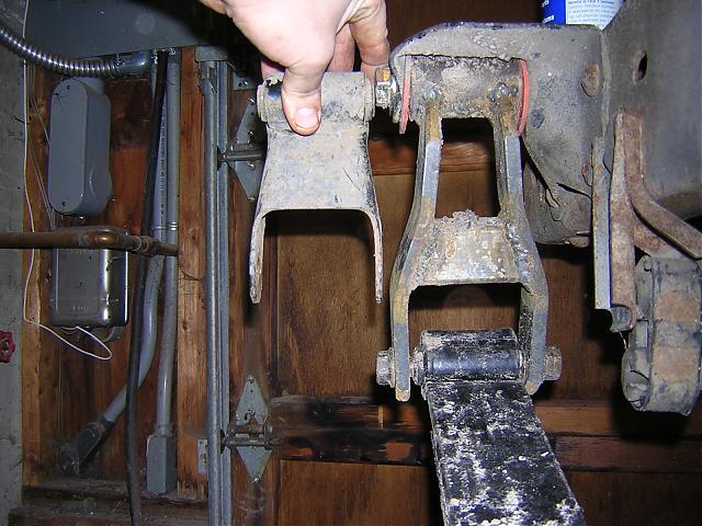

couldnt find any shakles so i made my some

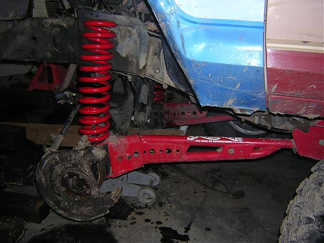

and put in 6'' coils up front. still running 33x12.5

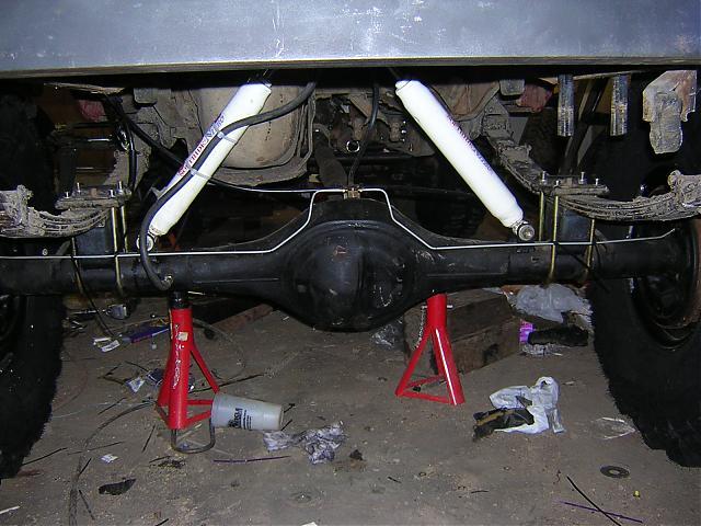

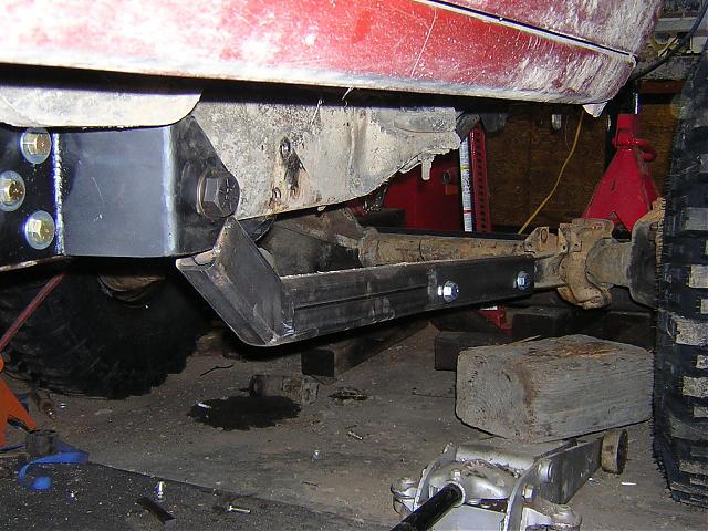

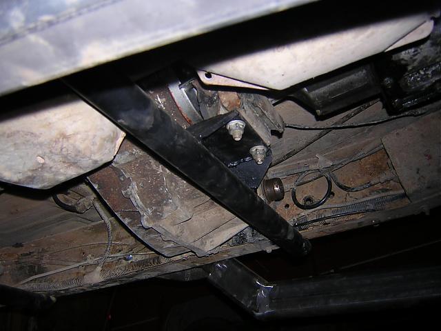

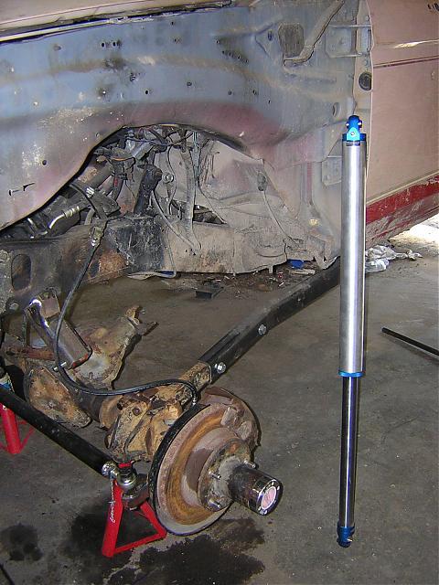

with a stock front end i kept braking axils and u joints so time for an up grade.

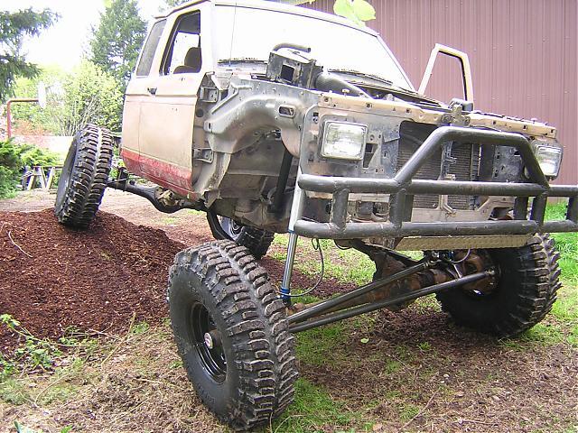

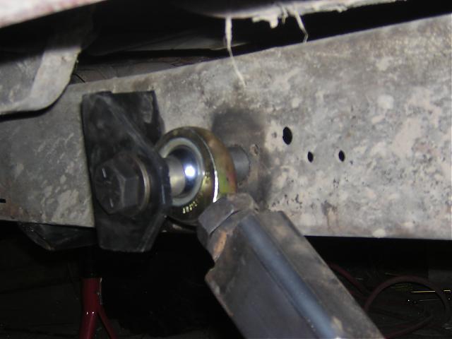

i got a dana 44 out of a 78'-79' bronco full size for the front end, i found a ford 9'' heavy duty out behind the barn out of a 80' ford. both are 5 on 5.5 but gears are way off. the 9'' was ez to put in. it just cutting off the old leaf spring mounts and welding on new mounts. the dana 44 fit in to the new sky jacker crosmember but didnt have a lot of flex. so im extending the traling airms about 17'' or more and running fox 2.5 air shocks up front only, i get them this week. if i dont have enuff flex in back i may do a buggy spring. i have 38.5x11.0 boggers on it now.

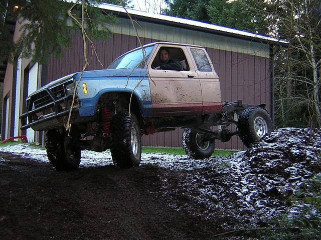

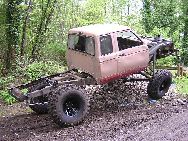

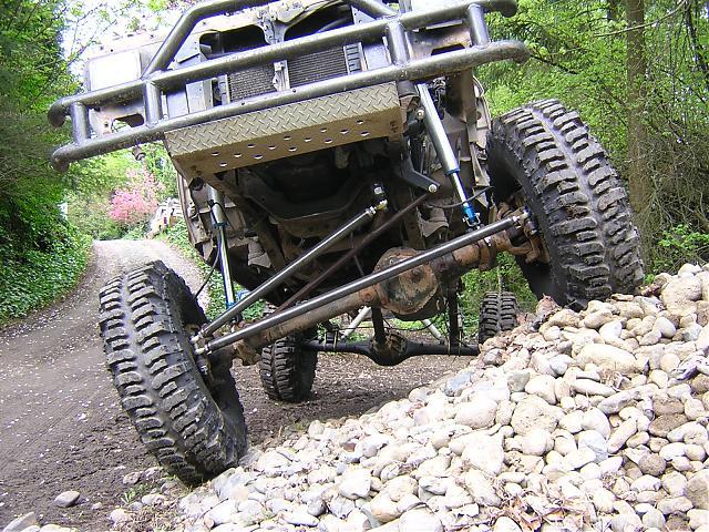

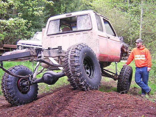

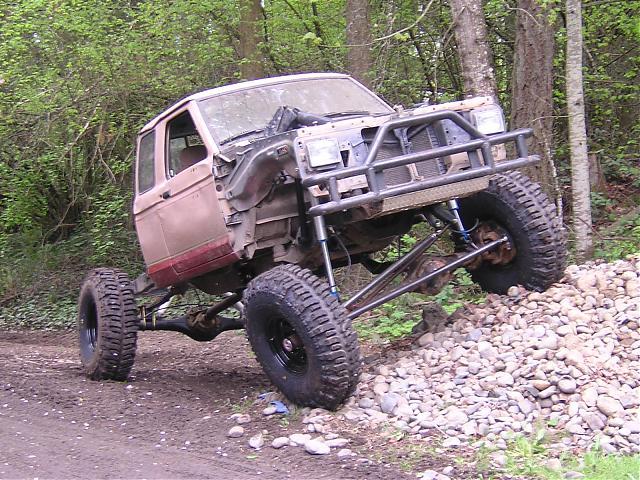

so what do you think of my flex??? the ass end sits lower than the front should i lower the spring hangers or by new rear leaf springs???? how do like my custom snorckal. lol. im workin on it now.

right on that looks pretty cool. what are your plans for the body of the rig? any tube going to be added?
