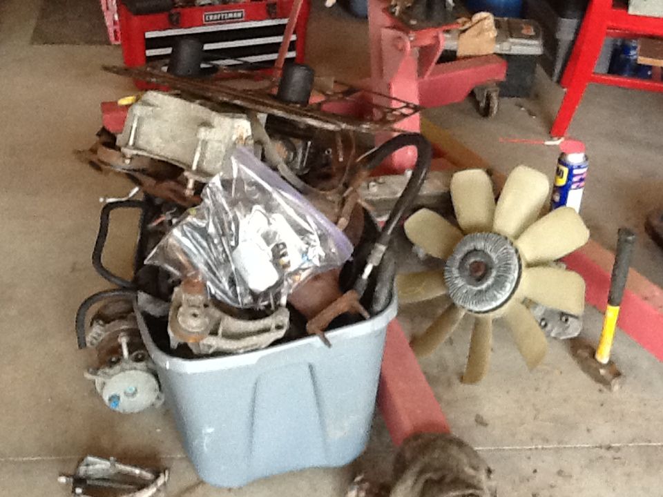

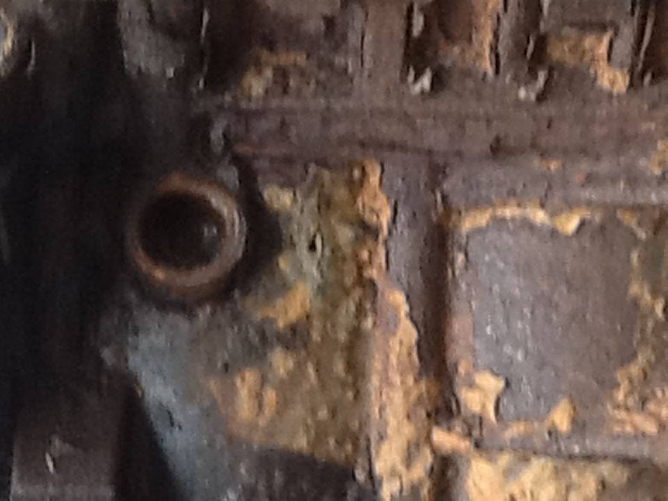

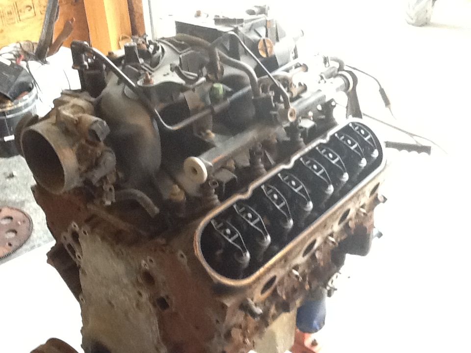

Bought a 99 LQ4 about five years ago, been sitting in the garage since. Engine was from a HD 2500 with around 70,000 miles and from the north. The block looked like it had been under water, salt. The insides were in perfect condition but going to build a 421 out of it. Big block Chevy's are the only engines I have any experience building so if there is any interest in this I will post up the progress.

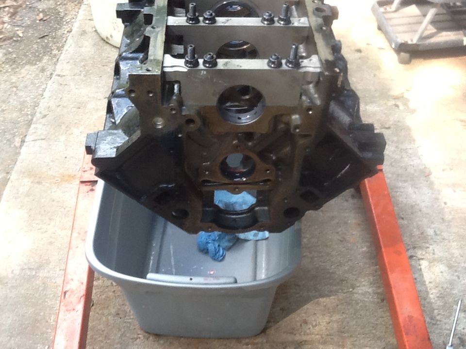

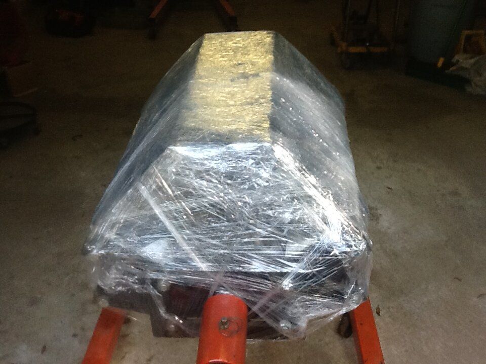

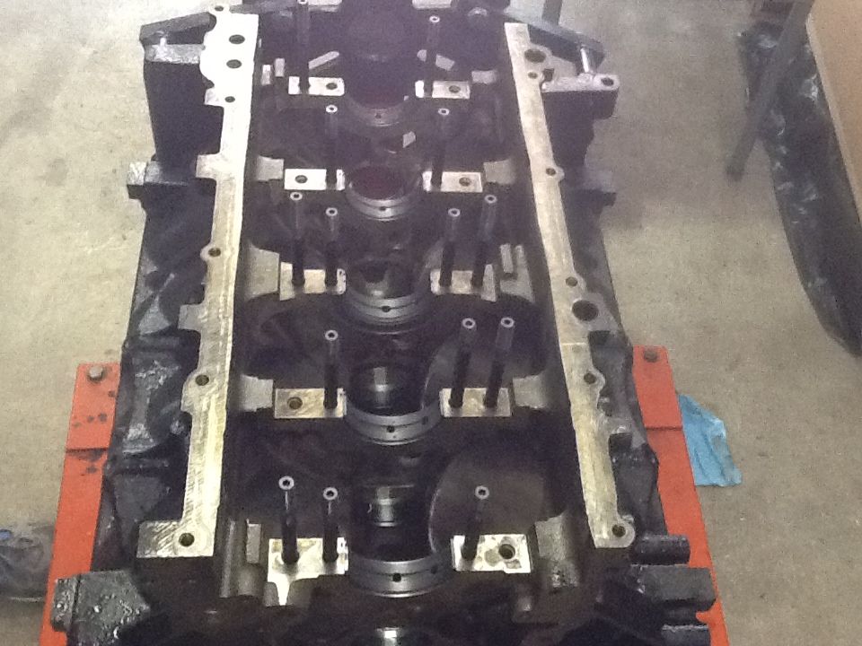

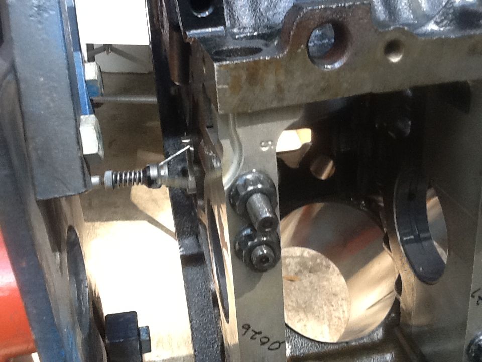

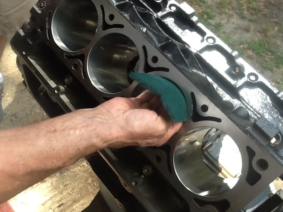

Don't look like much progress but got a lot of block prep done, takes a lot of time to do it right. Used close to two cans of brake cleaner and a lot of WD 40. First pic will be upside down, don't know why I think I took it just like I took the rest.

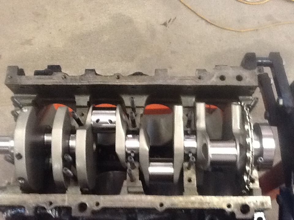

You might have already but check your main cap clearances. When installing studs it's know to make the clearance tight since the studs hold more when torqued down

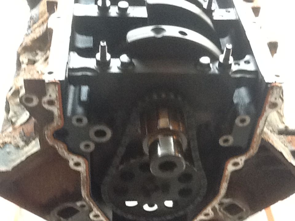

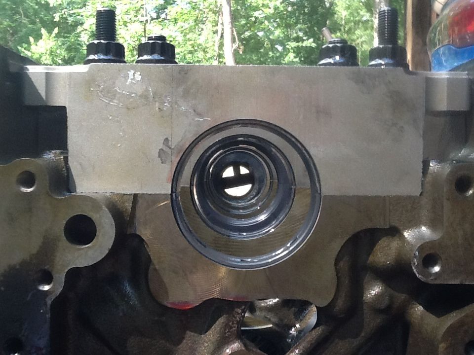

Going to be some uh-oos along the way and beings this is a tec. article I am going to share the experiences of my buddies that help me with this rig. First up is Mr. LS, JR Gortemolier. The first thing he does with a block that has new cam bearings is fit the cam. Cam bearings are a press fit, usually with a hammer and cam installation tool beginning with the rear most bearings working out to the front. Sometimes the faces of the bearings get smashed enough to make the shaft hang or worst case not let the shaft slide in without tapping it home. We don't tap and just my luck the cam would not slide past the next to the rear bearing. Once we cleared that one up it would not slide into the rear most bearing. We tried a stock shaft and it hung in the same places so we knew it was the bearings. We used a brake piston hone on a drill to clearance the bearings a little at the time. Rear bearing was worse. Took most of the morning to do this. I special ordered Dura-Bond cam and mail bearings, the clearance destroyed the coating and hurt my feelings in the process. If low or no oil pressure occurs at start up this will be a good place to suspect.

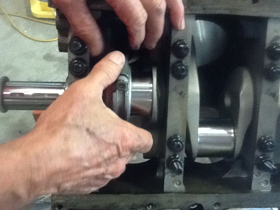

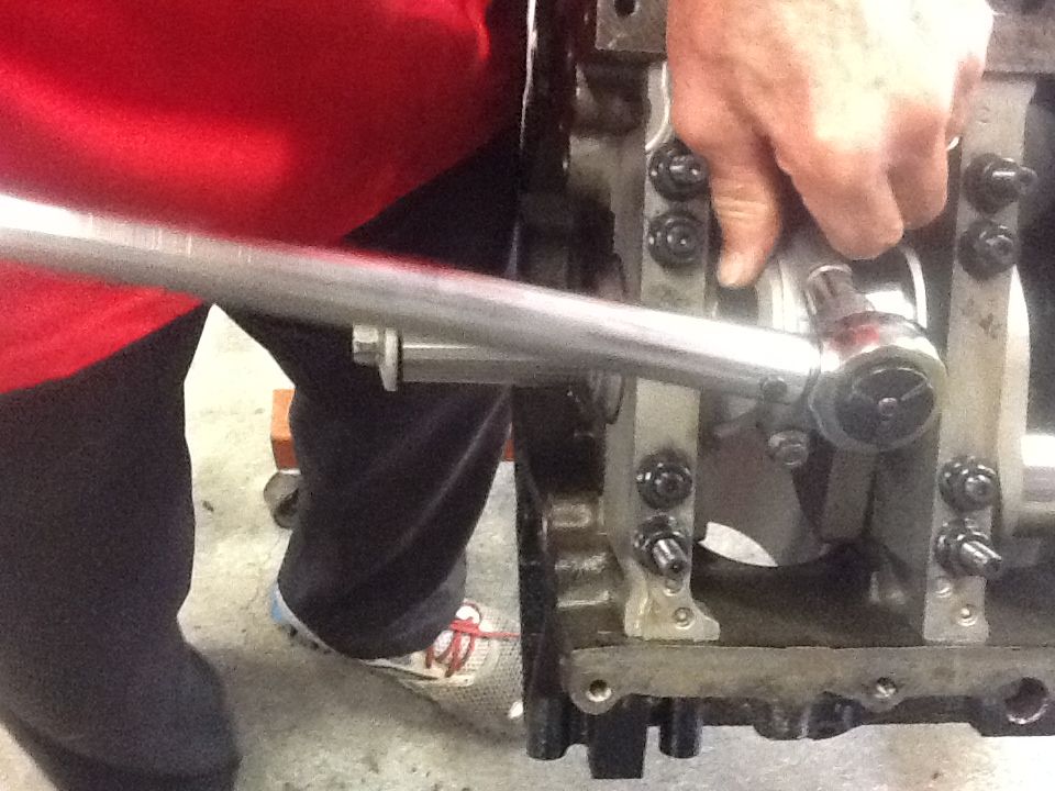

Yes, check, check and check again. Look close at the mains. A good machine shop writes the clearances on each cap and I have a paper with weights and other blue printing info on it. Any time a block receives studs it should be line honed. Back when I built my last engine in the early 90's it was $100 now it will destroy a $150 bill, but the clamping force is so much grater than bolts it will load the mains to the point of binding the crank shaft. You may get away with it but it will surly shorten the life of the bearings. Maybe another buddy on hand today will post a video to how freely the shaft turned once we get it in.

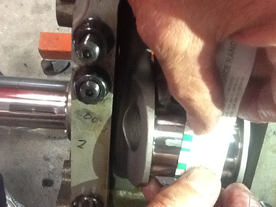

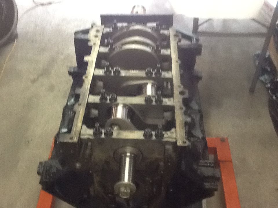

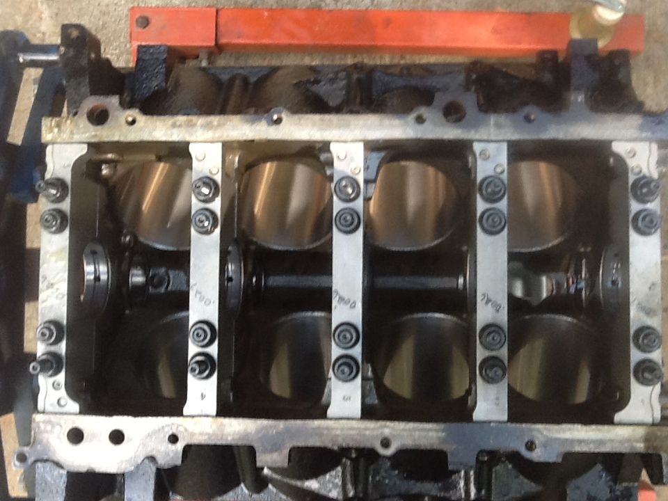

More tech, the machine shop checked the clearances and was in the .027 range but plastic gauge said .015. .015 is the tightest you can get away with. JR was not happy and suggested two options, polish the crank or get new bearings. I opted for polishing the crank. We went ahead and installed the crank to 60/50 and found out the crank was perfect, no way was it only .015. Here is what I think happened, new bearings, we failed to seat the shaft into the lower bearings, placed the plastic on top, placed the cap and pulled them down. In the process the caps squished the plastic from the top giving a false reading. What says you, open to all opinions.

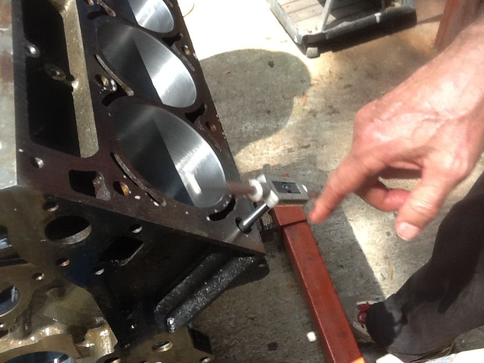

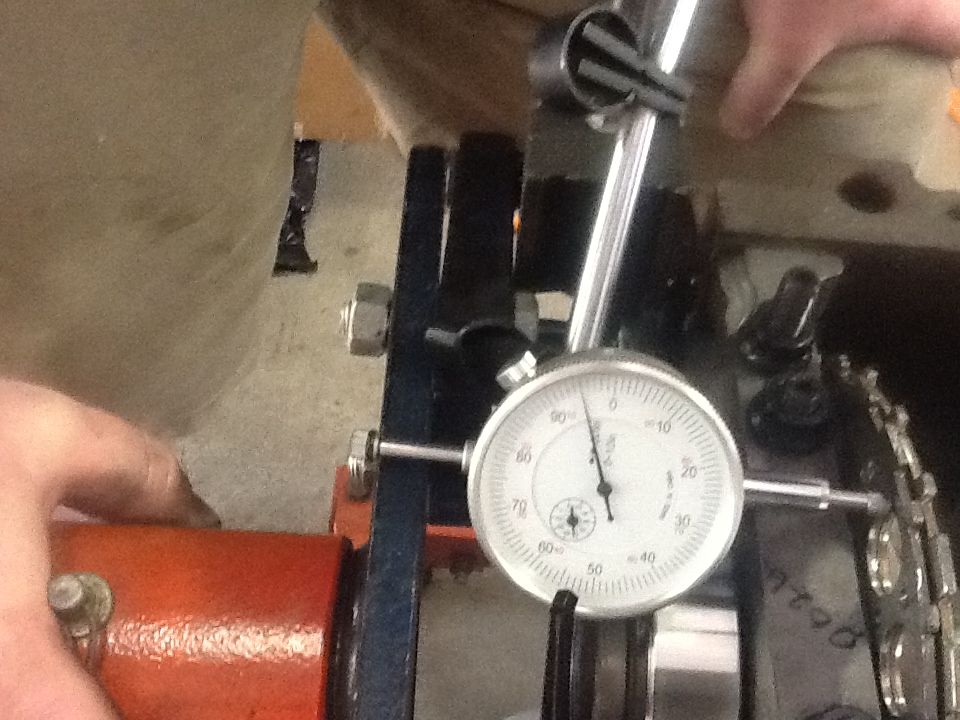

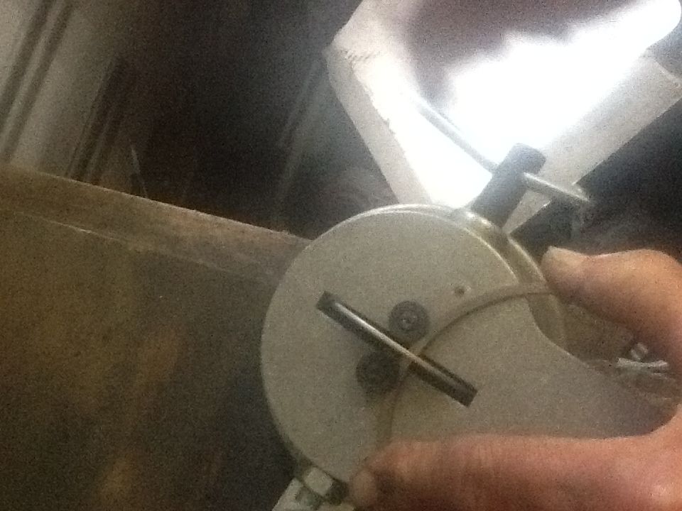

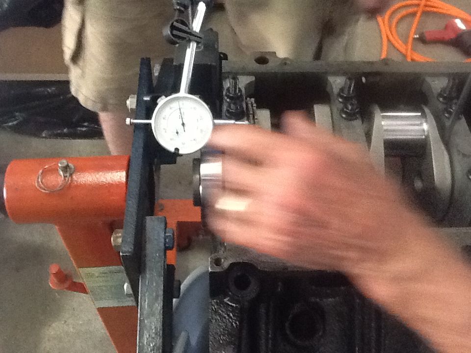

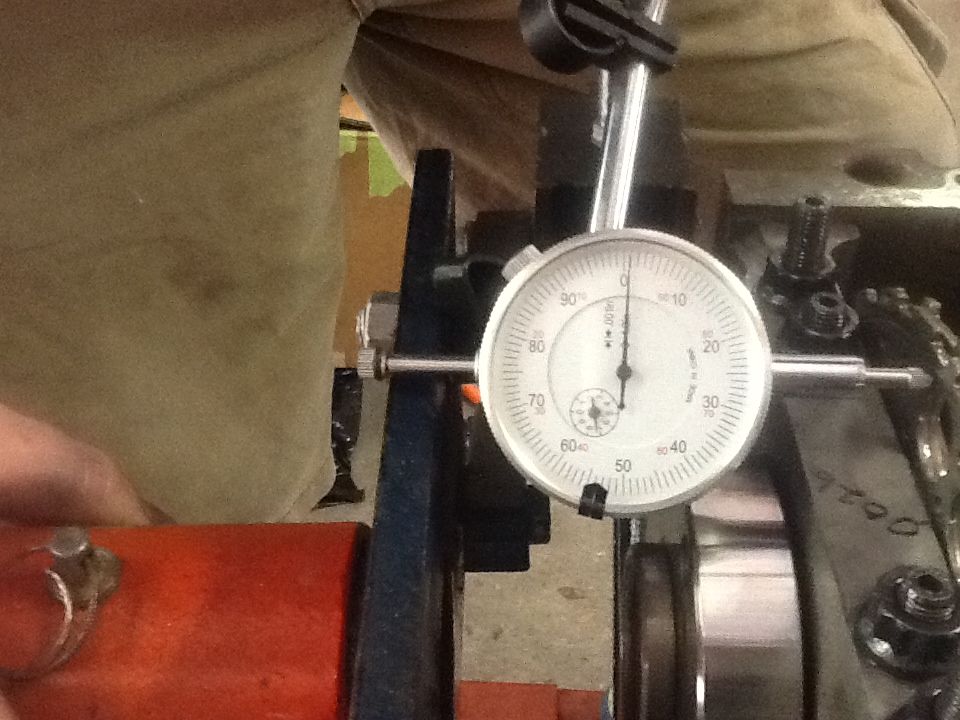

Major improvement over old school big and small block Chevrolets is moving thrust bearing from the rear of the block to the center of the LS block allowing thrust surfaces on both sides of the main cap. Here we measured .007 to the front and .007 to the rear. Within specs of .0015 and .0078.
Reluctor Ring specs up to .028 of run out, we are at .010 :dblthumb:

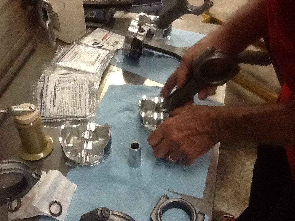

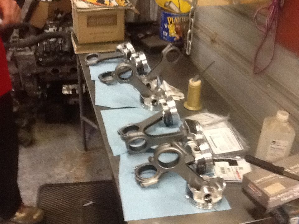

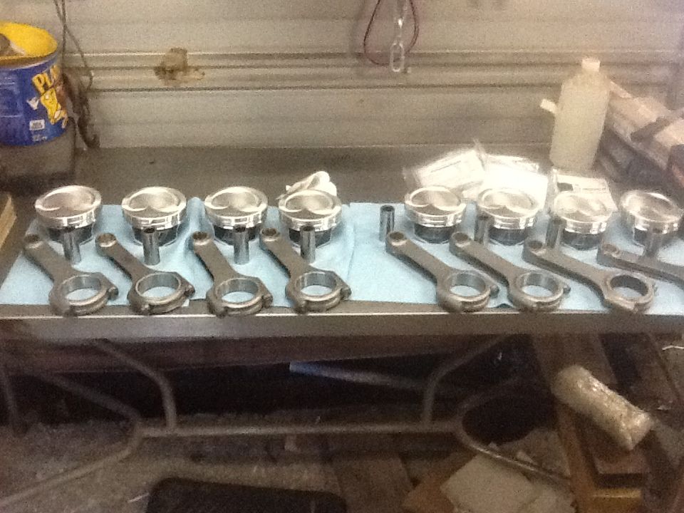

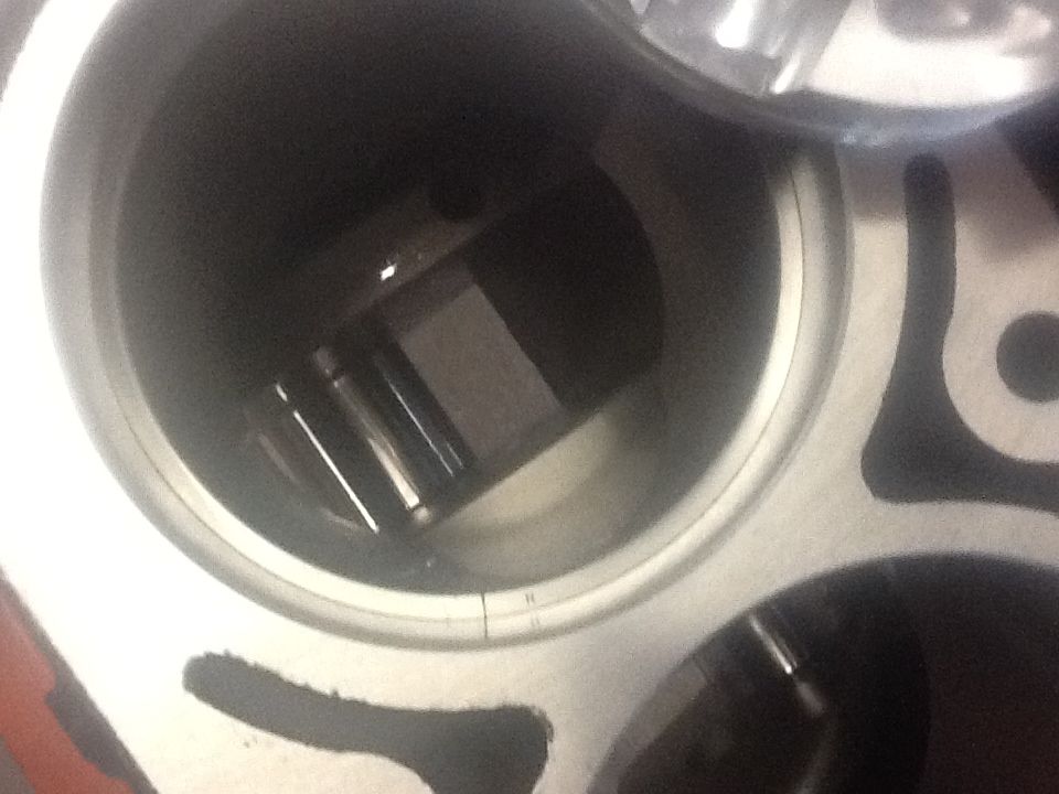

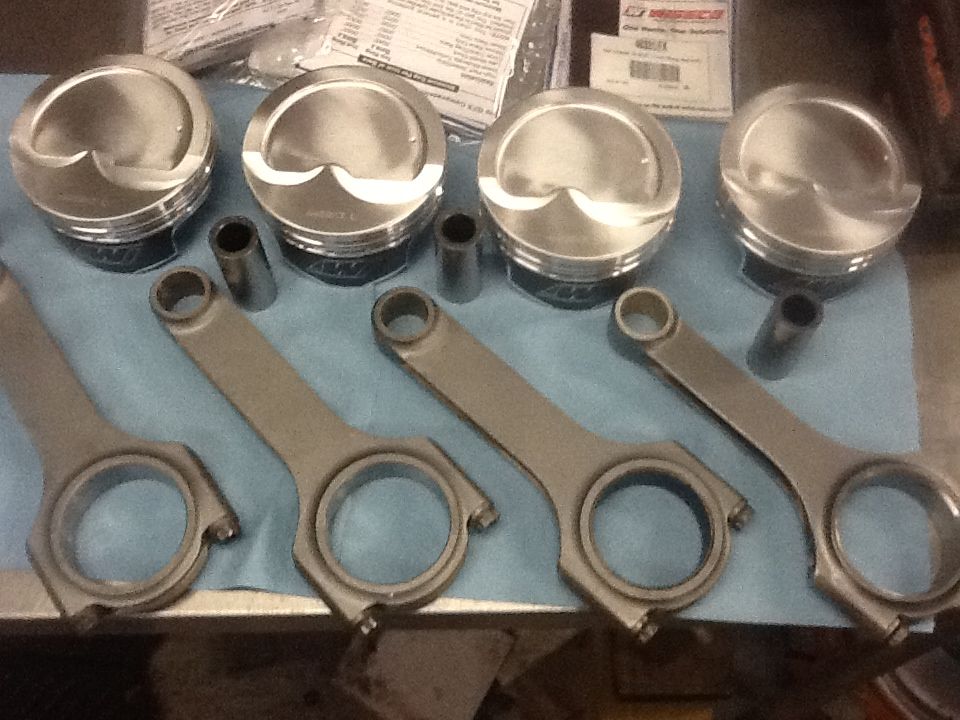

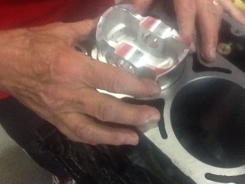

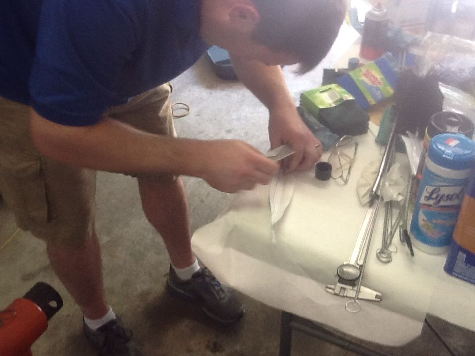

Only getting to work on the LS one day a week. Made a little progress today, it doesn't look like much but six hrs. of work today except for taking a break to hear JR's LS, 900+ hp Vet wake up the neighborhood. The day was dedicated to file fitting rings, checking bearing clearances, rod to rod clearances, piston in block fitment and mating pistons to rods. Patooyee was on hand again today and took on one of the most aggravating task of assembling an LS, inserting the spiral locks in the pistons. Like everything else he does he mastered the process very quickly and assembled seven pistons in less than a half hour, thanks JJ. One piston was left apart to use it to square the rings in the block. While JJ tackled the locks JR and I file fitted the rings all of which except the expander had to be filed. We opened the top ring to .020, 2nd .022 and at least .010 on the scrapers. I can add a little boost with that gap if I ever want to. All the clearance spec's. were all well within allowances and rod bearings were at .0015. I will add pictures in order of our progression. I did not get any of Patooyee wrestling with those locks because JR and I were busy filing the rings so I will get those next time. I have a set of CNC Trick Flow heads for this build. JR is a head porting fool so he worked his magic on the heads even though they are CNC. I really didn't think it would make a difference, boy was I wrong, they are slick. But, two valves did not lap in properly so off to a head shop for suspected bent valves, turns out just a seat issue and are on their way back. Didn't want to put pistons in until piston to valve clearance is checked just in case valve reliefs have to be massaged. If we get the heads back will likely get pistons in the block Thursday.

Those are the prettiest pistons I have ever bought, More pics. from today

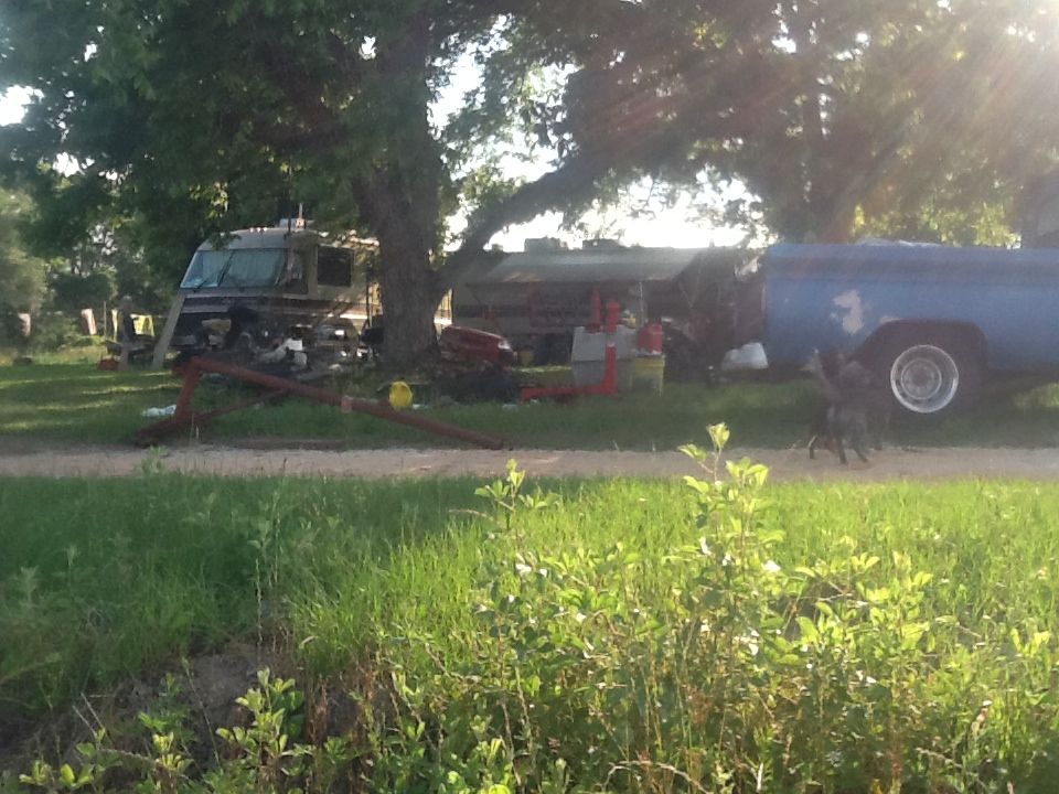

Last pictures from the day. Last picture is of my neighbors dirt road build. I am standing in the middle of the road, look close you will find a 350 on an engine stand with only a ditch between it and all the dust from the dirt road. The engine also was on the same stand during the six inch rain we had the other day. He put the crank in Sunday. I know this guy well, he can fix anything and I bet this engine will run perfect. It can't live long but it will run. Thanks for checking out my build. See y'all at The Wounded Warriors ride, Morris Mt. this weekend.
