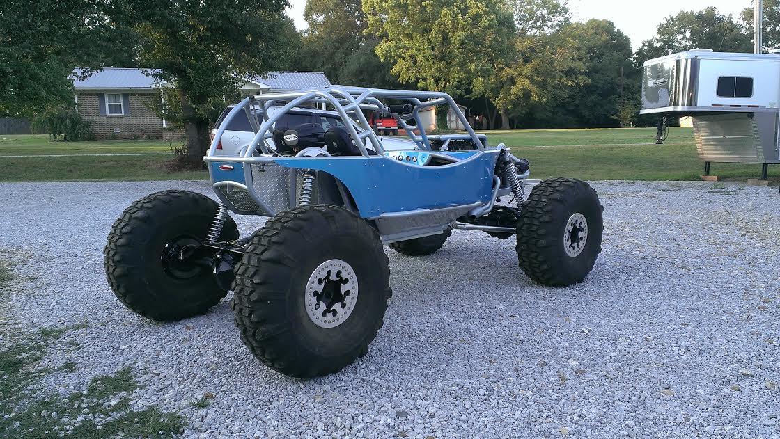

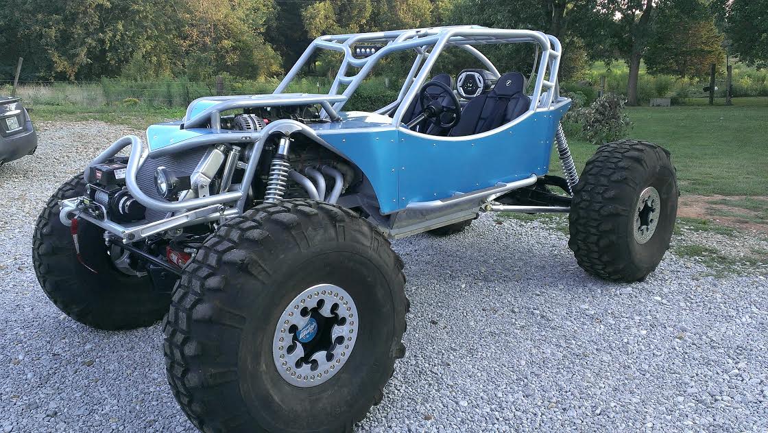

My new buggy named "Home Wrekker"
yourhero
Sep 14, 2008
72
aka Home Wrekker
07 6.0L with small cam
Th350 to a 203/205 Wide Open Design Doubler
D60 spooled 4.56 with Yukon CM shaftsand Superjoints
14Bolt welded 4.56
22In. Belly Height
6' 1" at highest point
and the best part is a Marine amp and two 3" tweets and a Boss 6x9 for tunes
NICE!!!!! hows the doubler working for you? ive got the exact same setup on my buggy, except im running 4.10 with 40'S as of right now. Im not quite done with the build, but wanted to get some input from another rig that has doubler. was that a good choice, or do you think just a single transfer case with lower axle gears would have been better?
JDSharp the Doubler works great for me. The only issue in the buggy is its hard to mount seats and keep everything low. TheViking they are 44 superswamper TSLs.
