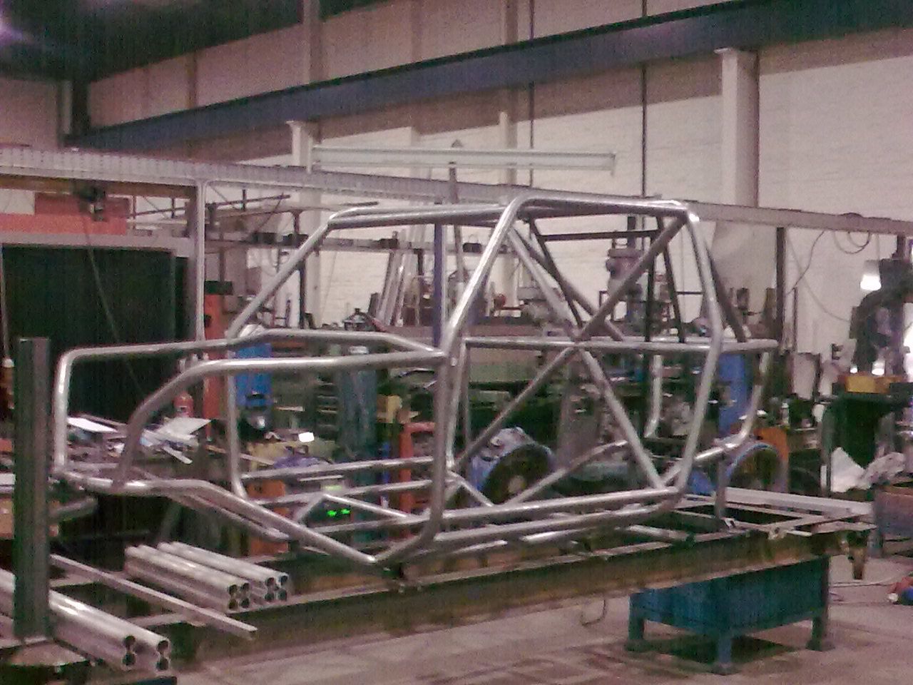

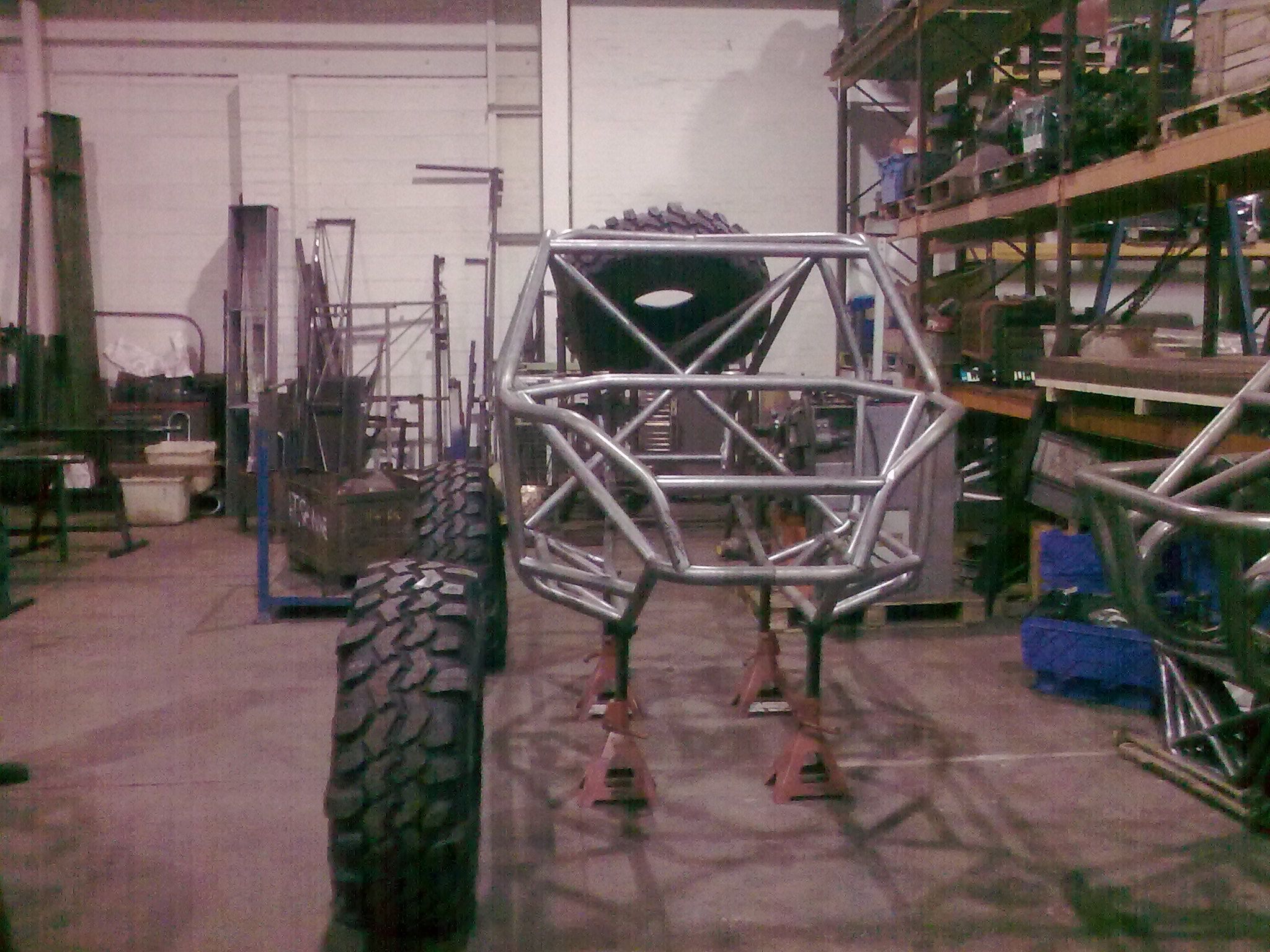

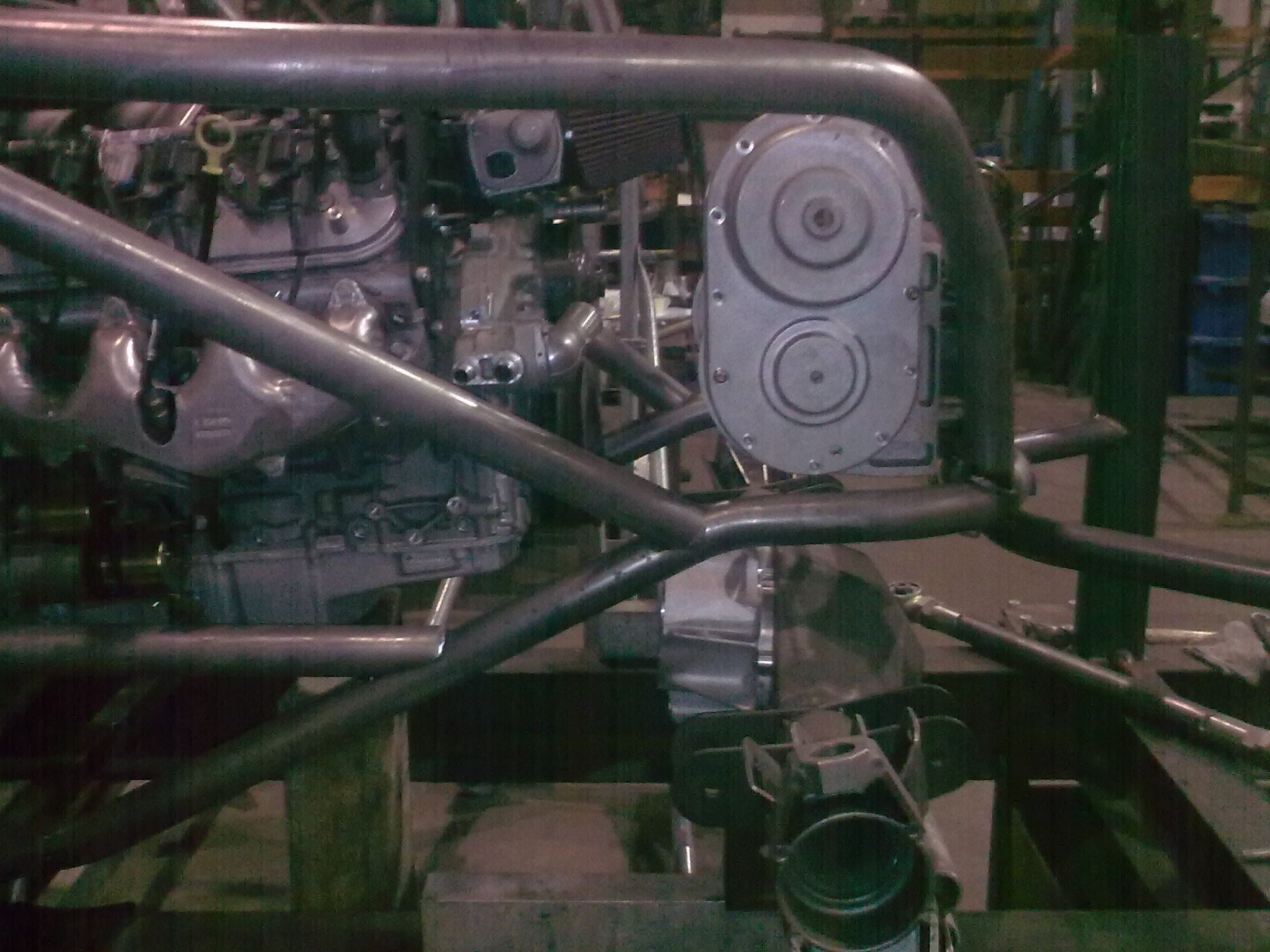

Now the build has progressed quiet nicely and i'm not a fabricator by trade... just a sparky, but i would like you advice on a couple of point as i go through the build photos.
SO... let the chaos commence :flipgotcha:

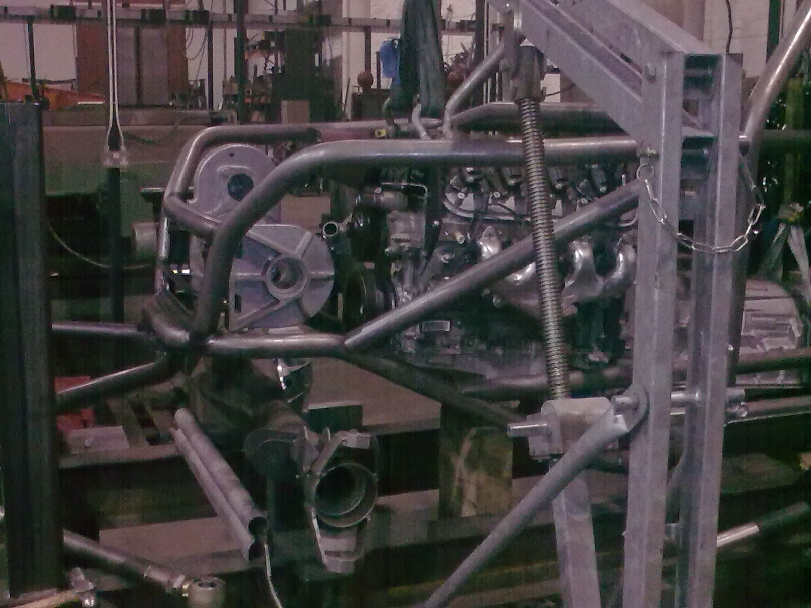

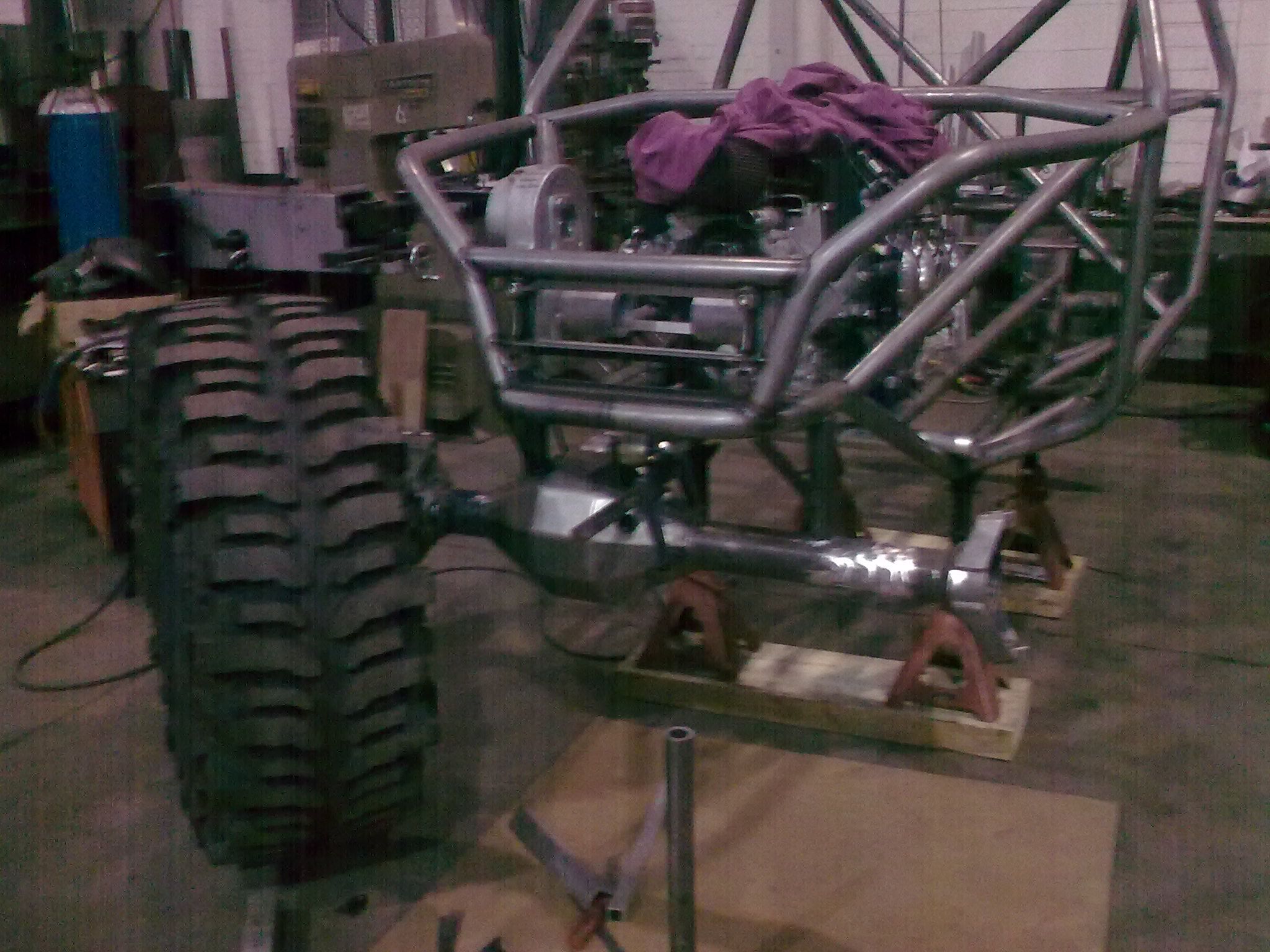

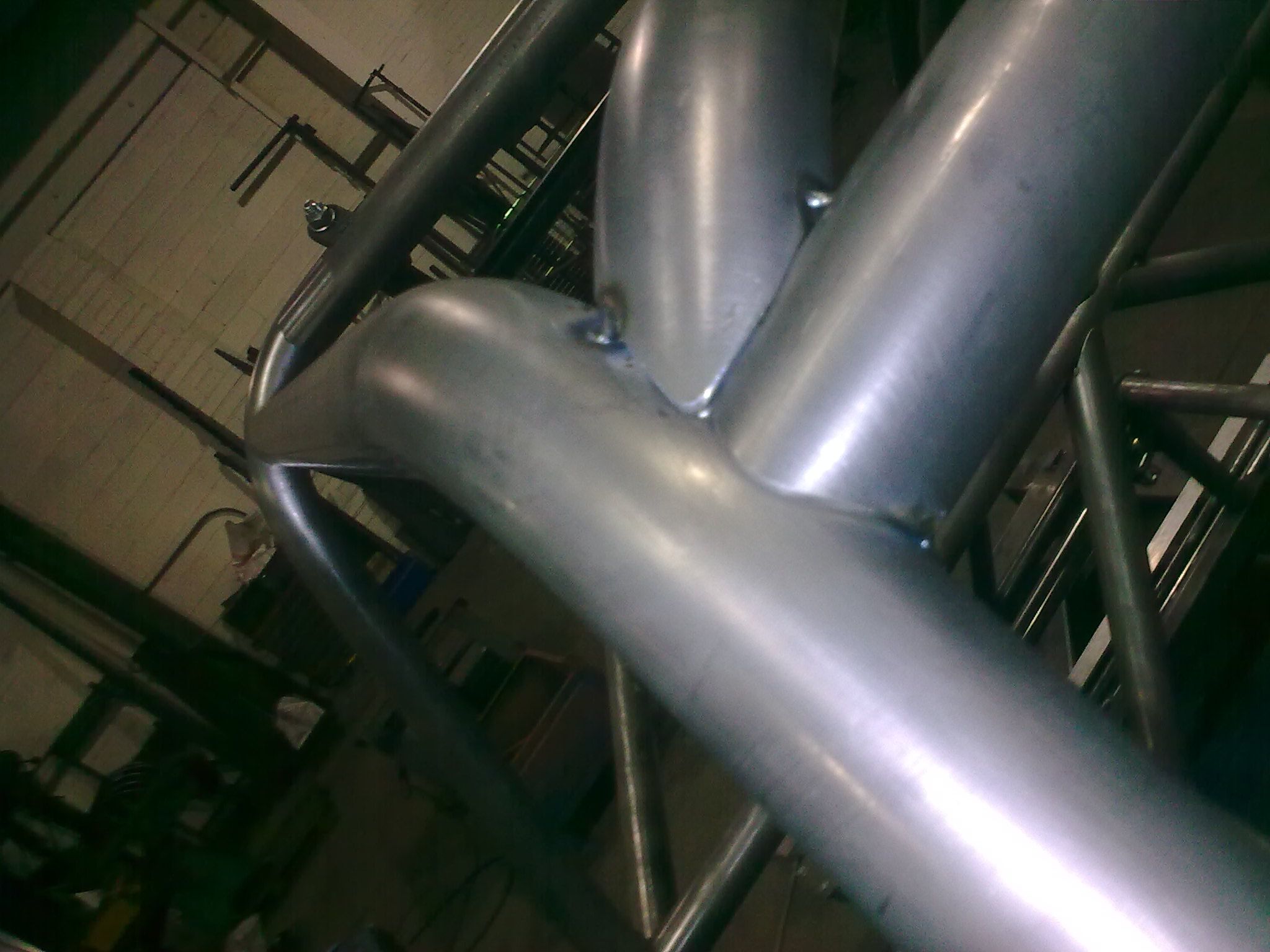

few more later on with the build
thanks for the praise lads... its been a very long journey to get the buggy built without breaking the bank
the tube is 2.5" cds from memory from my local supplier who is also the leading rollcage maker in the uk for MSA spec trucks! wheel base is 112" from memory.

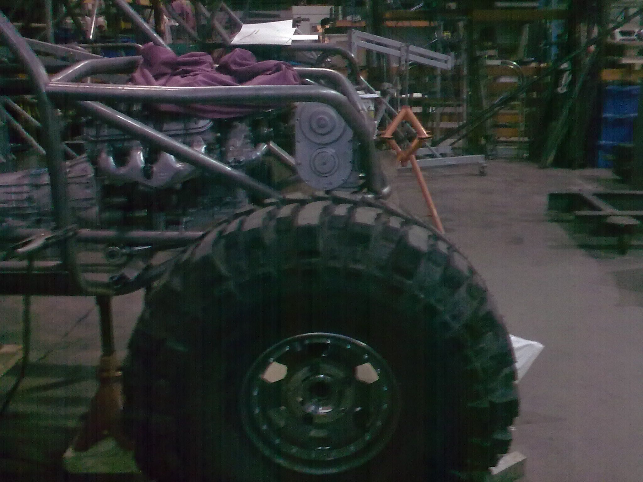

well i think its time for more updated pictures and maybe some portal action too :****:
get the tissues ready

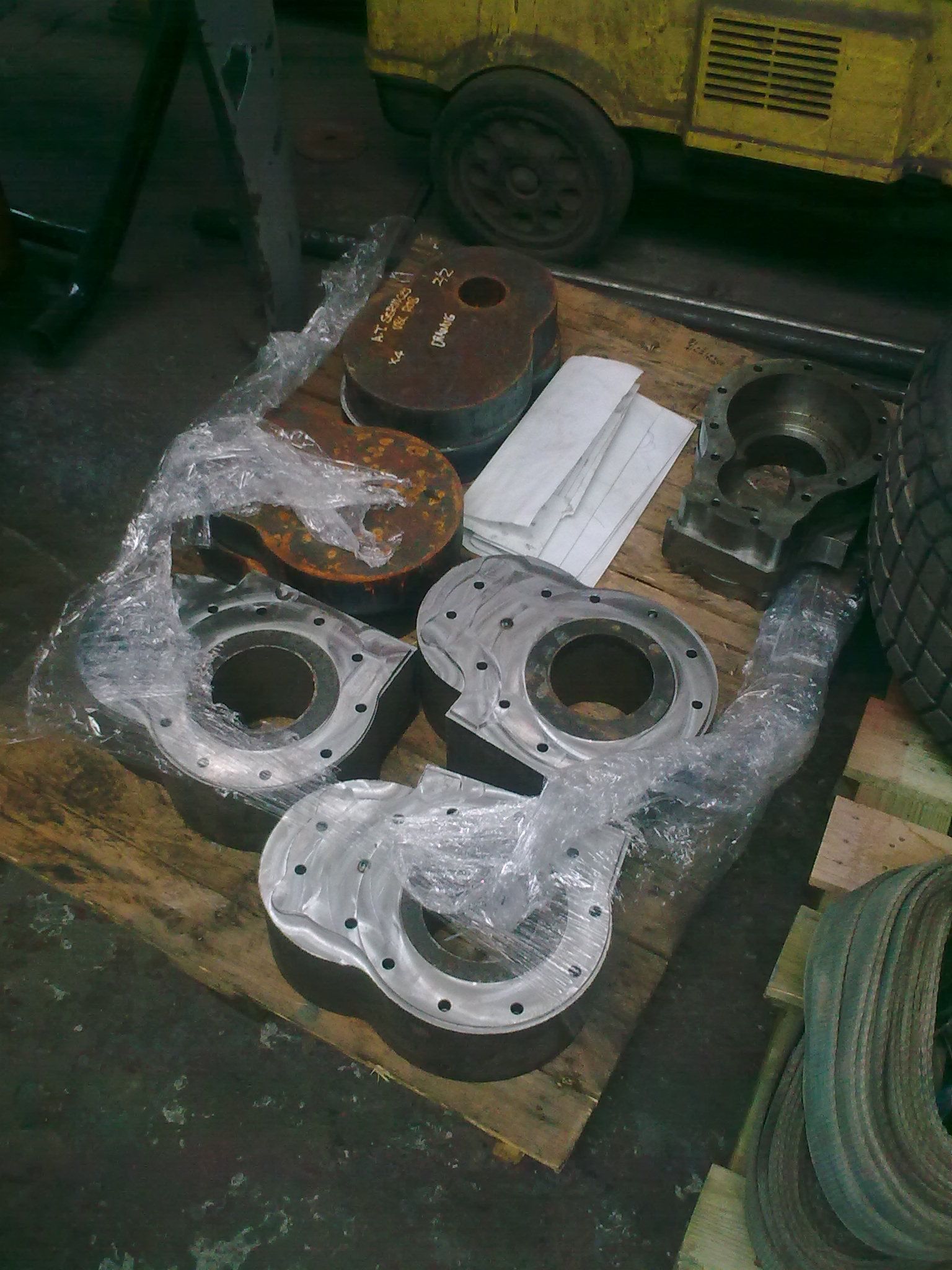

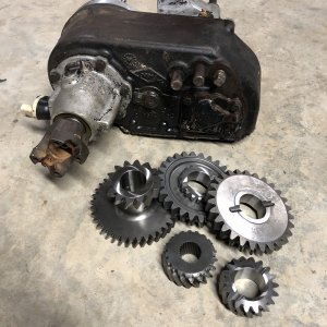

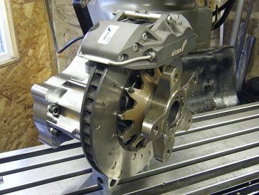

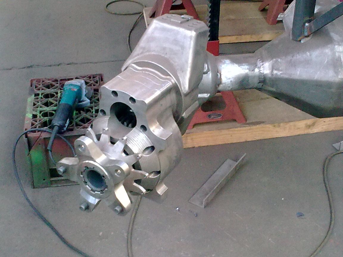

bit of before and after photos :****:.. again, pulling in another favor from a friend with a CNC. thumb.gif
portal on the spidertrax for the first time and with 44's the steering lock. Very cool day :dblthumb:

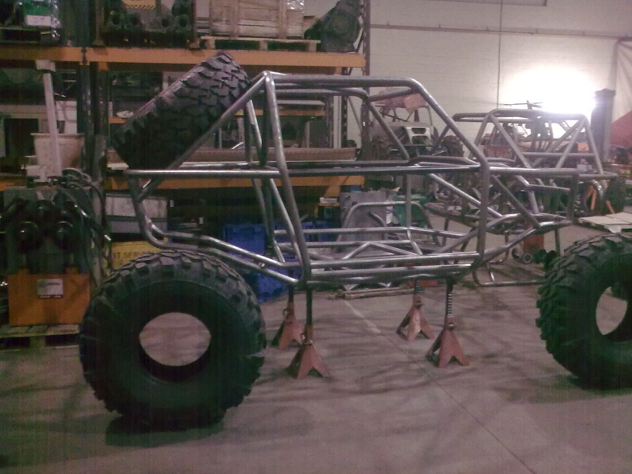

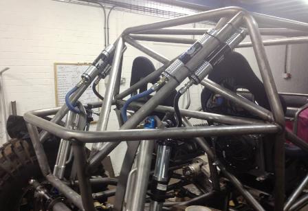

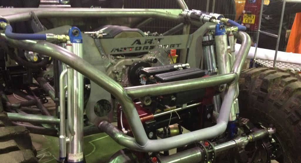

right gents i need your thoughts on how to mount the shocks please.
They are currently mounted on single sheets of laser cut 5mm and then cycled to ensure they clear and use the full travel of the shocks.
I have 1 x 14" triple bypass and 1x 14" 2.5 coilover in each corner and these mounts need to be rock solid.
Do i laser cut another 3 sides for each corner and make box mounts with dimpled gussets to hold both shock in double shear? and then panel them in? or do i tube the mounts and save a little bit of weight?
I need to consider the winches front and rear and i also want to brace the mounts against each other on the back and on the front, brace them across as part of a tube engine cradle?
Any thoughts or ideas would be appreciated.
If you use 3mm sheet in the manner that you mentioned your weight should be about the same as the tube would be. Very nice work on the buggy really like the lines. The axles bits are some sexy parts for sure.
thanks for the advice.... I have a mate coming round this weekend to look at some tube work a sits easier to fit in the tight space i have to mount the shock .
