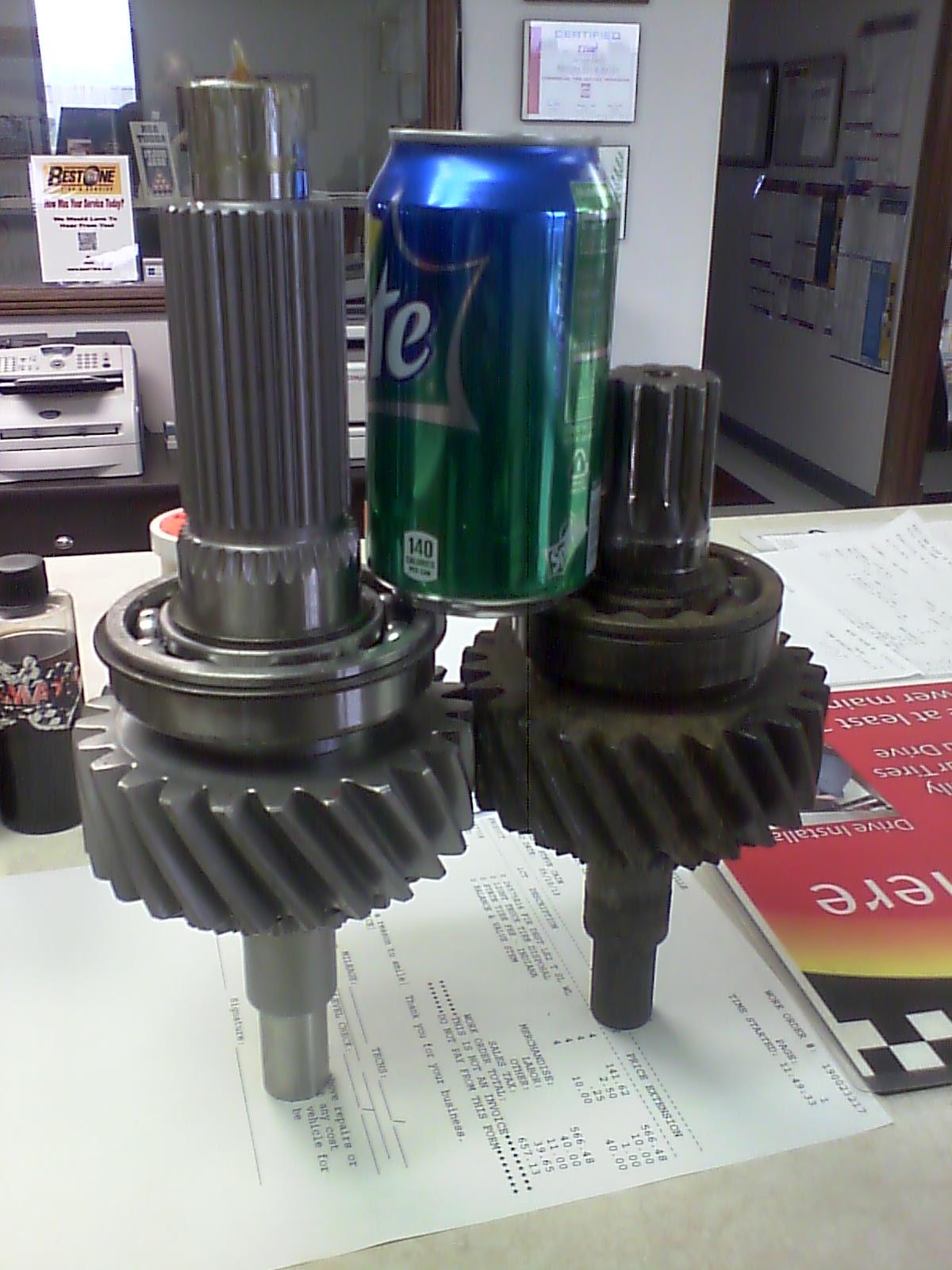

Image of magnum input shaft butted to the reduction input meant to accept the TH400 output

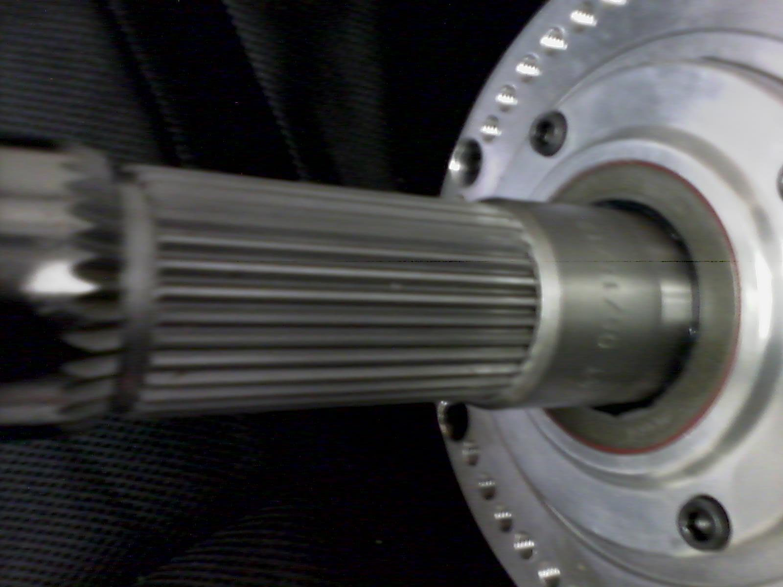

Image of magnum input shaft next to stock 10 spline input (input bearing must be large bore case or have case machined to accept larger bearing)

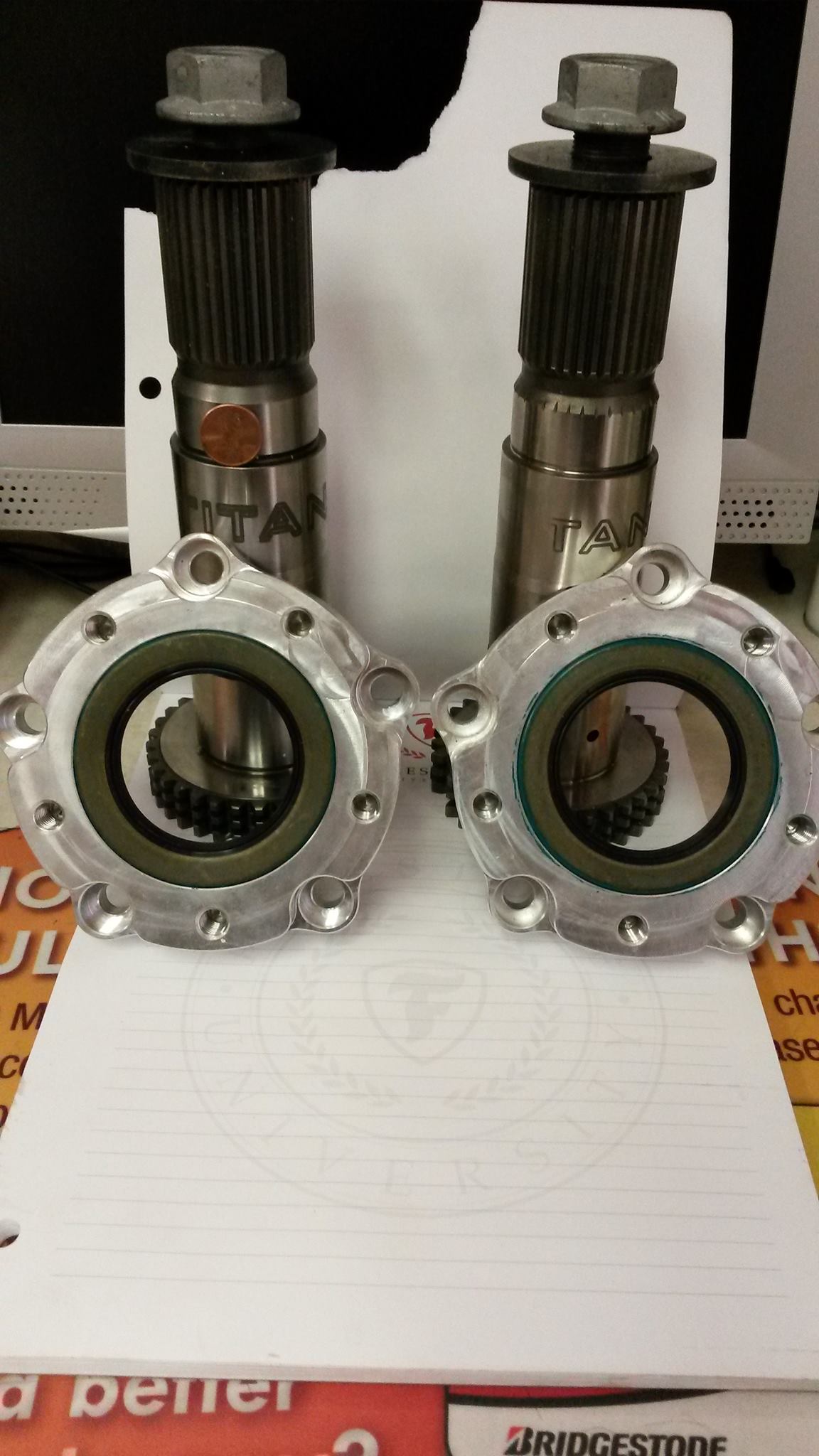

Image of new ***an output shaft and larger bearing retainer (speedo housing must be machined larger)

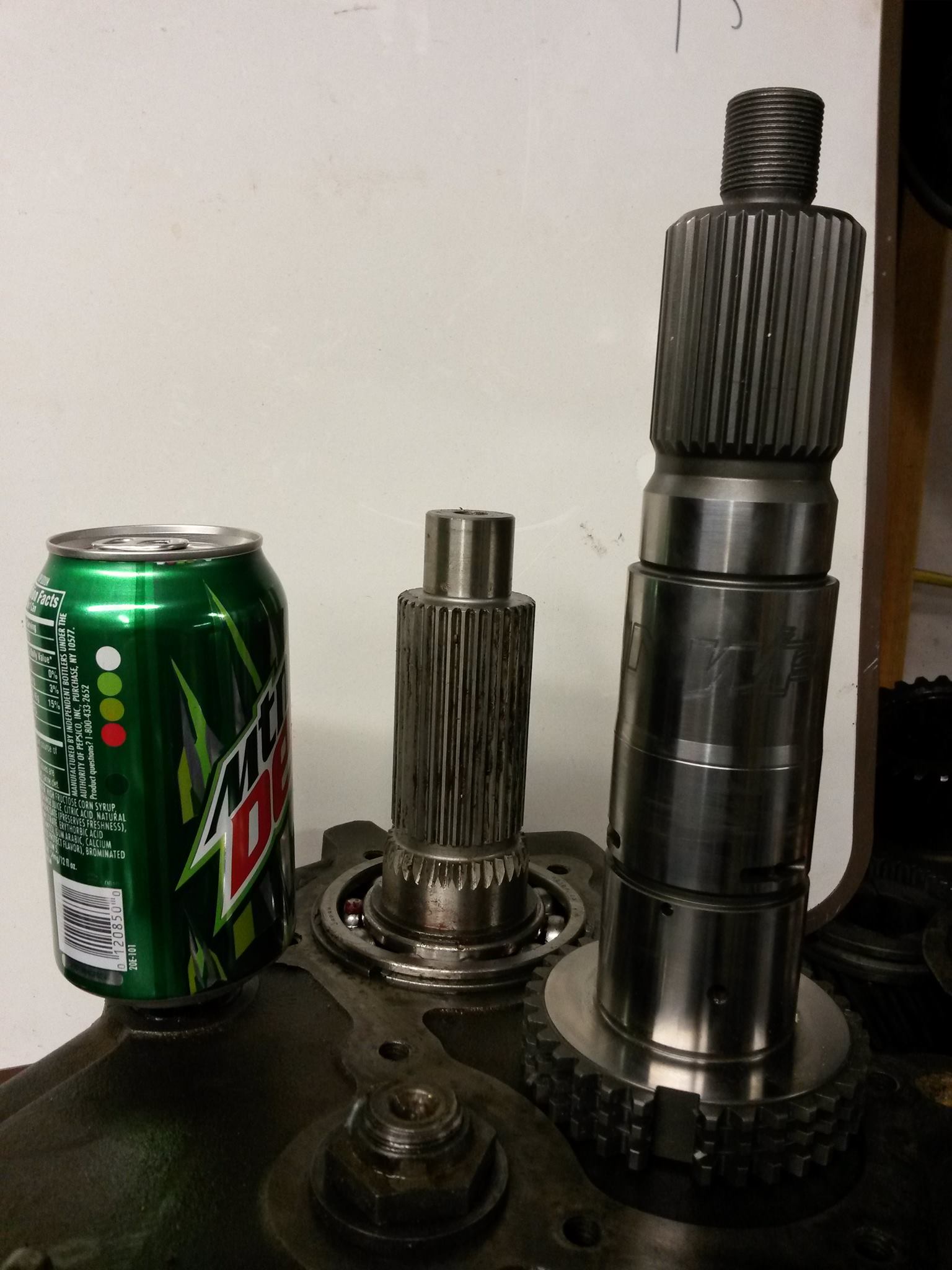

Input installed in case, drink can, and output waiting on some more time to install.
