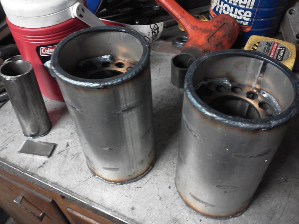

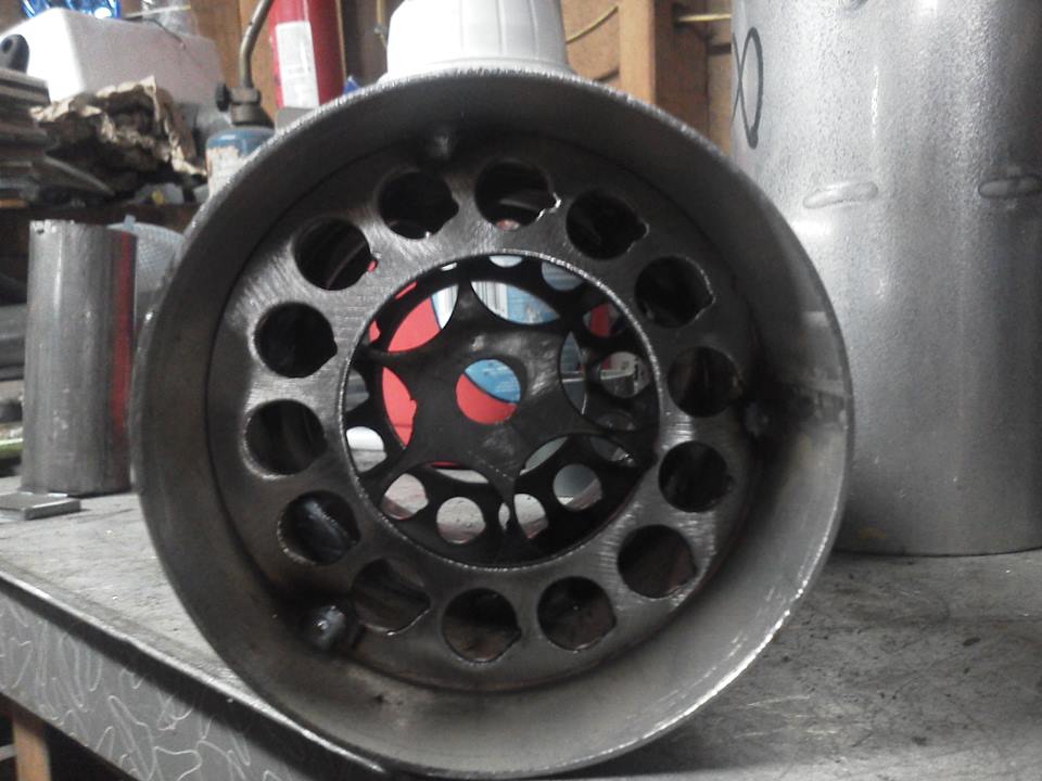

I made these to put on the ends of my 180s. They probably won't do **** for quietning them down but will add some back pressure and kill some of the open header derby car crappy sound.

Thanks for the help. Found some headers that should help get the exhaust to at least dump around the trans instead of straight down like the block huggers. If I can get the pipes routed like that then I will put inserts in the collectors. Thanks for the input this has been one of my biggest concerns on this build and of course I waited till 24 hours before I leave to do anything more then think about it
