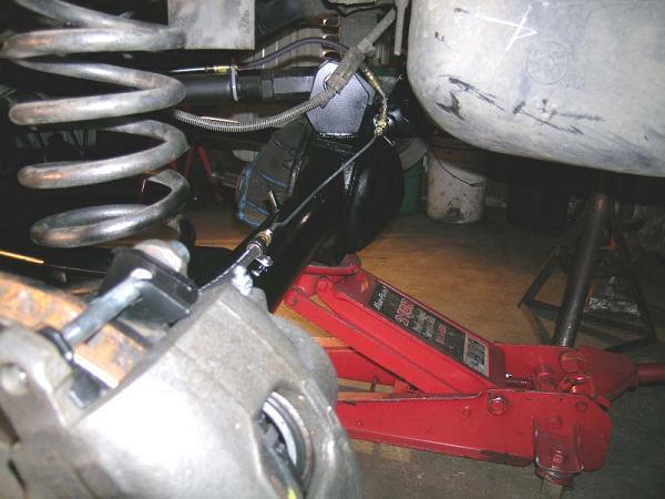

Wilwood was my choice as well. im looking for the rubber brakeline that runs off the caliper to a hardline which routes up to your main brakeline. Heres a pic of what im talking about. where would i find there brakelines.
I think those are generally application-dependant. You could probably just go to NAPA and look through their books to find one that works if you know what you need, like Banjo fitting or flared? How long? fitting size at the axle end?
I just got done putting rear disks on and used Monte Carlo calipers, so I just ordered the lines and banjo bolts to go with them. I had to cut and reflare the hardlines with the right nuts to get everything to match up, but no problems.
do what me and my local buds did. go to your local hydraulic supply shop with the rubber brake line and they can custom make you the lines while you wait. Its about the same price as the ones you buy at a store but this way you can get custom lengths. I prefer this way over a store bought. We even compared the custom ones to some goodridge lines and i think the custom ones were higher quality. Just an idea.
