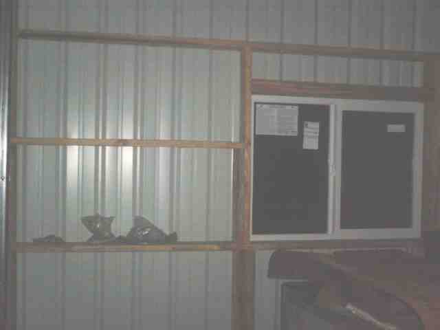

If your going to insulate more than just standard blank they give you, get commercial girders. These Girts run 24" on center (see pictures at link above) and flat between posts similar to a wall on its side. Insulation will fit in-between and sheet rock on top with a few extra boards. If a standard girt is used, it requires almost building new walls inside to run batt insulation.

below is also a shot of what commercial girts look like.
