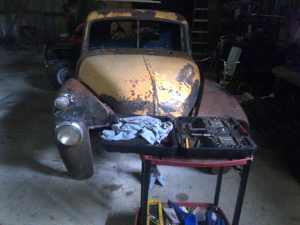

Started with a rust bucket 1951 Chevy, a running big block 1976 Chevy pickup, and a late model bad engine s10 that came off craigslist.
Specs.
51 body, s10 frame lowered and linked. Shortened bed.

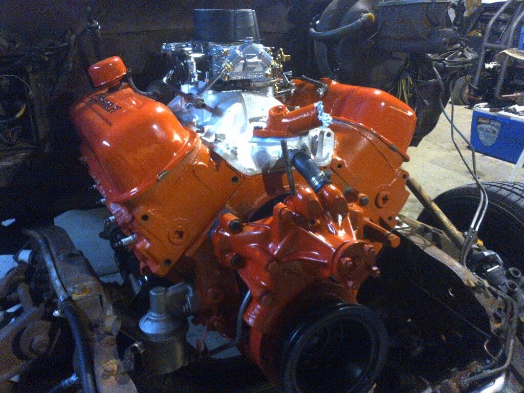

454 with nice heads, cam, intake, and carb

Body was an old walker county board of education service truck that had spent just the right amount of time living in the woods.

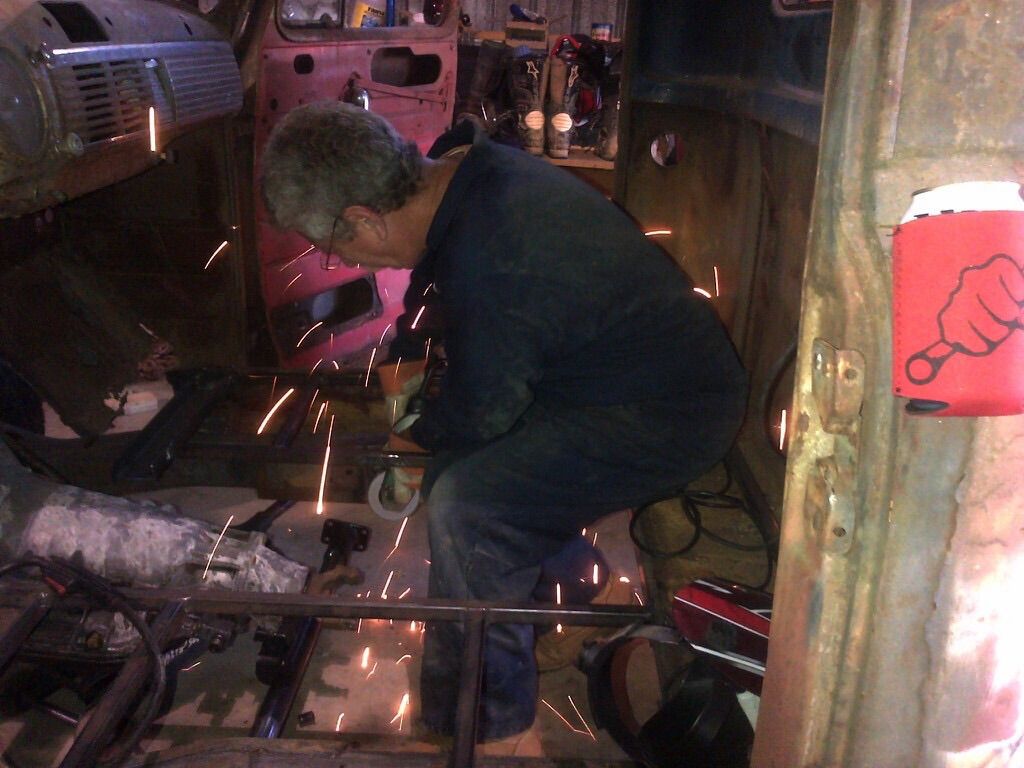

we bought the 76 big block truck off a guy's trailer at the scrap yard, scrap price. S10 came from the hood and was super cheap, and I paid 100 bucks for the '51 tin. Rolling chassis
Floorboard was completely gone, build a subframe out of 1x1 square. Used the factory s10 body mounts and just moved their location on the frame.

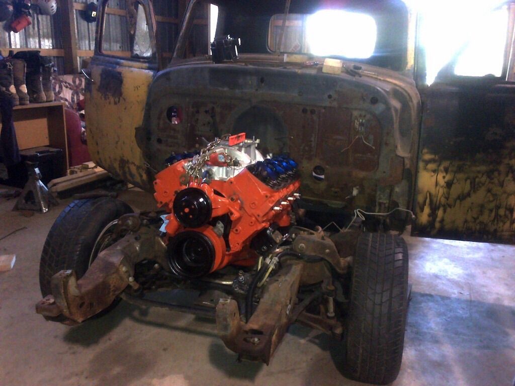

Trying to figure out headers now, tons of frame clearance, steering shaft is the issue .
Leaving the rear leaf springs until it is a driver, then it will be getting an explorer 8.8 swap, links, and coil overs
Dropped spindles in the front.
