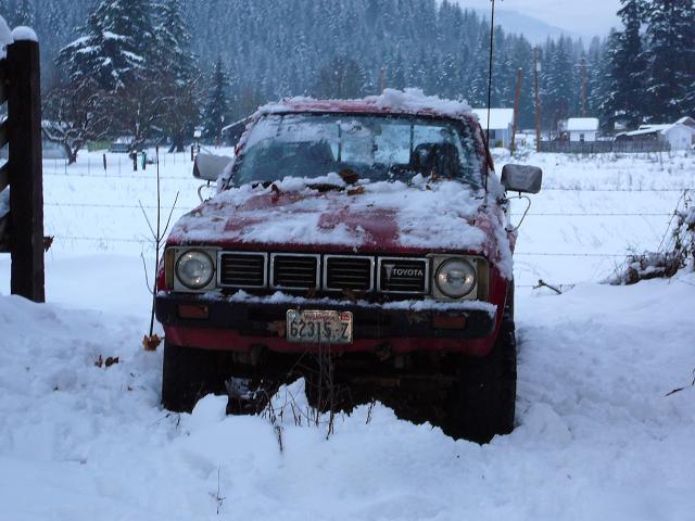

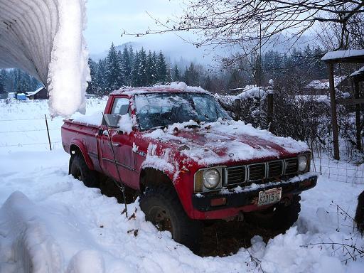

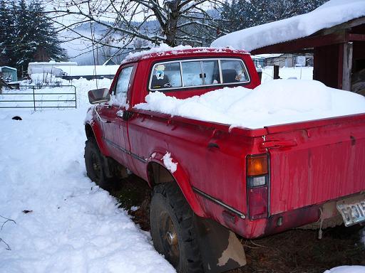

Well it's time to start working on my truck again. It's a 1980 toyota.
Currently sitting on 34" ltb's with 3" springs open front and rear with a dead 22r.
What im going to do to it over the next few weeks.
5.29's front and rear
lockright rear
diffrent motor
36" iroks
crossover
dual cases
I'm not sure what springs i'm going to run so any input on that or anything else would be great. The goal is to have it done and on the trail by the first of the year.

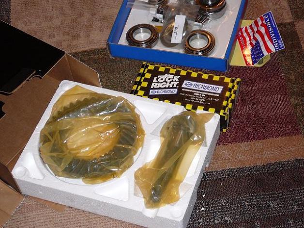

Sounds like the rears and chevys might be a cheap quick way to go. Eventually I would like to link but that wont be for a while. Fedex brought some of my parts. Just need to order hy-steer and some tires.
