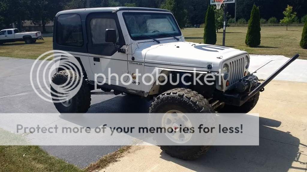

Picked up a TJ that was already LS swapped with a TH400/205 combo. Running a kingpin 60 front with a 14 bolt rear. 16" coilovers in the front that has a long arm 3 link and long armed 3 link in the rear. Was built as a mudder by the previous owner and my plans are to put an LJ tub on it, coilovers in the rear, 4l80e trans, new cage, 2" stretch in the front, 3 in the rear plus the 15" of total stretch to make it an LJ. It will see rocks, some road and sand dunes riding on 40's. I'm no fabricator but for my first custom offroad build I'm doing my best!
The day I bought it:
