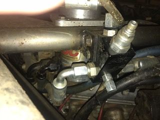

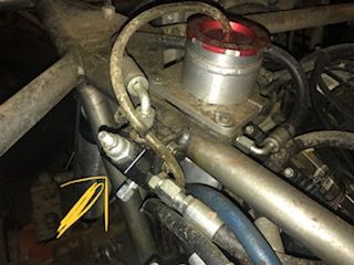

Older orbital (not sure brand, came from a pretty old PSC kit) pics below if anyone knows what this is. I cant remember for the life of me, but I talked to Lance @ PSC before he left and he told me that it was a good load sensing orbital that they used to offer and to keep it as it was better than their current options.

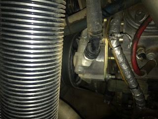

Anyway, this weekend the pump decided to blow out the front seal...it didnt blow it out in a sense that 100% of the fluid came out, but it stopped steering on anything other than flat ground while moving. If you rev it up and turn, the fluid will spray out the front seal. Sitting there, or just idling there and it wont spray out.
I thought it was just a pressure spike from hitting a rock too hard or something...so we went and got a T Bird pump from the parts store (same physical shape and bolt pattern as the CBR), made fittings work, got it bolted all back together as a trail fix..drove it around for about 15 mins and did some light trails behind the shop to test it out...blew the front seal out of that pump too. Same kind of symptoms....wouldnt come out unless revved up and turning; would semi work on flat ground while moving, etc.
