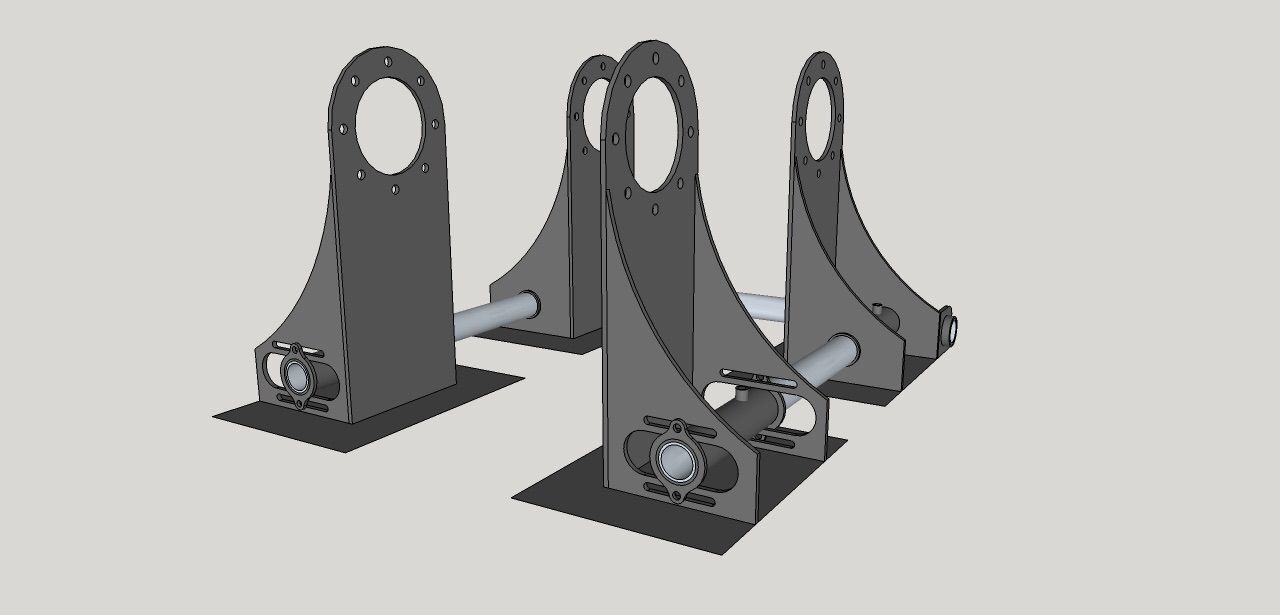

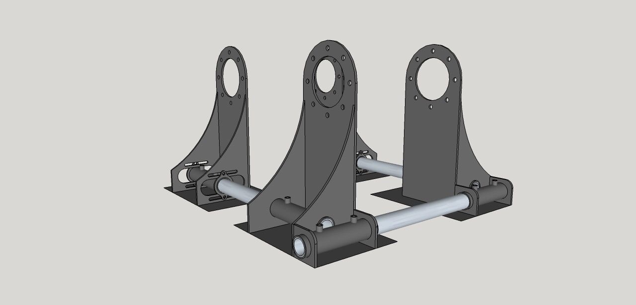

I drew these up as axle stands with the idea of putting them on casters so you could lock the front and rear axle together at the wheelbase you wanted and square it under the buggy but using this same concept could help you realign it
