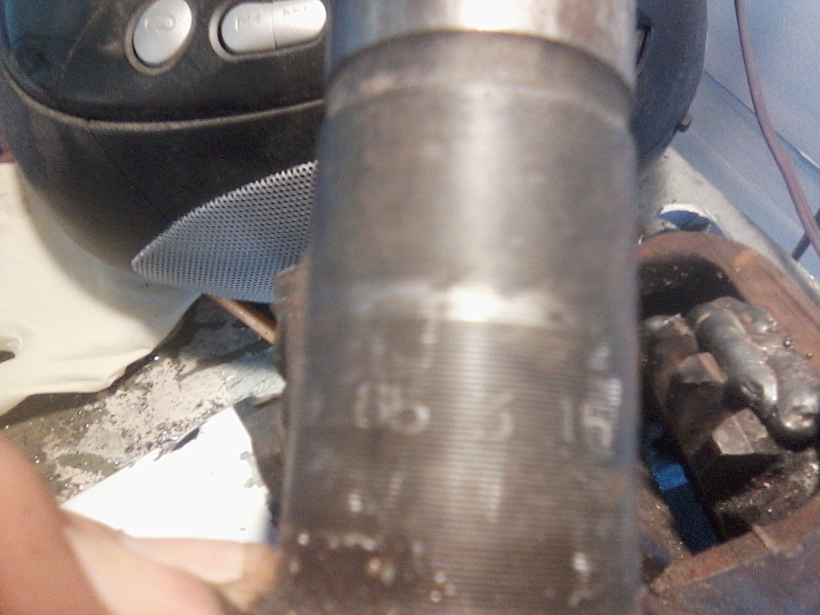

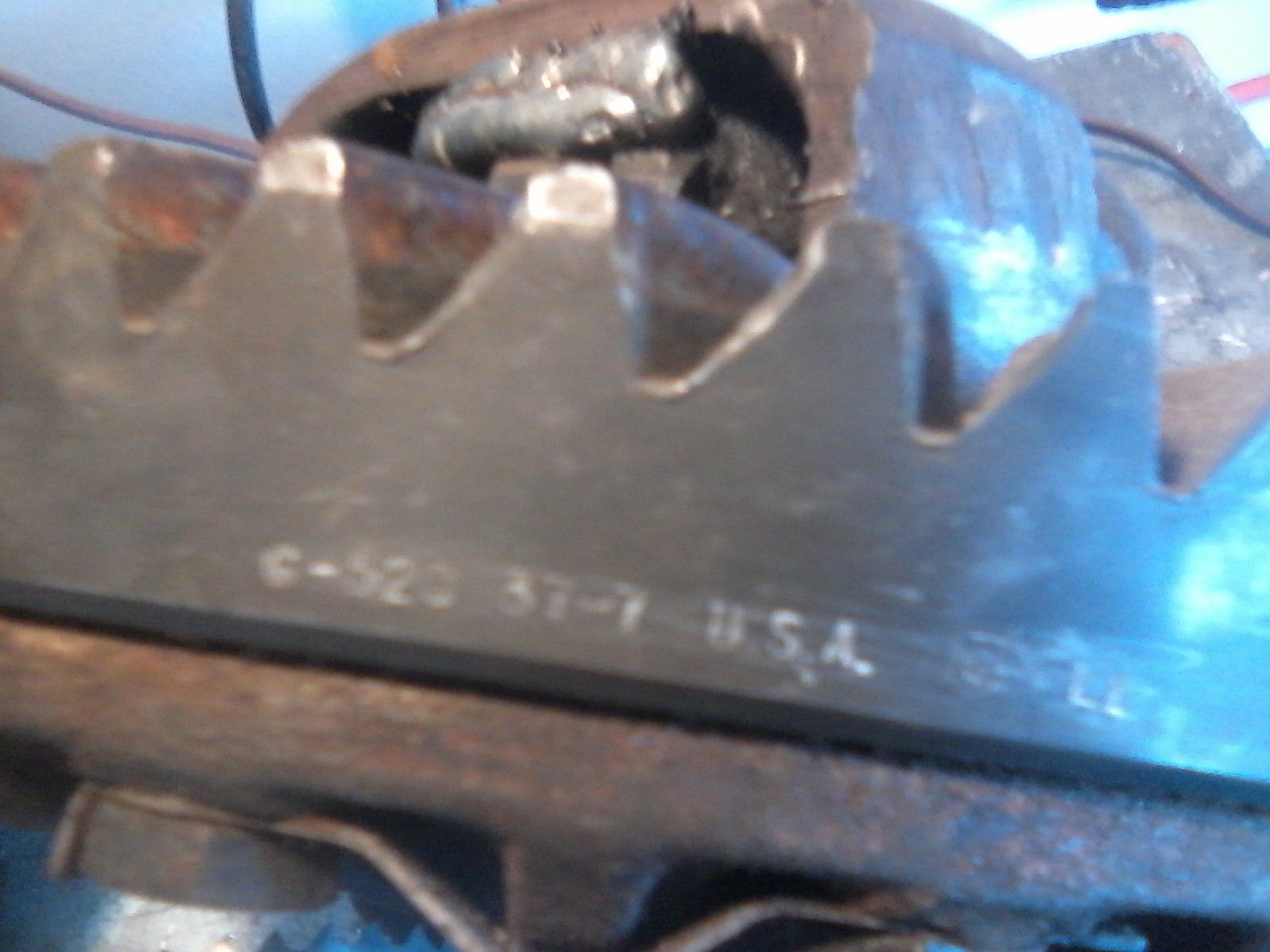

OK so I'm not that good with gears yet had a buddy give me a front third with setup with 529s and another 529 ring gear and a pinion R.G. says 529 37-7 L1 and P.G. says 85 3 15 is this a set for the rear or what I'd like to run em if possible got a pic of each also thanks for any help

I've never personally swapped a ring and pinion out before and didn't know if the made a set for front that is different from the rear r&p or the were all the same. I guess part 2 of my question was how can you tell if its a set I know the third he gave me has a 529 setup in it but the ring and pinion in the pic, that are loose, are they a set or different, and is there away to tell by the numbers on em. Basically how can ya tell if a r&p go together and is there a "front" and "rear" set or it universal as long as its 8inch, yoda, and not high pinion.

I don't know about how to tell if the gears are matched, I'd just assume that they are and install them. If they are used gears they can be hard to get a good pattern anyway. Ring and pinions wear together and become a "matched pair", they don't start out that way.
Unless you are doing a bunch of road driving, then I don't think it will matter even they aren't "matched"
from what i've read there's supposed to be numbers on the ring and pinion that indicate if they belong together.....search on pirate for billavista's diff setup article

Well what I gather from the Bella vista site I have the wrong pinion does any one o e here have a spare 529 pinion theyd sell would buy a new set but strapped for cash right now having to rebuild my knuckles completely my high steer arms won't work with the trunnion eliminator kit I got and still have never got to take it wheeling bout to give up and sell it every time I improve 1 time 3 other things I find are ****ed up

What info did you use to deduce that your pinion was wrong? none of the "markings" on your ring gear give any pertainent info except it's a 5.29 set (37 ring gear teeth, 7 pinion gear teeth). if the pinion has 7 teeth, then I'd set it up.

The info on the site Neal suggested 37-7 means r.g. has 37 teeth and pinion has 7 if I under stand it right had the wife count pinion teeth and there are 15 like the stamp on pinion shaft I could be wrong. And front range high steer arms are 1 piece arms, look in the thread were I'm trying to sell em the trunnion race pin is made into the arm and does press out

No toyota pinion ever has 15 teeth... So unless the pinion you have is not from a Toyota, then yeah, your wife mis-counted...

Its a'15 tooth pinion had her send me a pic last night so its not Toyota and I guess I'm gonna try and modify em to accept the t.b.e kit might go to a machine shop like u said lm limited to regular hand tools power drills & grinders and my crown jewel a miller 185, working on more.Theres a guy at the shop in town that runs a lathe and a mill so I'll have him drill it out for me. But thanks for your help dude I appreciate it I owe ya one
