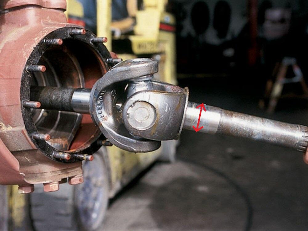

B Bebop Well-Known Member Joined Jan 27, 2013 Messages 2,156 Jan 10, 2022 #1 Could someone in the know confirm if there is a rockwell spindle seal that rides on the outer shaft, here? Like a Dana 60. If such a thing exists, could you give me the part number for said seal ? Thanks

M MidMo Well-Known Member Joined Jan 31, 2019 Messages 88 Jan 10, 2022 #2 No seals, just a spindle bushing which is why a torn boot will water and dirt in and can get all the way to the hub bearings and chew them up. This seal will prevent dirt and water from getting into the hub bearings. https://westerncanadianrockwell.ca/collections/bearings-and-seals/products/hub-seal-outer

M MidMo Well-Known Member Joined Jan 31, 2019 Messages 88 Jan 10, 2022 #3 This is the spindle bushing if you're in need of one those as well. https://www.bigshocks.com/25-and-5-ton-rockwell-parts/25-ton-rockwell/25-ton-spindle-bushing.html
