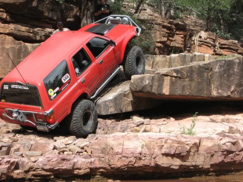

Ive got 155k on mine, ive done oil changed religislouly, and other maintance items buy the book or better. it does have downey headers on it, but other than that its bone stock. so it it dosent leak a drop of oil and seems to run good, and have okay power.
when it does blow, ill definitly be looking at a toy v8 or a 3.4 sawp. would like to keep it all toy running gear.
yeah im a pic whore:D
