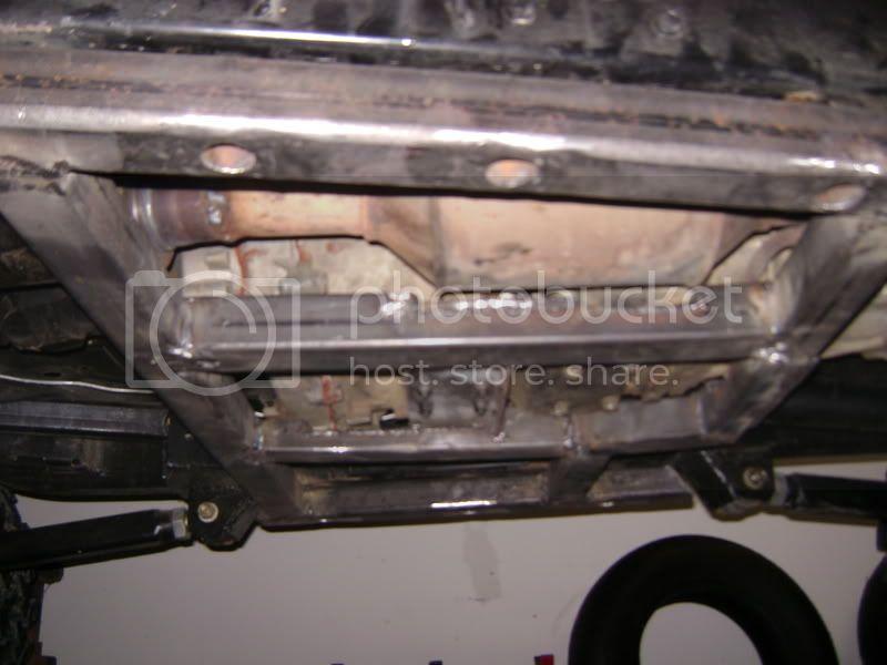

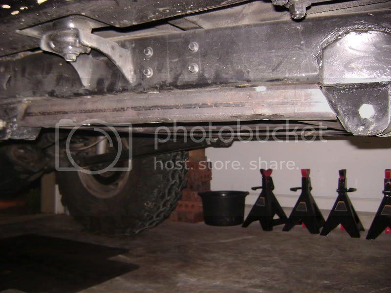

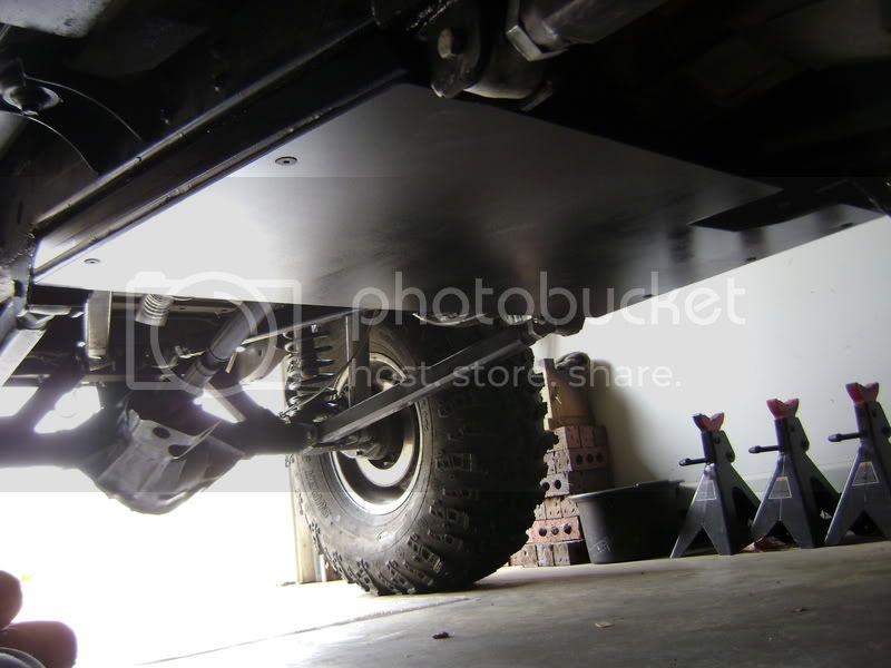

I was trying to make the same decison you are and I ended up going with 1/4" steel. The same size piece of UHMW was about $25 more so it wasn't a big difference but then you would need to skin it too. I did a 1/8" wall square tubing crossmember to hold everything up and then skinned it with the 1/4" tubing. I had enough crossbraces in it that it would have been hard to bend. You might want to look into this also since your lower control arm mounts hang below the frame like mine did and adding the 2x2 tubing for a crossmember between them helps with sliding from control arm to control arm. This also raised my belly up almost 2" from the stock skid. You can see pics in my build thread on pirate.
Here is a couple shots:
Trevor how does that tube crossmember attach? Does it bolt in the stock location or is it welded up? I like the way you did that, any more details or info on how you did it al? I am going to have to replace my rear LCA mounts because they hang me on everything. They are beef, but they cost me too often. Any idea what you had in materials and time in the skid? I am trying to make the make or buy decision.
