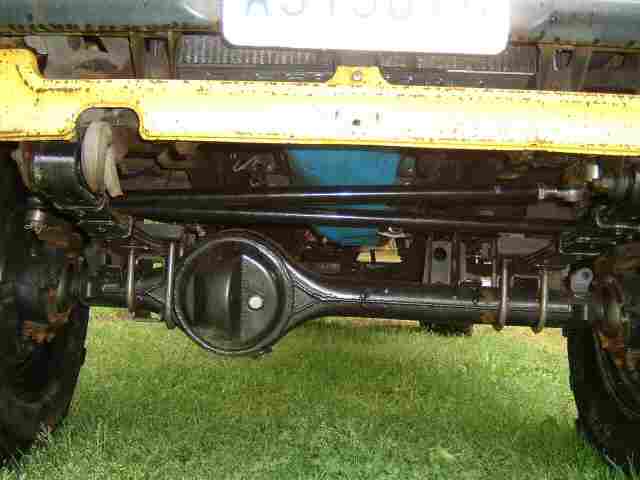

i put hysteer and 3" springs on my truck, mainly for clearing the steering. however i don't have a stabilizer on there right now. i'm not too big of a fan of potholes in the road jerking the wheel out of my hands, so i want to install a stabilizer of some sort. anybody have any suggestions, as it's pretty tight down there.

Weld a small tab to the top of your diff and mount one end of the shock here. Send the other ends towards the driver side knuckle and u bolt the the it to the tie rod. This solution has the highest dampening effect because it will be completely parrallel to the tie rod. :cool:
I got some brackets from Allpro. One set of brackets get welded to the pass frame rail and the other clamps around the steering rod from the gear to the pass knuckle. I can get a pic tomorrow if you want. Its on my 80 Toy with histeer.

i took my old stabilizer from my former steering setup and held it up down there, and that seemed like the most reasonable solution.

Does your Toy have enough room under the oilpan for the stabalizer? Mine didn't, but that was partually due to the mounting bracket that bolts to the tierod. It either mounted the stablizer to low or to high. Might want to get a bracket that allows the end that bolts to the tierod to be even with it. Not above it or below it.
