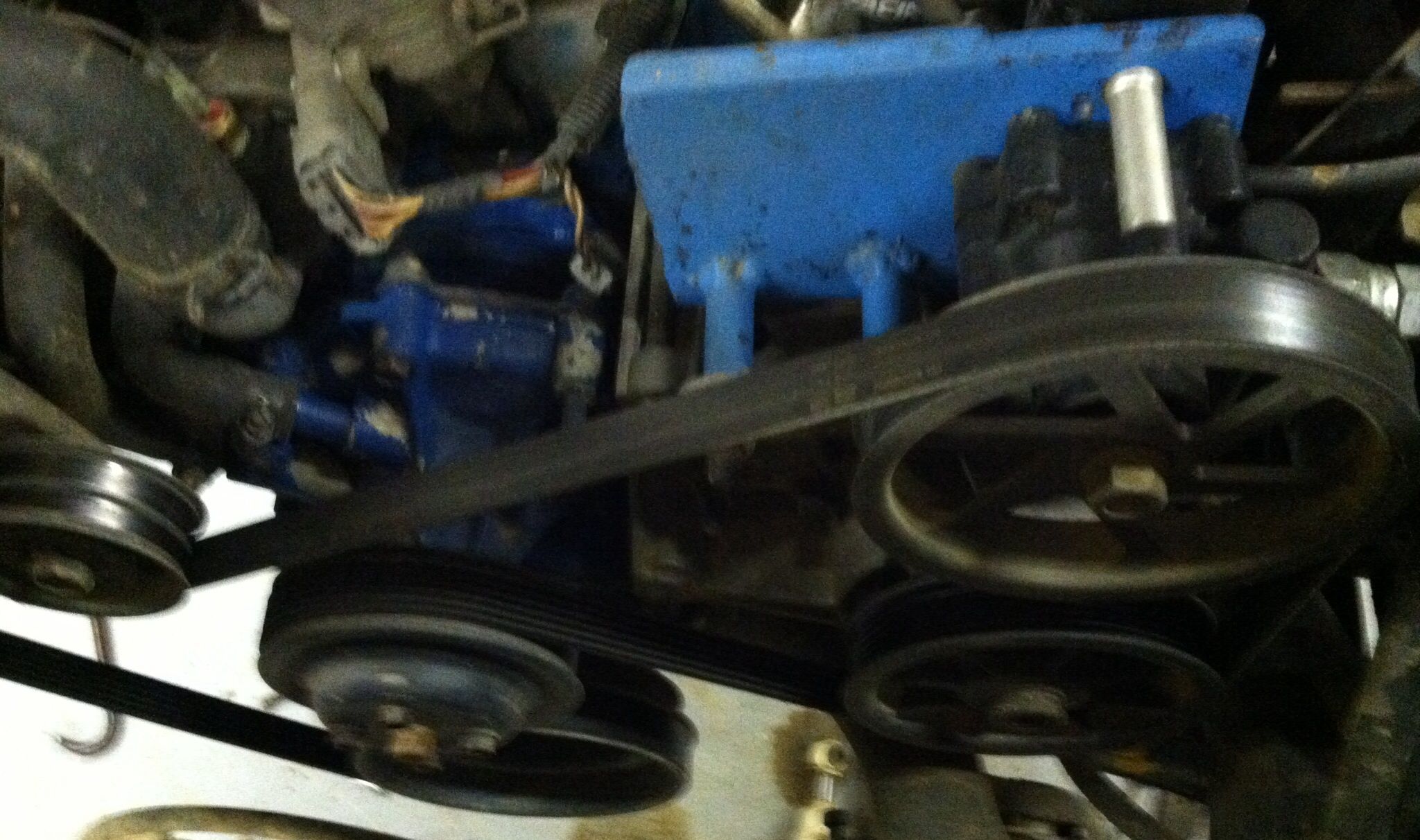

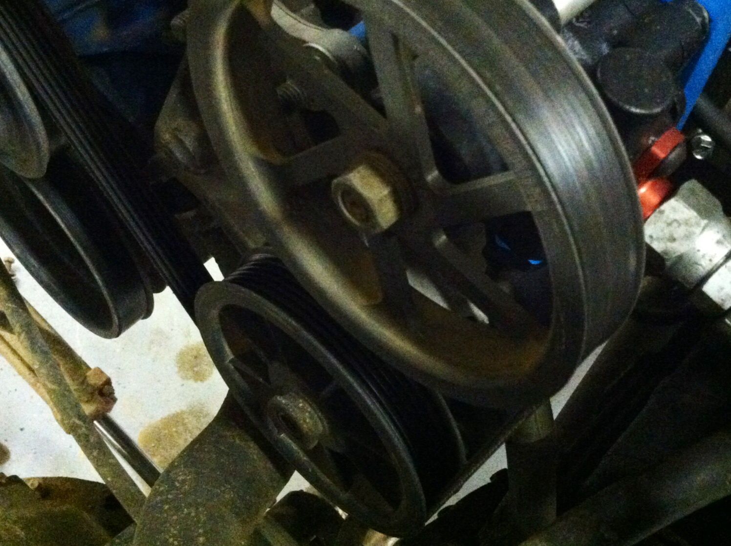

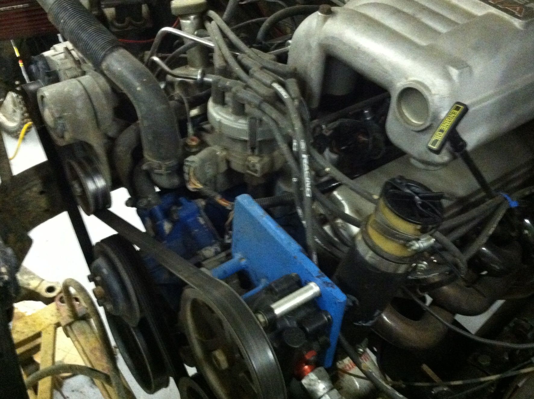

I got a krc for my front and a stock ford for my rear with a serpantine belt works perfect

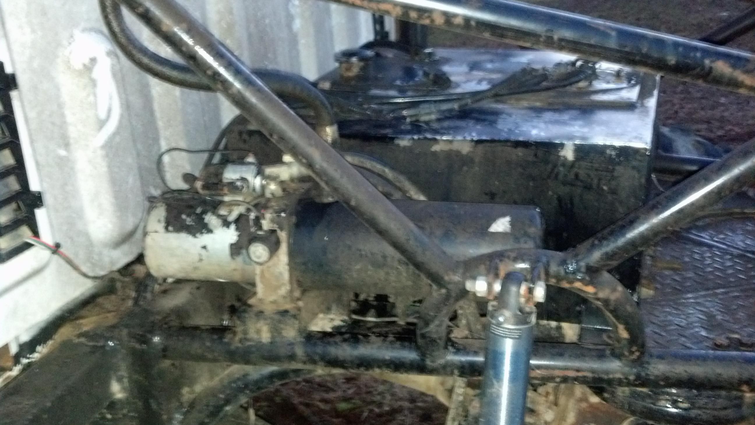

Don't really know much about these myself it was on the truggy when I got it and it didn't work worth a damn so I got a solenoid for it and it's good to go now. I was told it was a dump bed pump
Is there any numbers on it? Just watched a Jordan tanner rear steer donut video and I'm not even going to mess with a non steer axle now.
There was numbers on it but some jack leg painted over them and when I tried to recover the numbers they rubbed off. And yes the rear steer doughnuts are something else although I have went so fast before I almost rolled over :****:

This is the pump that I have used for a few years. With a 3" X 9" double ended cylinder, it's plenty strong but a little slow. If I had to do it over, I would run another mechanical pump dedicated to rear steer. The pressure is sufficient but the volume flow rate is what makes it a poor choice for quick steering (especially with a 3" cylinder). The spec sheet reads 1.4 gpm @ 1600 psi. I would say a volume flow rate closer to 3 gpm would be more desirable for a 2 - 2.5" cylinder.
