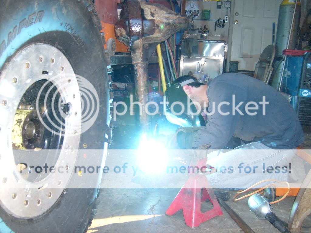

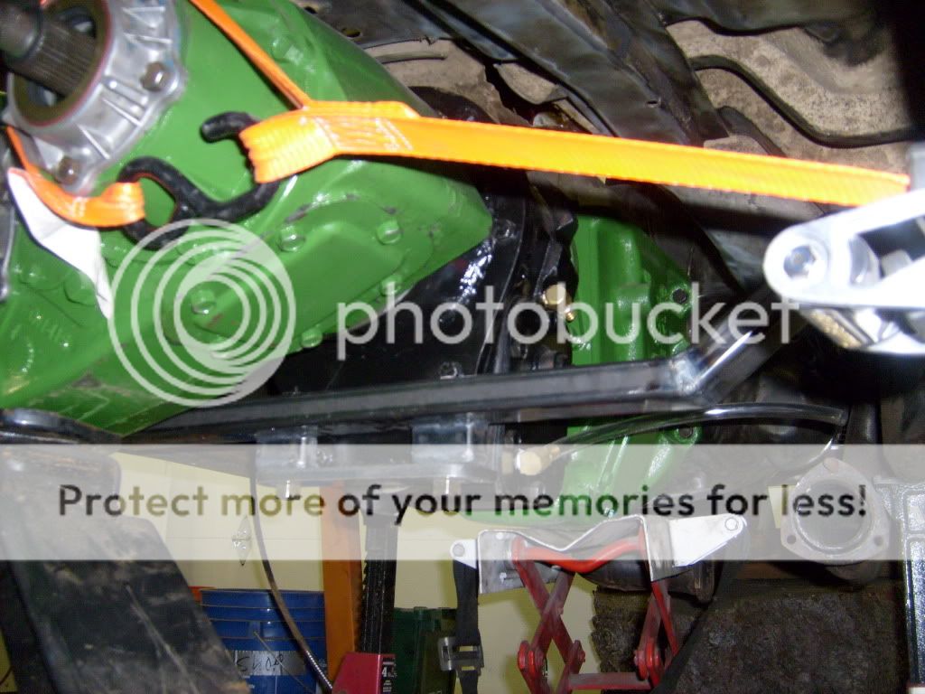

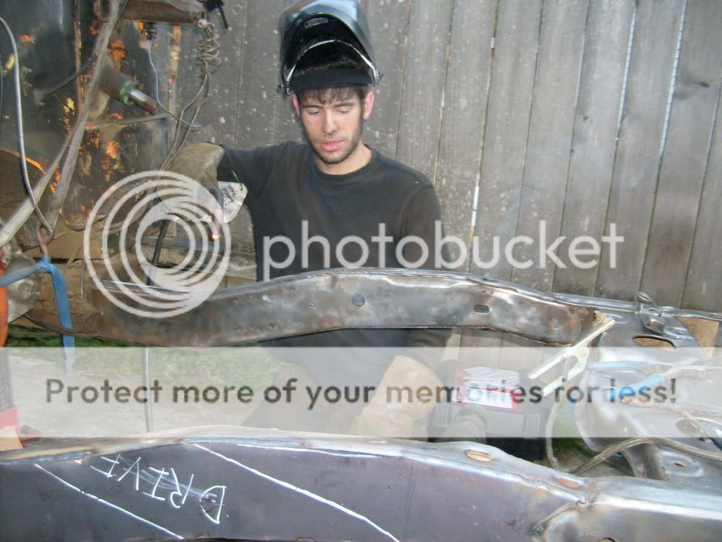

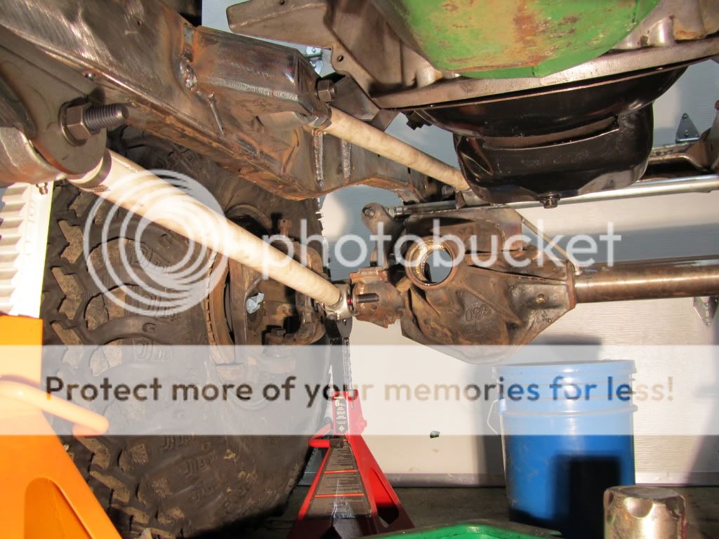

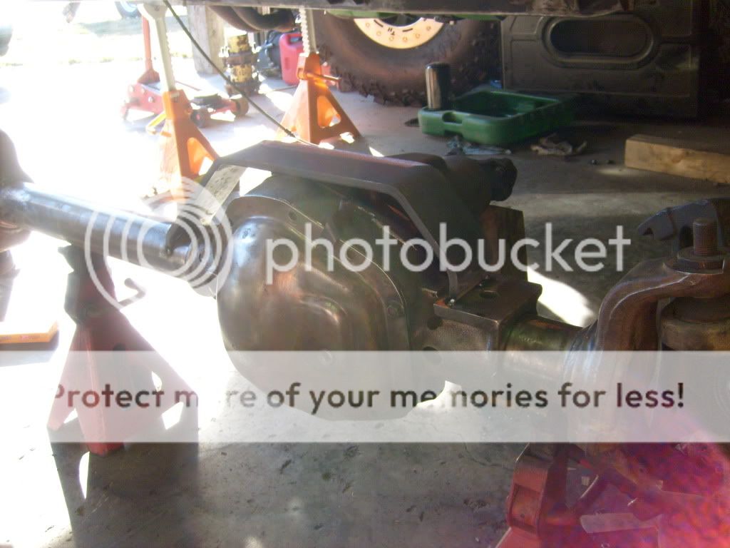

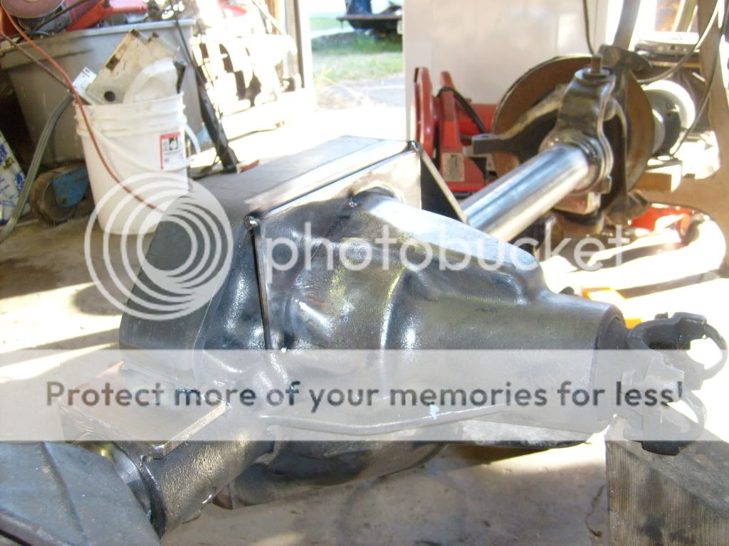

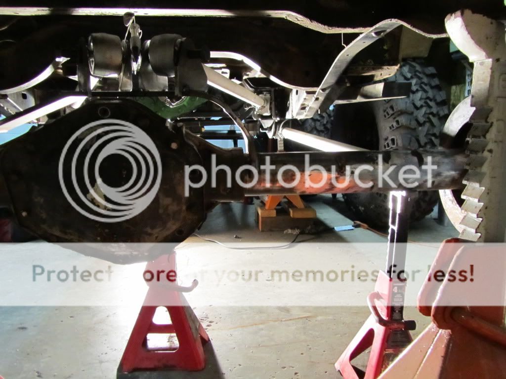

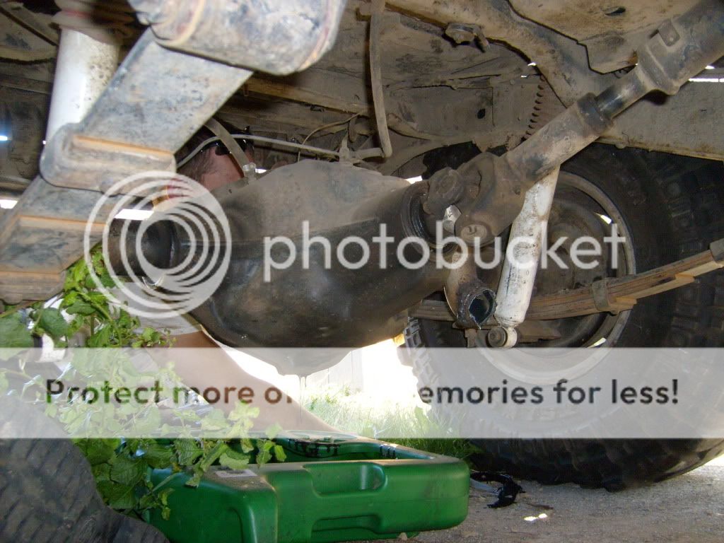

<blockquote data-quote="Stokes" data-source="post: 1426246" data-attributes="member: 16131"><p>eh! i have been lazy with the update pics. heres some i have upload, plus i have pleanty to pull off the camera haha.</p><p></p><p>covered the hurdle of welding up my truss to the cast iron diff, pre heated with a burner unit off of a natural gas water heater running on propane :laughing: haha it was good we stuck a old pane regulator on it and brazed the flame port shut so we could drill it smaller. worked good! all the pictures are on my friends camera so ill need to hunt them down. found it really hard to keep the heat up (600degrees) had my buddy drew fallowing right behind me while i welded with the rose budd to keep it up to temp. my buddy at centeral welding gave me two or three pounds of Nickle tig rod for free :grinpimp:</p><p><img src="http://i806.photobucket.com/albums/yy350/StokesFab/2-28-11024.jpg" alt="" class="fr-fic fr-dii fr-draggable " style="" /></p><p>to ensure that the truss goes no where i tapped two 5/8s bolts into the diff and welded the heads in. haha just to make sure things stay put</p><p><img src="http://i806.photobucket.com/albums/yy350/StokesFab/2-28-11025.jpg" alt="" class="fr-fic fr-dii fr-draggable " style="" /></p><p>track bar bracket</p><p><img src="http://i806.photobucket.com/albums/yy350/StokesFab/2-28-11028.jpg" alt="" class="fr-fic fr-dii fr-draggable " style="" /></p><p><img src="http://i806.photobucket.com/albums/yy350/StokesFab/2-28-11027.jpg" alt="" class="fr-fic fr-dii fr-draggable " style="" /></p><p>added more bracing to the truss for a stronger touch, plus the start of mocking up my unbalanced ram. full hydro is so cool:smokin:</p><p><img src="http://i806.photobucket.com/albums/yy350/StokesFab/2-28-11043.jpg" alt="" class="fr-fic fr-dii fr-draggable " style="" /></p></blockquote><p></p>
[QUOTE="Stokes, post: 1426246, member: 16131"] eh! i have been lazy with the update pics. heres some i have upload, plus i have pleanty to pull off the camera haha. covered the hurdle of welding up my truss to the cast iron diff, pre heated with a burner unit off of a natural gas water heater running on propane :laughing: haha it was good we stuck a old pane regulator on it and brazed the flame port shut so we could drill it smaller. worked good! all the pictures are on my friends camera so ill need to hunt them down. found it really hard to keep the heat up (600degrees) had my buddy drew fallowing right behind me while i welded with the rose budd to keep it up to temp. my buddy at centeral welding gave me two or three pounds of Nickle tig rod for free :grinpimp: [IMG]http://i806.photobucket.com/albums/yy350/StokesFab/2-28-11024.jpg[/IMG] to ensure that the truss goes no where i tapped two 5/8s bolts into the diff and welded the heads in. haha just to make sure things stay put [IMG]http://i806.photobucket.com/albums/yy350/StokesFab/2-28-11025.jpg[/IMG] track bar bracket [IMG]http://i806.photobucket.com/albums/yy350/StokesFab/2-28-11028.jpg[/IMG] [IMG]http://i806.photobucket.com/albums/yy350/StokesFab/2-28-11027.jpg[/IMG] added more bracing to the truss for a stronger touch, plus the start of mocking up my unbalanced ram. full hydro is so cool:smokin: [IMG]http://i806.photobucket.com/albums/yy350/StokesFab/2-28-11043.jpg[/IMG] [/QUOTE]
