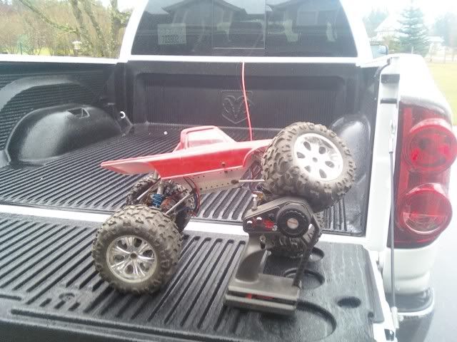

does anyone run 2.2 wheels and tires on clod axles? when I redo the links I want to shorten the wheelbase a few inches and run a tall 2.2 tire with beadlocks. I need to order my link mounts for the lowers for clod axles since mine are too low right now. my rear suspension is definitely set up wrong. here is a better picture of the issue. after running it with the big moabs on a nice rockpile, the big tires are more a pain than fun so I want to try something much narrower and shorter. hopefully it wont be too rough on ground clearance. I saw somewhere that they make a 7in tall 2.4in tire too. i might need those.

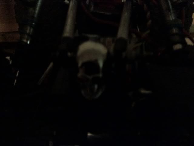

ok I just did some major tweeking on the rear suspension. First I raised the upper link mount in the rear with a skull cap.Then I straightened the rear lower links and raised them to the top of the rear knuckles so the rear suspension is designed like the pic above. once it stops raining I can test it better but in the garage it did alot better. here are some crappy pics. I also resoldered the motor leads were they join together for the controller. I nstalled a deans connector with single leads and soldered the 3 leads together and insulated them with shrink tube.I havent had a chance to clean up the wiring hanging everywhere yet with some zipties. I know I am selling it, but I wanted to make it the best it can be before I sell it. BTW in the last pic the suspension is sitting higher than ride height so the links look parallel but they arent. In fact most of these pics have alot of deceptive angles to them.

thanks for the pics. that helps alot. I havent touched the rig in a while since I bought an ax-10. I will be making new links soon and it does perform much better since I moved the lower links to the top of the inner c knuckle. I do see though how I need to lengthen the uppers and move them lower in the chassis.
