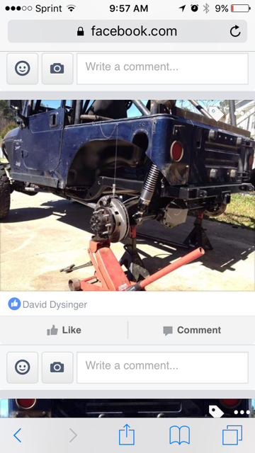

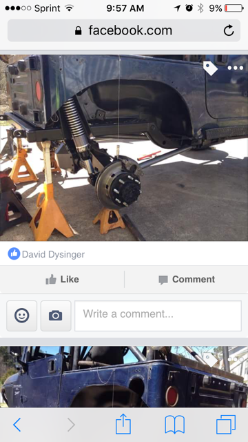

The angle of the shock / strut / pool noodle is probably the result of using a 14" travel shock and low ride height WITHOUT cutting the rear inner fender. It keeps the inside sealed for the rear passengers. I went through this on my Jeep. If I had not angled the shock and made the lower mount behind the axle I would had to cut the tub and add tube for an upper mount.
Buddy of mine had a newer jeep what ever letters they are, but it had a bolt on coil over kit mounted just like that. Must be a jeep think.
Look at a RZR front. Like said earlier goes against everything I thought about mounting shocks.

Very common on TJ's and JK's. Is it the ideal mount for performance? No. Does it make a huge difference in how it works? No. Does it fit big ass shocks under the tub with out cutting it allowing you to keep the rear seat, factory fuel tank, not have holes in your tub, not have a bunch of tubes inside? Yes.
