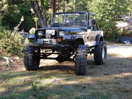

Well it has a Procomp 4" spring lift, spring over.
You can see the trackbar in the pic. It is not attached, nor do I have shocks, this thing rides better than it did when I had just the 4" lift.
Rear you can usually get rid of. I would strongly reccomend an antiwrap setup though.
Front you really need it to keep the axle centered as you steer. Especially with taller tires and suspension. Not a hard thing to build at all.
