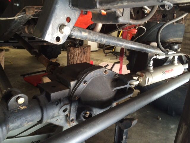

Stretching the front end my rig out 4 more inches. I have done some research, wanted to get yawls opinion and not pirates .. Now that the front is farther out, I have to do one of two things.. Either cut bracket off a frame and move it forward in front of the axle a little bit like it is now OR put a bend in the trackbar.. Or does it even make a difference? Thanks for any advise fellas. Soon as I get your input I will get to it!! Thanks again! Not Sure if this helps but This picture shows the current location, of course before I moved the axle up it just missed the diff perfectly..

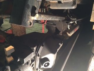

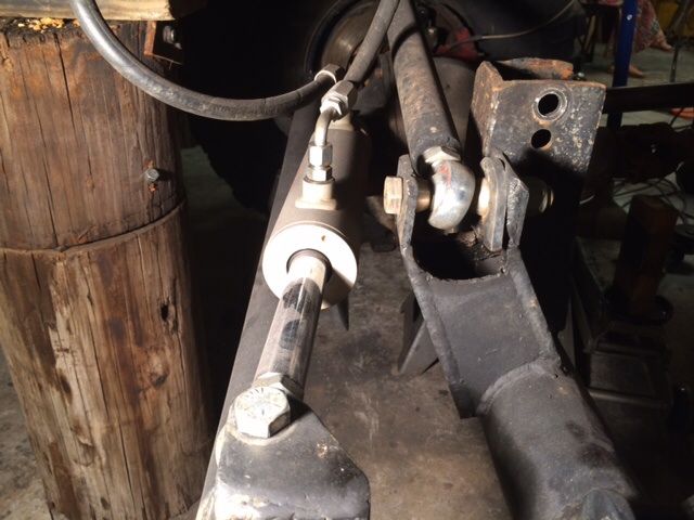

These pictures are after moving the axle forward 3 inches or so. Before, the track bar bracket was a little in front of the axle and it seemed to work good. , at full bump the track bar just barely missed the front the diff cove.. Now it will be right on top of the pumpkin,(where I would think would be the best location) I could be wrong( happens Alot) but I would think you would want it as parallel and over top of the axle as possible. The bracket on the frame would be easiest to move for sure. I just did not know if the bracket being in front of the axle hindered performance worse then bending the track bar or if it even mattered. I figured a bend would be okay as long as it wasn't too crazy.. Here's some pics.. Haven't moved the bracket yet..
