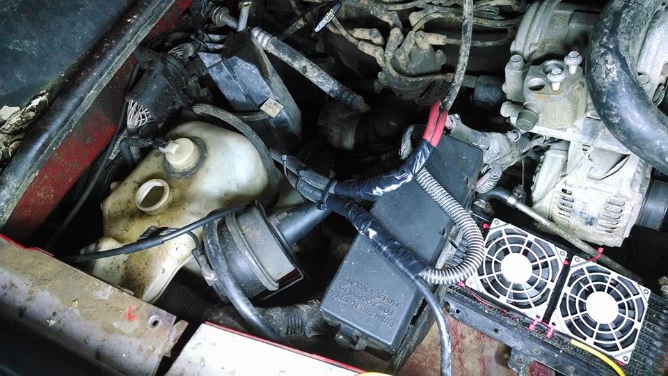

Mine is separated and I put computer fans on it for extra measure. :afro:
