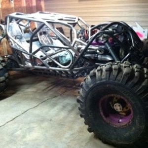

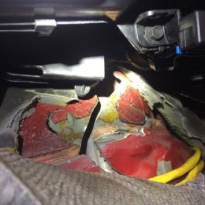

Looking for a twin stick shift boot besides the normal Atlas boot. I'll try and load pics to show what I'm talking about. My shifter tower sticks up above the floor so the stock atlas boot won't work.
I had the same issue. I ended up having to build a small box over the pivot point and bolt the boot on top of it.
I could possible make a small center console of sorts to do that, but would like to avoid any more fab if I can!!
Cut the top off a single boot, pop the atlas boot though it from the inside n seal with rubber cement
Not only do you not have enough depth for the boot, you don't have enough base area. I had a friend who does upholstery make a custom boot for me once. It wouldn't be rubber, but they have some heavy, black canvas type material that works pretty well....something to consider.
I do have enough base, there's another panel that goes on right there, just wasn't installed at time of pics.
