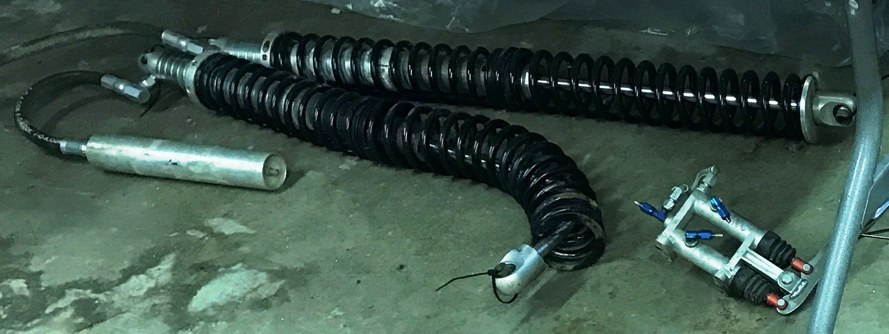

I've emailed the owner 3x trying to get a new shaft and rebuild kit so I can get these sold for a buddy.

i have had a leak on mine change fluid and some seals and have not had issue and as far as customer service i have called the owner super nice guy but he did tell me not to email either call or order of internet but fastest way is just call
just call or order from online there email is **** the owner told me not to email
