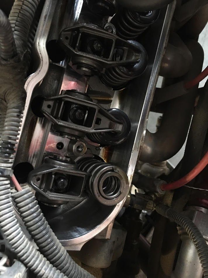

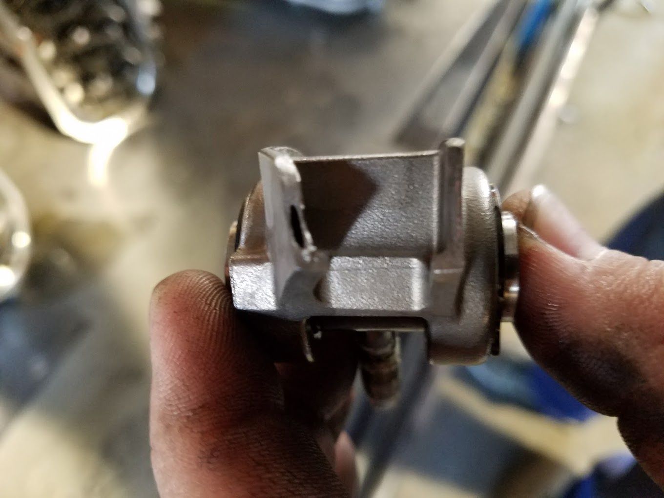

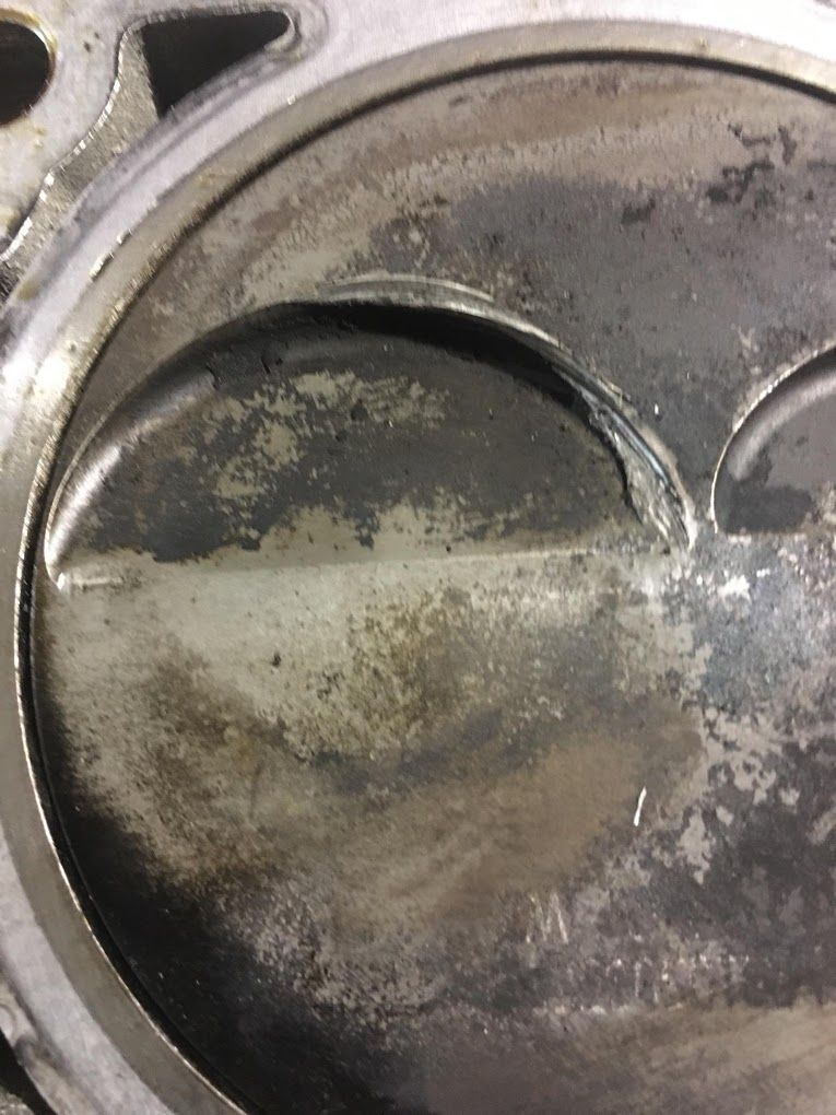

Had some engine trouble recently. Broke a rocker arm which lead to the valve spring coming apart and dropping a valve. It's a hand built Mast motor so I'm letting them call the shots. They want both heads back for inspect/repair. After pulling the heads, we found there the piston smacked the valve. Mast is saying just buff it out with sandpaper and/or die grinder. I'm no motor guy so I typically just do what they tell me. Would you guys be ok with that "fix" for the piston?

That said it's not looking bad at all and I wouldn't be too worried about running that after proper care has been applied.
Here is what I use to knock the sharp edges of pistons with, they work great.
Sent from my XT1080 using Tapatalk
Unless it has ARP hardware, the rod bolts will need changed as well. This begins to be a snowball effect at that point. I would think since the valve was free floating the bearings wouldn't be affected. I would leave the bottom end alone unless you have to pull the piston to replace it. As far as the piston goes, be gentle but knock down the high spots and rock out. You just don't want to get crazy with it for rotating weight purposes.

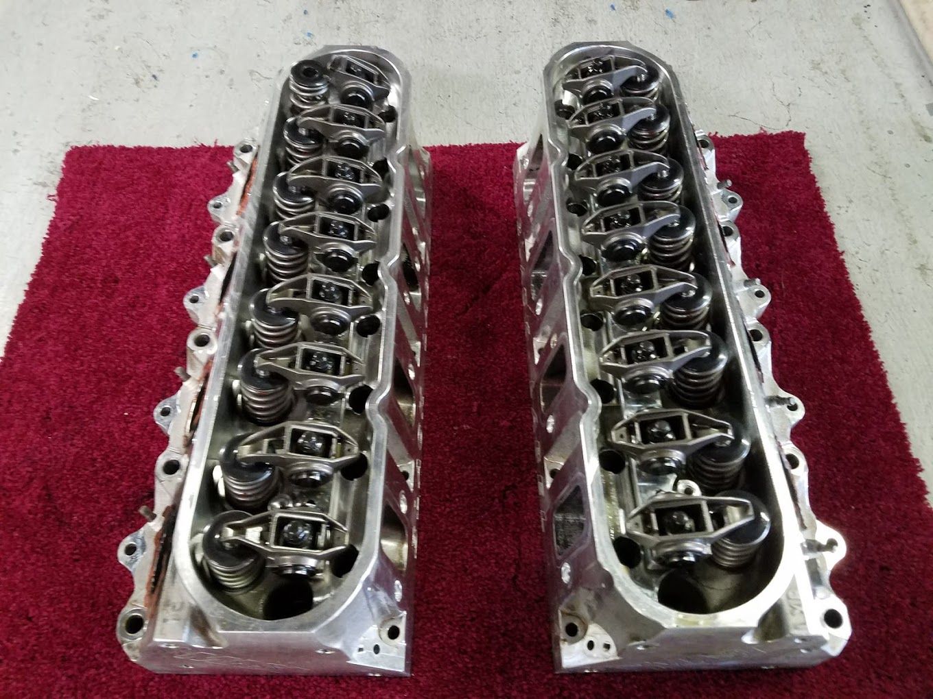

Valve is ****ed but not bad, it was relatively straight. Luckily it stuck straight up in the head as soon as everything let go so it wasn't in there bouncing around. Both heads went back to Mast today. The passenger side head is fine but they wanted both back.

All up to the owner but the piston hit atleast once metal contact, maybe it didn't hurt the bearing at all but changing out a $5 part is cheap to ease my mind.
