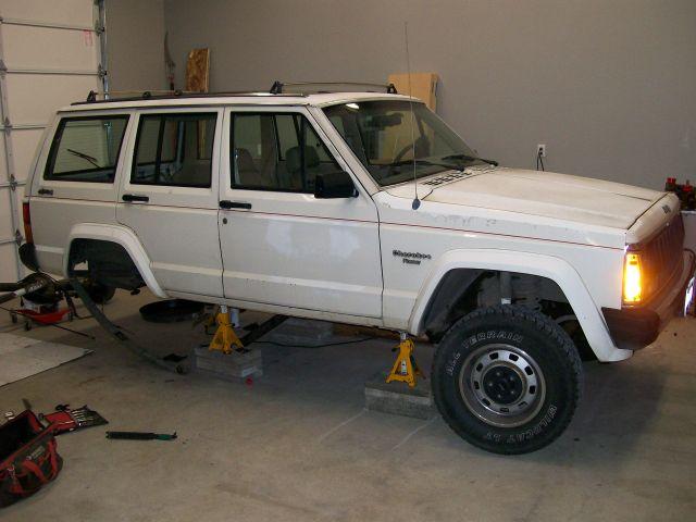

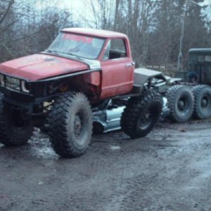

PM sent. Kill this thread, motor swap is now on hold for the usual- lack of time and funds. I will though soon have a cherried out XJ grocery getter with a poopy 4 banger. If my work turns out presentable I'll post pics in the buildup section. I didn't get a 'before' shot but here's a pic after just beginning.

should've put the jeep facing the other way.Easyer to get the engine out me think's.PM'd you again..:hi:
You can't tell in the picture but there's plenty of room and my toolbox is closer. I might take you up on that 2.5 you got, I just gotta wait for my impending promotion/ career change to play itself out before I throw money in any direction on this. For now I'll be tearing down and doing chassis, body, and interior stuff until I make a motor decision.
