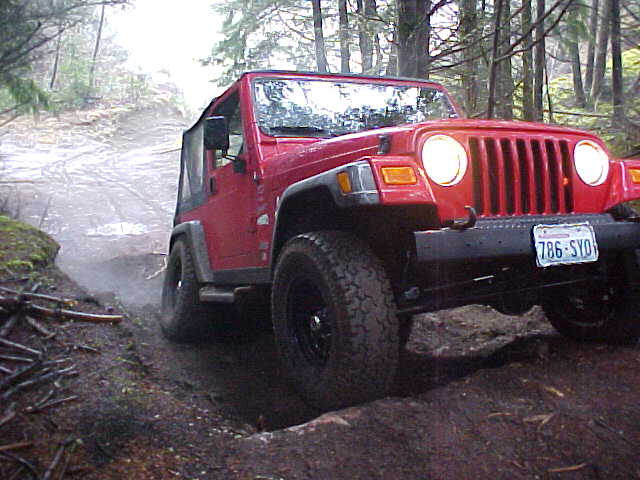

well as of the body shop work tonight, with the sway bar f/r gone she can flex up a jersey block. i am gonna go with a 1" body and still undecided on how to lift the rig
