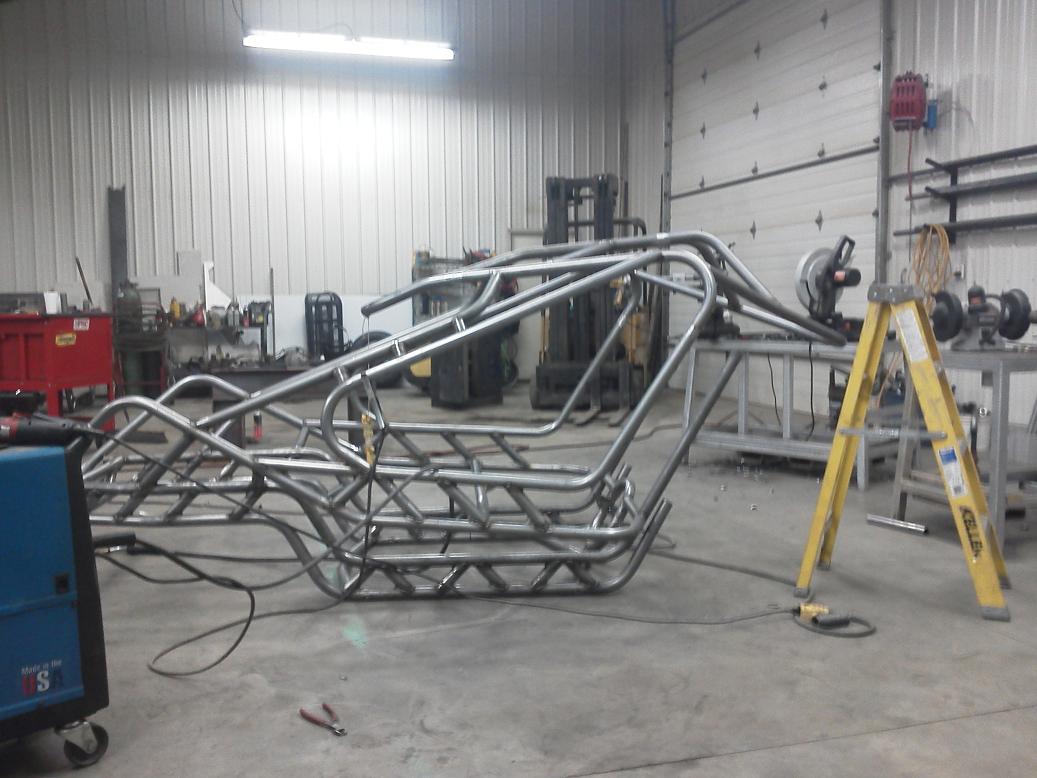

Have had alot of ideas rollen around in my head about a new chasie for my buggie Bounty Hunter specs. 572 chevy 400 turbo switching to a lomax from 205. sick of breaking front 60 every time i start having fun,so i ordered a prorock 80 for the front and a reg 80 for the rear. it will be 4wheel steer . Picks on the way
need to download to photo bucket
top of buggie will be 74'' with 24''at belly . I have a good 3 to 4 inches head clearence with a helment on,yes a helment molaugh. with engine placement as low as it is vision will be awsome.all 120 and 188 dom hopen to be 44 to 4600 :popcorn: Hope to make more events this year its awsome just being a part of the srrs thing ,every one is super nice and is in it for the fun of it not so much the comp side.

I gotta ask, only because I'm struggling a little with my build...but is that jig built? How do you know where to position your coilover mounts in relationship to the chassis without actually having axles in place?
Great looking chassis! 8)
