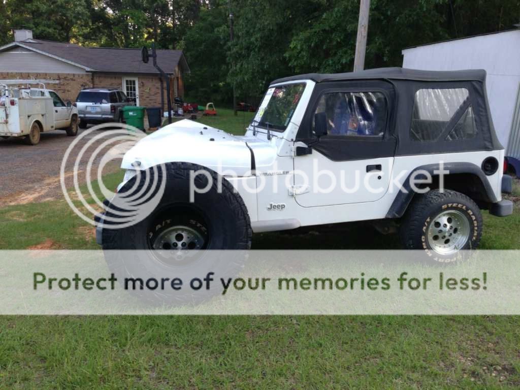

I am the General manager for a trailer sales company, the owner of the company also has a 30 or so acre salvage yard. I put him on the lookout for a TJ with light damage that I could use as my starting platform. It was not to long before I was the proud owner of a 2002 Tj SE automatic. Just to let you guy know this thing is a power house. In Mississippi if you take the time to completely document the repair and do all the associated paperwork you can have the salvage title on your vehicle changed back to a completely clean title. The catch is the vehicle must be returned back to stock form before they will inspect it. I got the jeep fixed up and rolling and now it is time to tear it apart.
