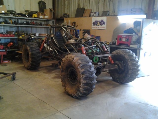

I guss ever since timmy came out with his I just couldn't get my mind off of one . Dont have any plans to race it . But look forward betting the **** out of it .it is not for sale till I get my other one done an I might just keep it then also .
So here we go
350 built a little different
14 bolt chevy 60
Th400 an 208
probably be on 43 non stickeys or the wore boggers till I get done with my 14bolt front
Weld in industrial himes
Runing on pane
O an built out of 100% 1.75 188 wall hrew

Not sure what picture's yall want but here is a few. Not done with the rear had to order another radiator the one is to wide .an with the torus fan can't get my tank up far enough . I wanted my shocks close together an with propane that can be a challenge so after seeing the mo fab toy build I thought I would build it like that but a little different .I'm going to build a cradle that I can hing from the top an lift it out that way I don't have to try to hold it up while I'm latching it an it keeps my center of gravity lower also
