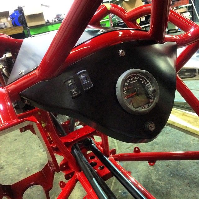

EOR is wrapping up a new tube chassis rzr
Should be finished up soon, I'll post progress pics over the next few days
on to the specs!
2014 Polaris rzr 1000
Big Bore kit 1189 CC
Rage 6 Clutch
extended wheelbase 4"
custom long travel suspension 6" wider per side built from 4340 Chromoly
drastically reduced overall height
Chassis is all 4340 chromoly tubing
Corbeau Baja SS seats
UMP filter for riding the dunes
Custom made stainless exhaust
custom aluminum console and dash

The RZR is coming together nicely
We stripped the coilovers down yesterday and sent the springs to powder coat - those Kings are some kind of nice!
also got the STM Billet clutch installed
the HCR arms look awesome with some color!
