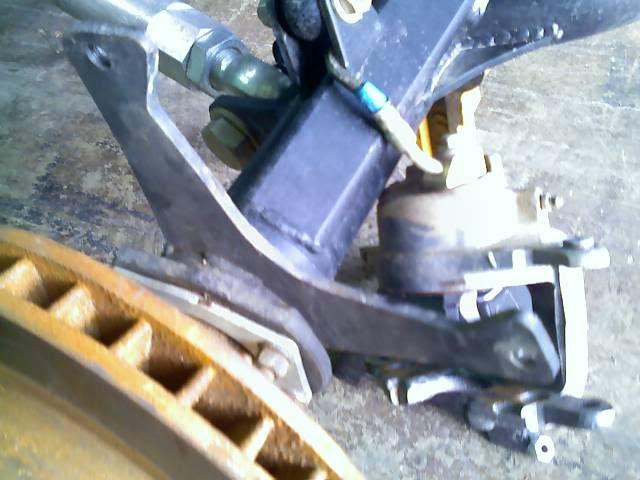

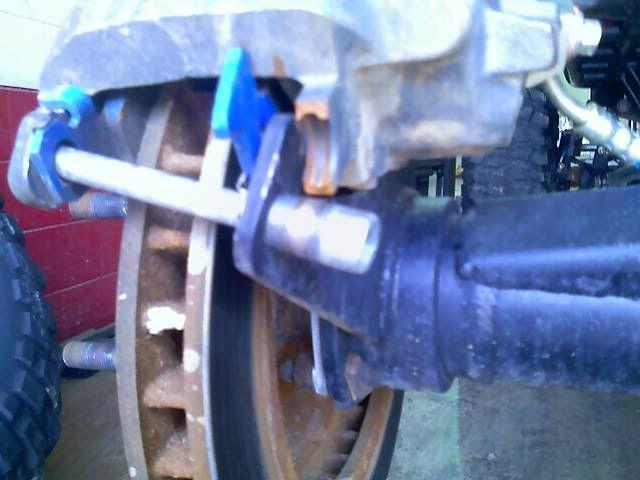

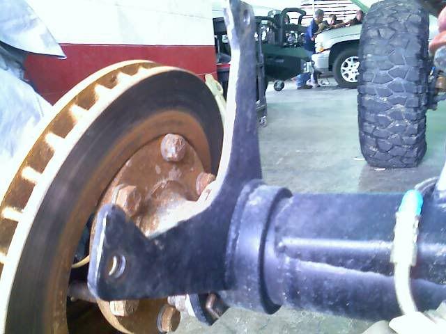

Also noticed I broke the Rear left Caliper. I have no idea how this happened, but it tweaked the bracket pretty good and now I need a new one.

I have stretched and broken several calipers like that. Mine will seperate and then it breaks the ears off the calipers. First one was from trying to drive off with the line lock on.
One of the problems is those brackets. I have what looks like almost exactly the same brackets and they are not particurally beefy. However, I trussed mine to the tube with some angle coming off those long unsupported spans and they have held up for years now with no issues.
We just gonna beef them up to about a 3/8" plate instead of the thin stuff it is now.
