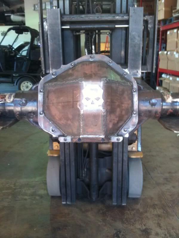

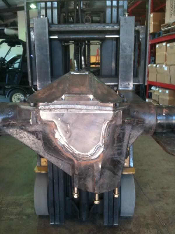

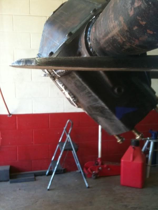

14 bolt is coming along.
Big Thanks to Daniel for shaving the rear axle and narrowing it.
EOR had my hubs machined to 6 lug, get pics of those later.
draggbody said:
did that require machining the ring gear at all.. if so, any pics of that???
Yeah you have to take 3/16th of the ring gear. It hasn't been done yet. Should be done this week. The guy who sets all my gears up is doing it.
He said earlier he was going to run stock shafts. Im guessing he is running 2 stock short side axles. Same thing wyatt did.
I predict future breakage. Nothing is bullet proof. Looks good though, I like the shave. :dblthumb: Now get it together and go beat it like it owes you money.
Stock short side shafts for now if I start breaking them a lot I will upgrade to SpiderTrax or Ouverson shafts.
