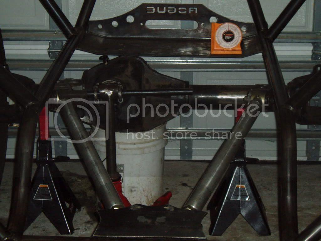

On a serious note, what would be the consequences in running my front axle like pictured?
rock mafia said:
im sure redbulljeep will approve of that angle and the 1350.... you must have bought one of his "technique" videos.... :flipoff1:
The consequesnce would be spending more time and money to re-do it proper after the frist time you had it out ! laughing1
Cole said:
Hey Greg has a guy that will warrantee the Center section for life as long as I let him build it so im not to worried.
Well if you run 50* steering you can set it up with 106" wheelbase on the pass side and about 110" on the drivers side ought to work out about right :spin:
Just move the axel to the left 'till everything lines up correctly. You don't want the front and rear tracking the same anyway. :spin: :popcorn: and :flipoff1:

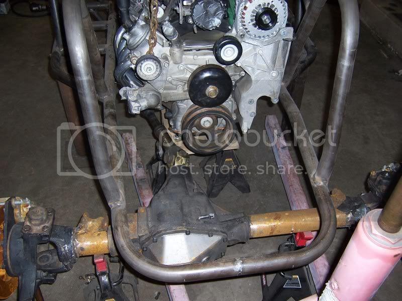

Cole or Jim, is that with a 2 piece DS setup? Would a cv dshaft help any? That angle looks terrible, I guess that is the downside of narrowing a stock 60 all out of one side. Why don't you employ that HP 60 you have cole and swap all the outers over to it.....
I have already told Cole what he needs to do. Remember he's hard headed! :flipoff1:
Really what we will prolly do is lengthen the driver side out some and take some out of the short side if he wants to keep it somewhat narrow.
Is that at full compresion or at ride height?
I am going to be in the same boat on mine so PLEASE post up picture of what ever you decide.
This is at full compresion.
You find me someone around Gibsonville NC that will lengthen my axle and I will have it done.
Yeah I am sure thats with a 2 piece D-shaft.
If I use the HP 60 I have it would cost a fortune to have it setup the way it needs to be setup. Moving it to the other side and all new tubes all the way around gets expensive real quick.
It's a lot easier to just cut down a full width housing.
