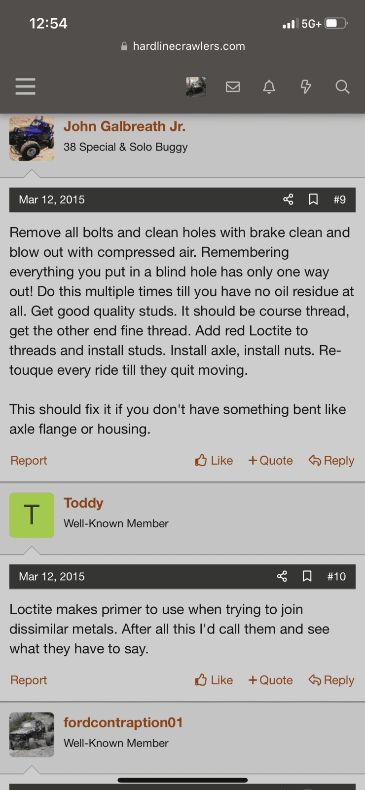

JohnG said:
Remove all bolts and clean holes with brake clean and blow out with compressed air. Remembering everything you put in a blind hole has only one way out! Do this multiple times till you have no oil residue at all. Get good quality studs. It should be course thread, get the other end fine thread. Add red Loctite to threads and install studs. Install axle, install nuts. Re-touque every ride till they quit moving.
This should fix it if you don't have something bent like axle flange or housing.
This is what I had to do, got tired of having to check the bolts literally between every hill, the studs cured the problem

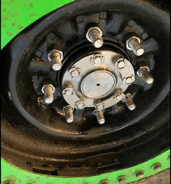

Bumping this thread for old time sake…
I can't put hubs on a 14 bolt without thinking of this post. I never met John but still got help from him through the forum.
