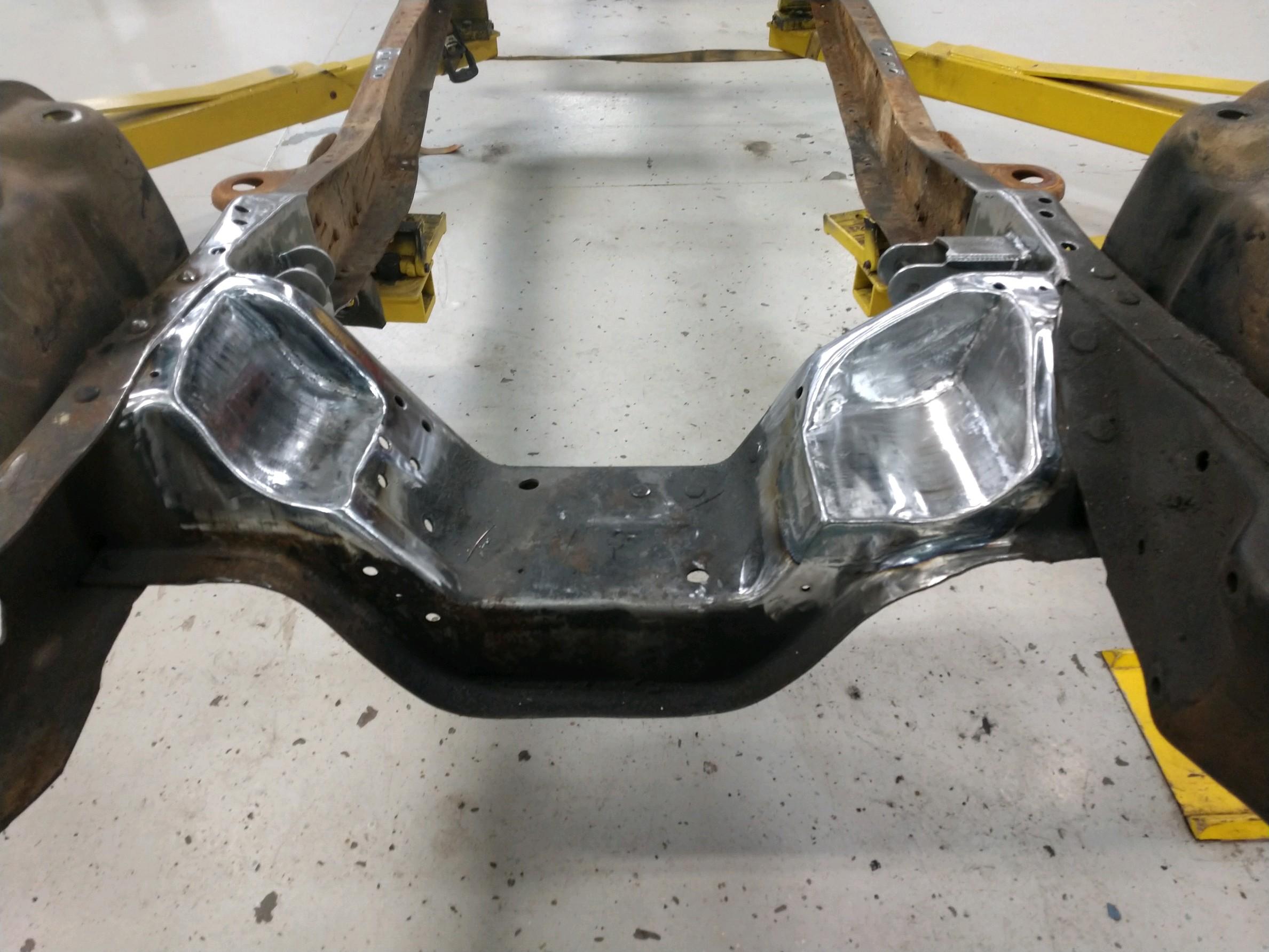

Frame is done, powder goes on this week

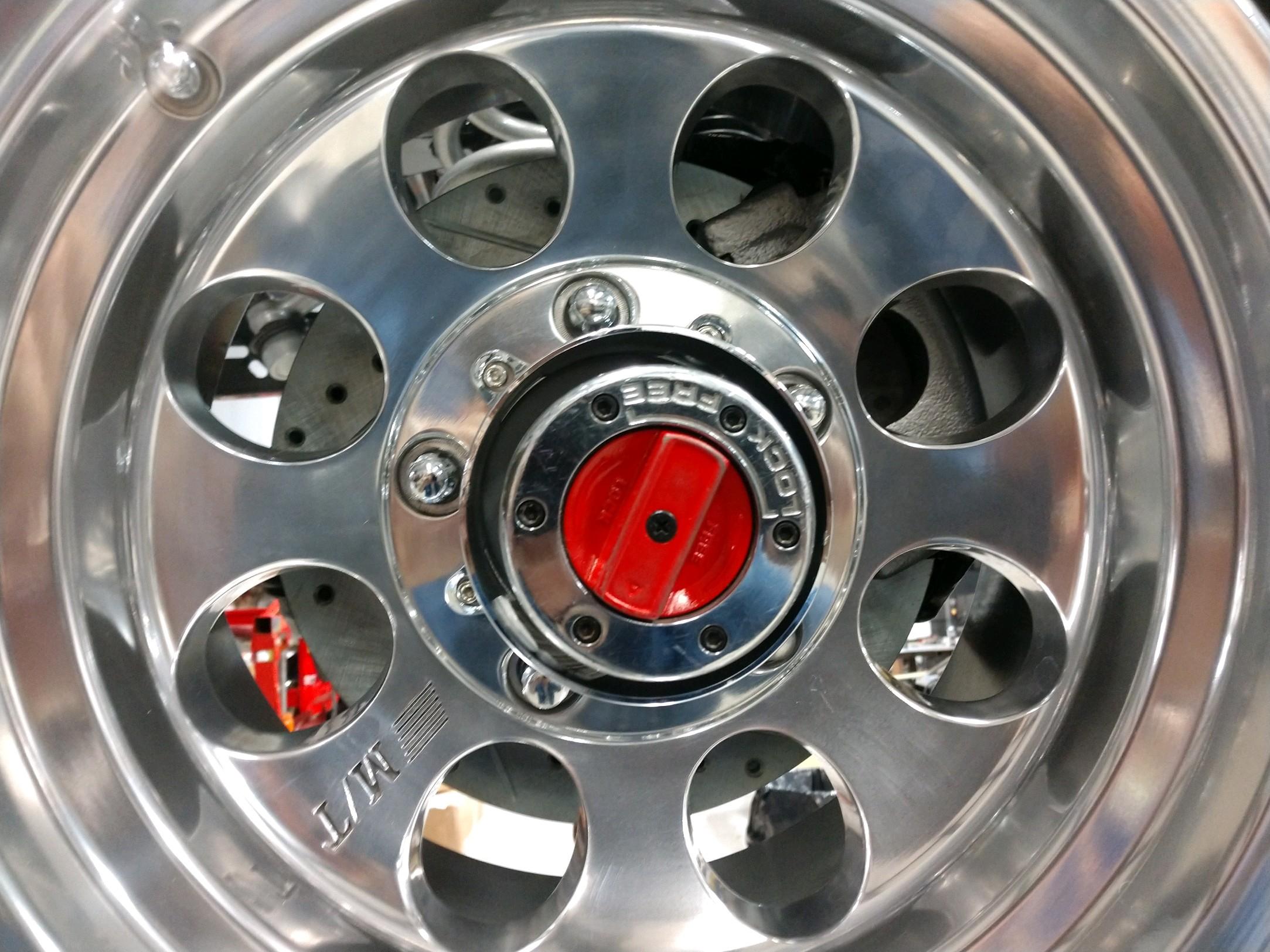

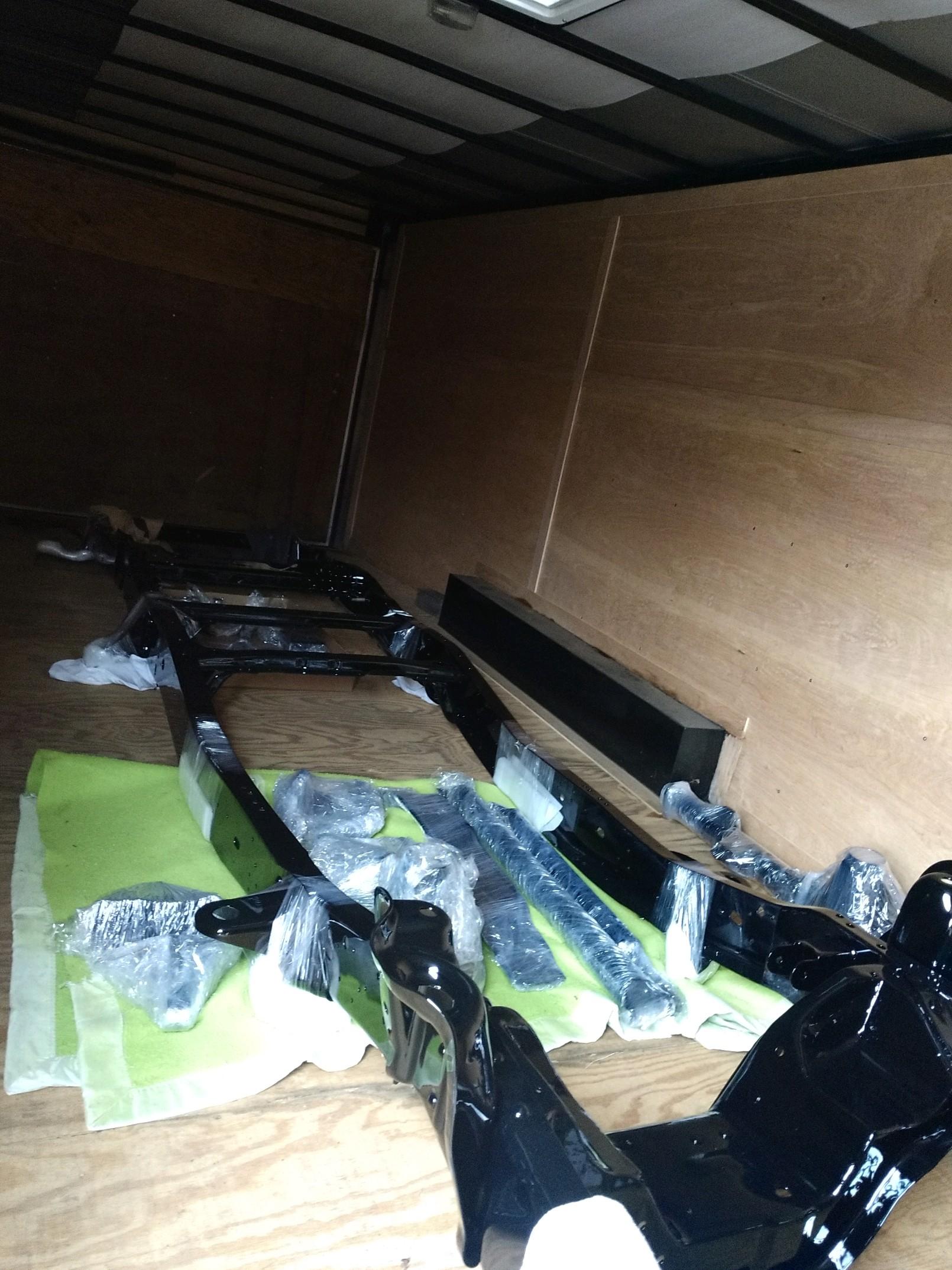

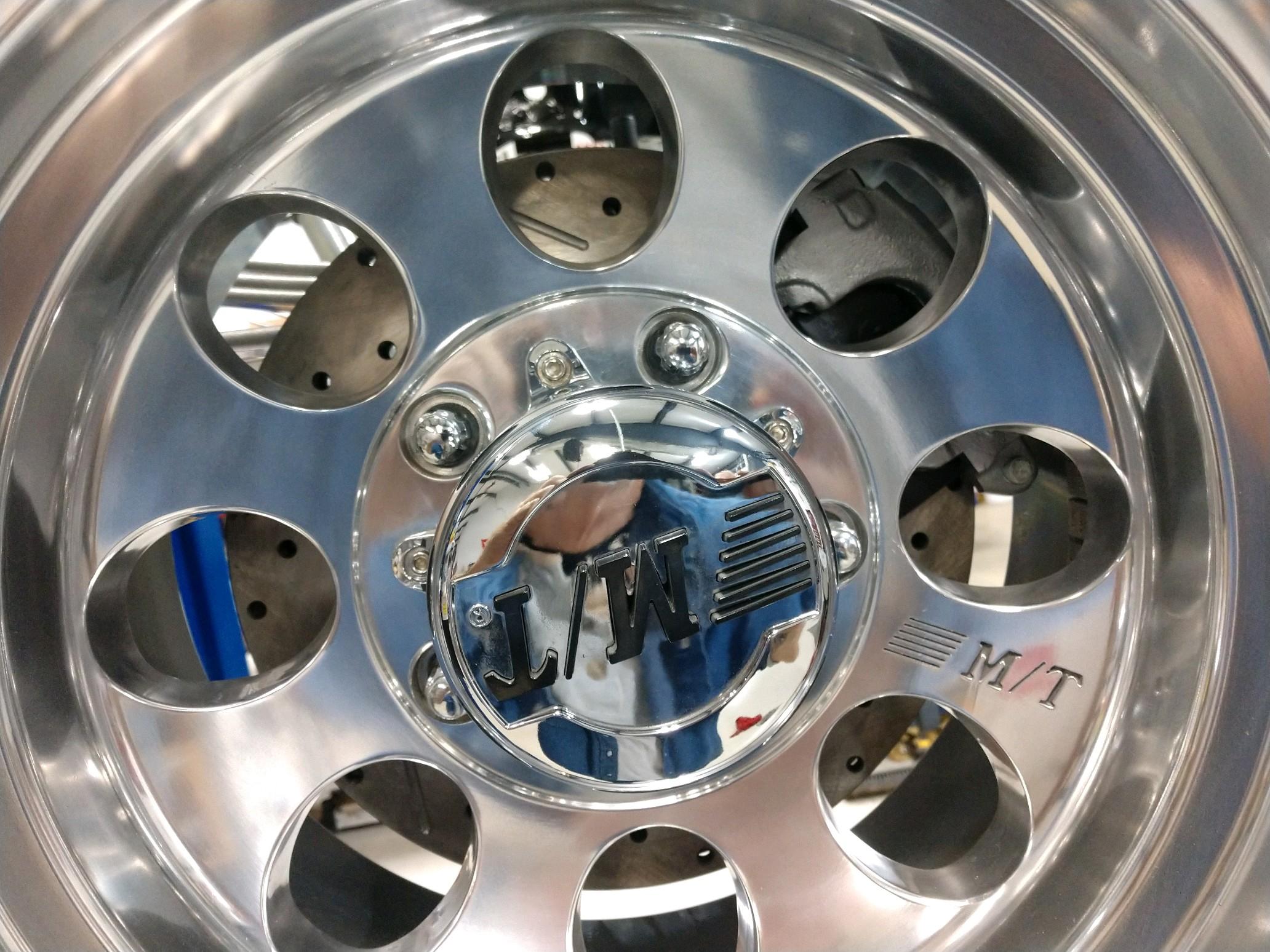

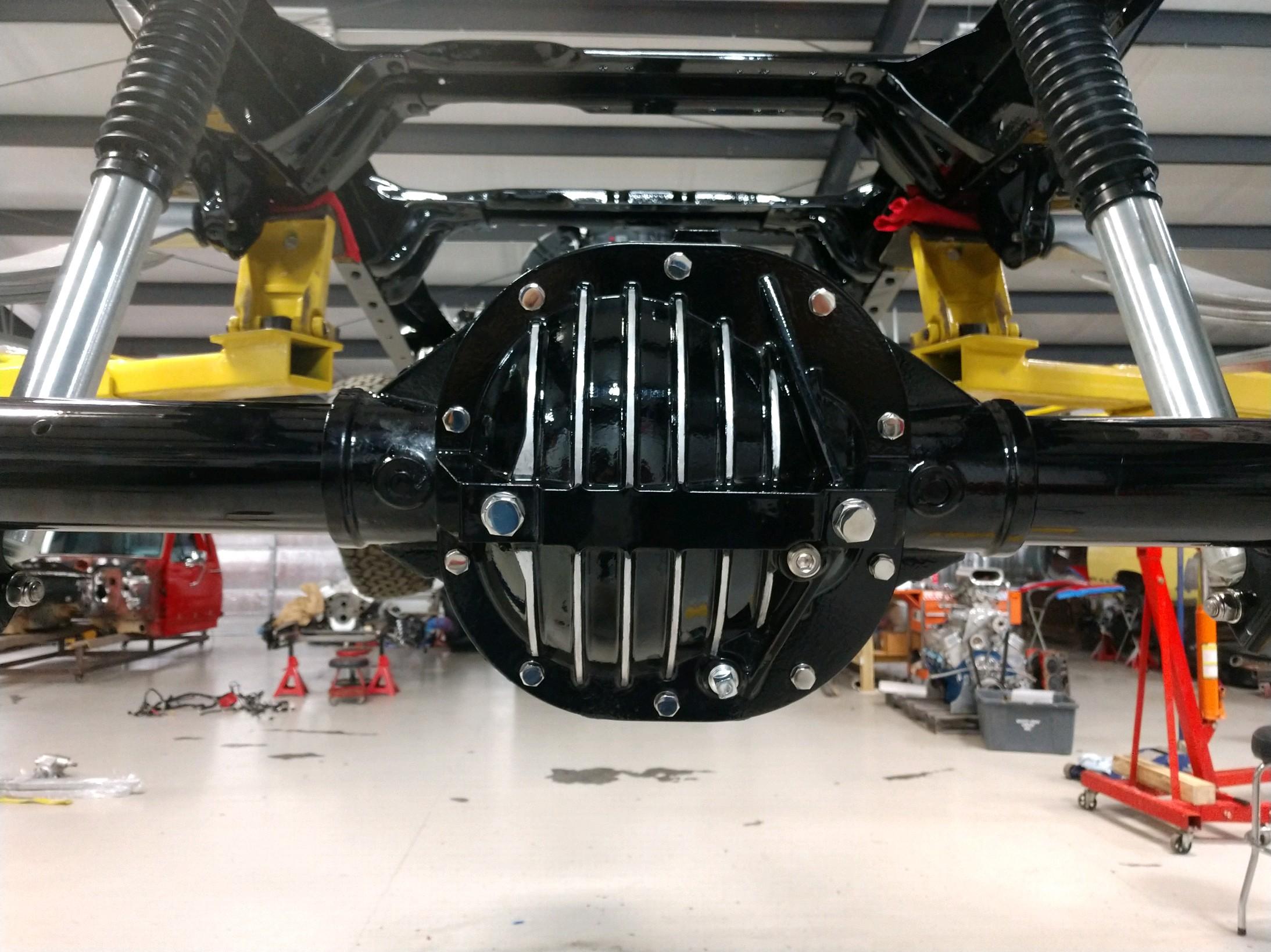

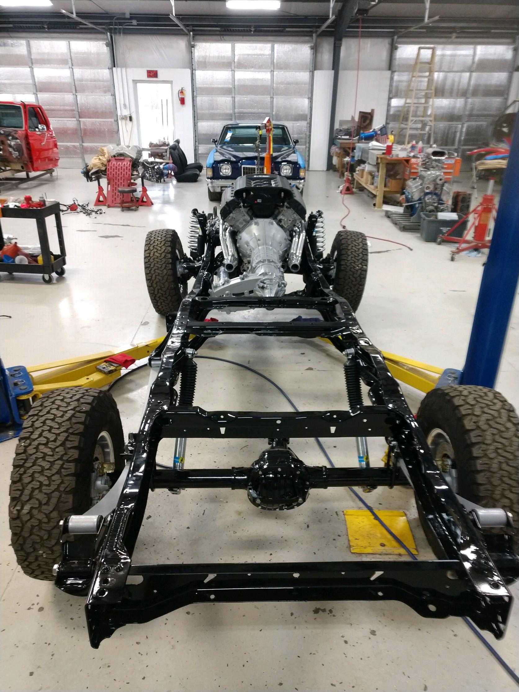

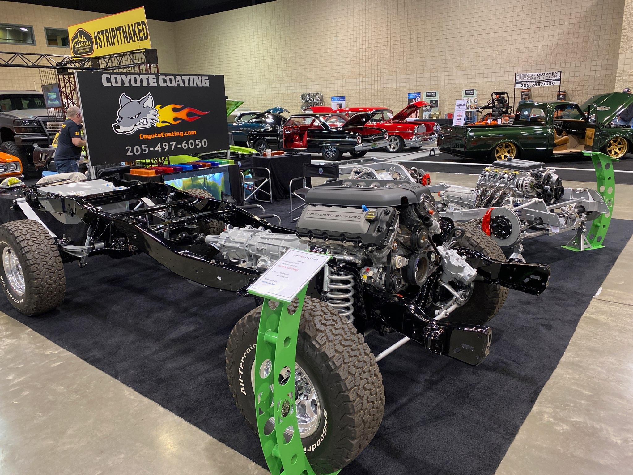

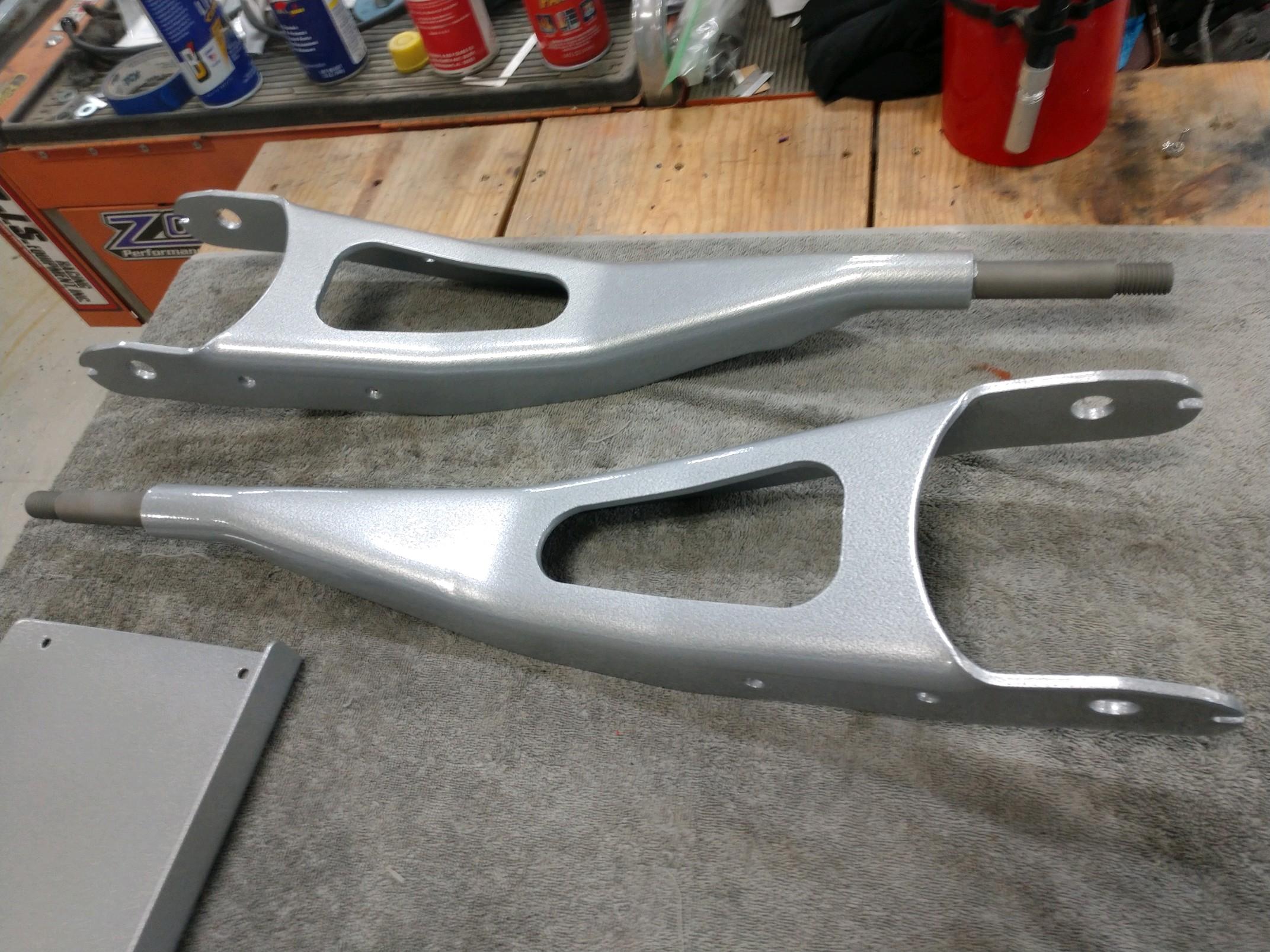

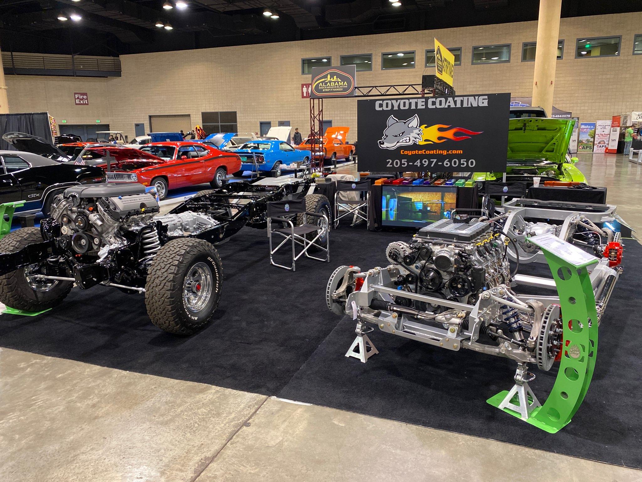

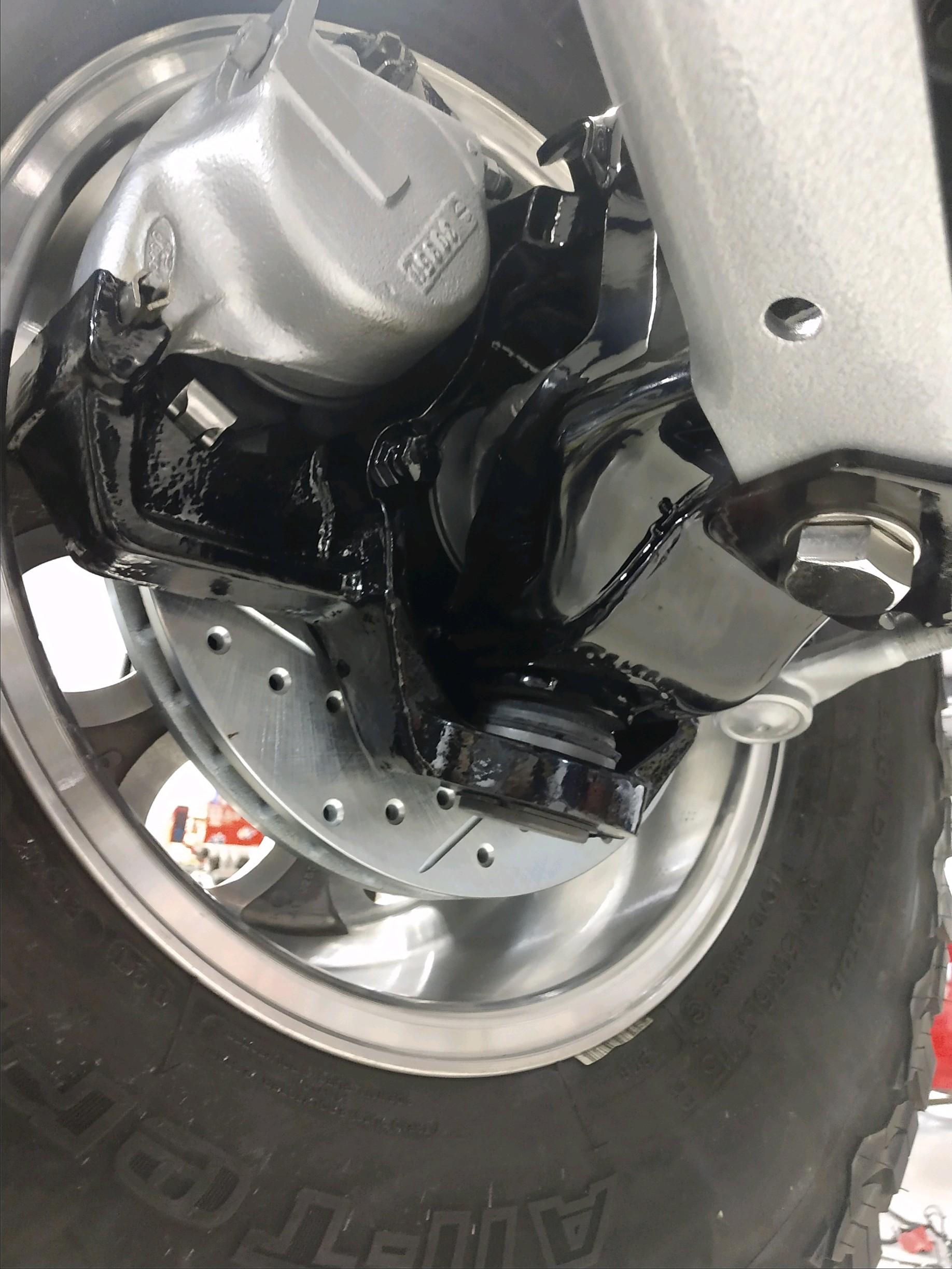

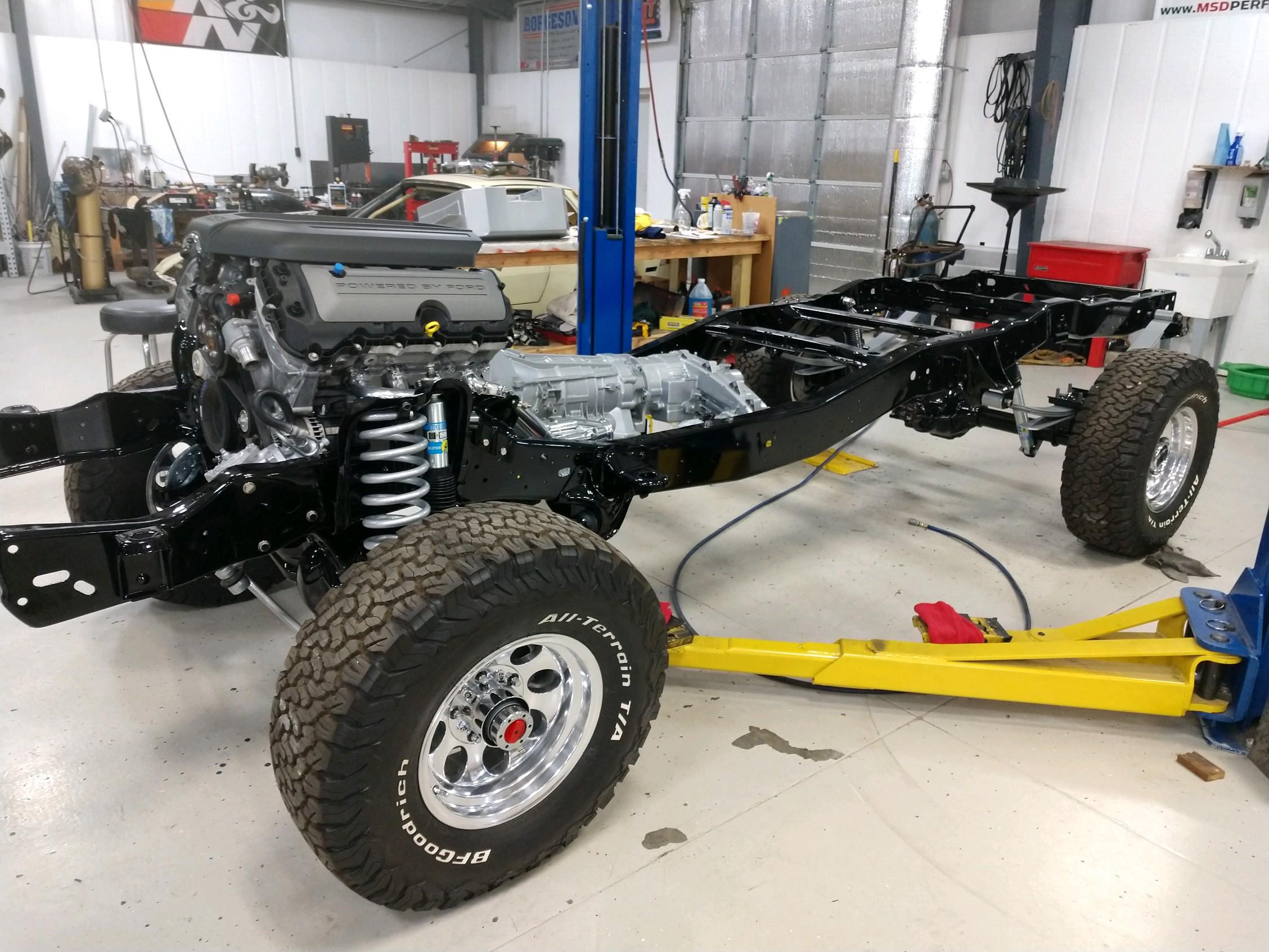

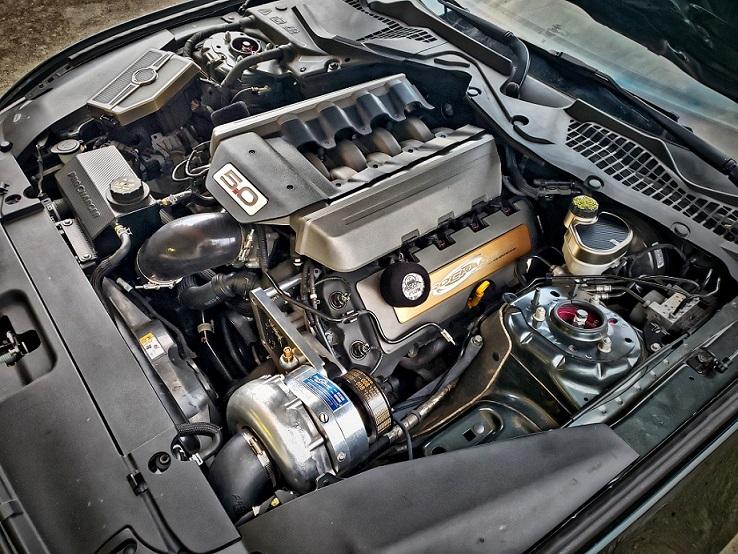

Rolling along much quicker than expected, all items are back from Coyote Coatings in Hueytown, Amazing job. Hand sanded all of it, and all was shot with clear. The chassis with running gear will be on display at Coyote's booth at the World of Wheels in February at the BJCC. It will have a 2.65L VMP supercharger on the coyote. Should make it a lot more fun to drive.

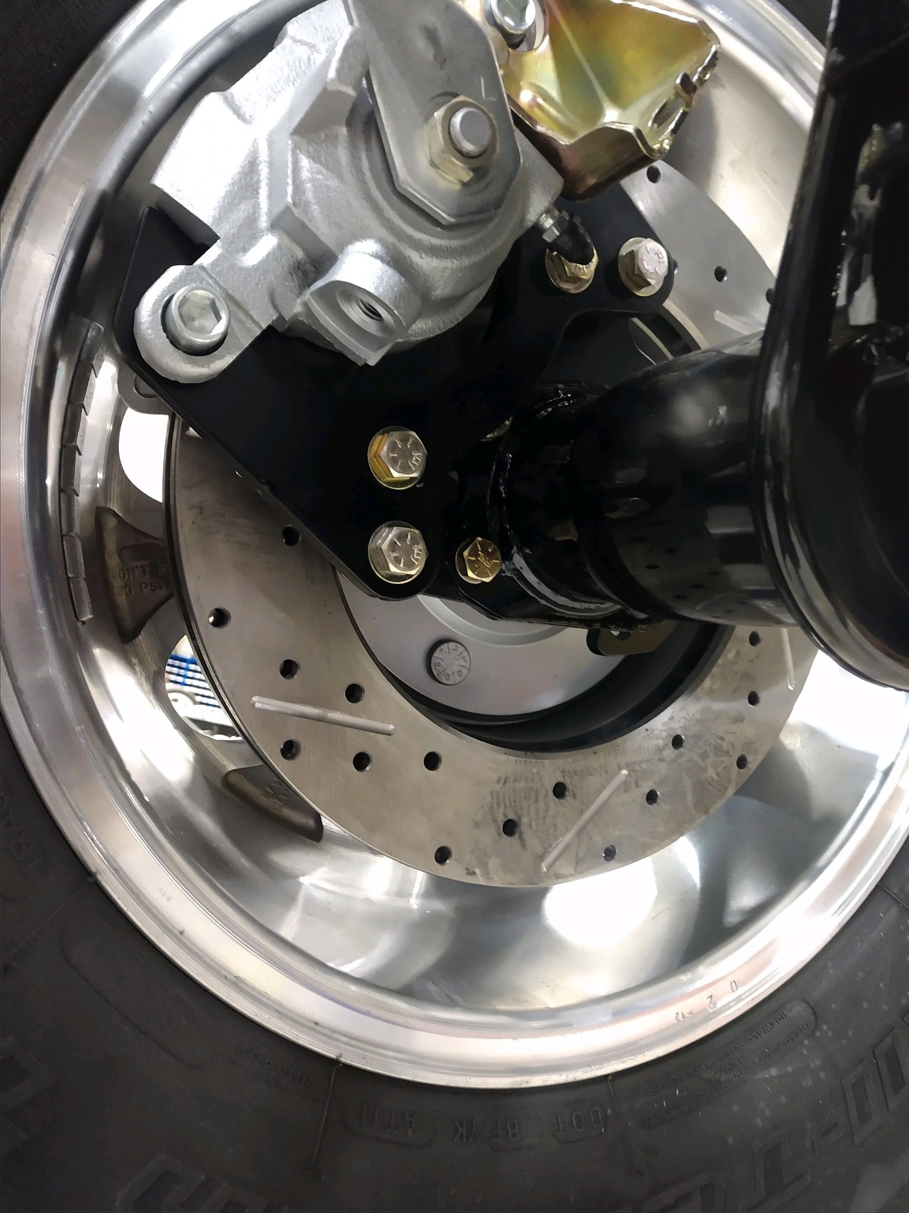

Went back with Yukon rear shafts, yukon gear install kits, drilled and slotted rotors all the way around. TMI hopefully will have the interior ready in 8 weeks.

Getting closer to ready for world of wheels

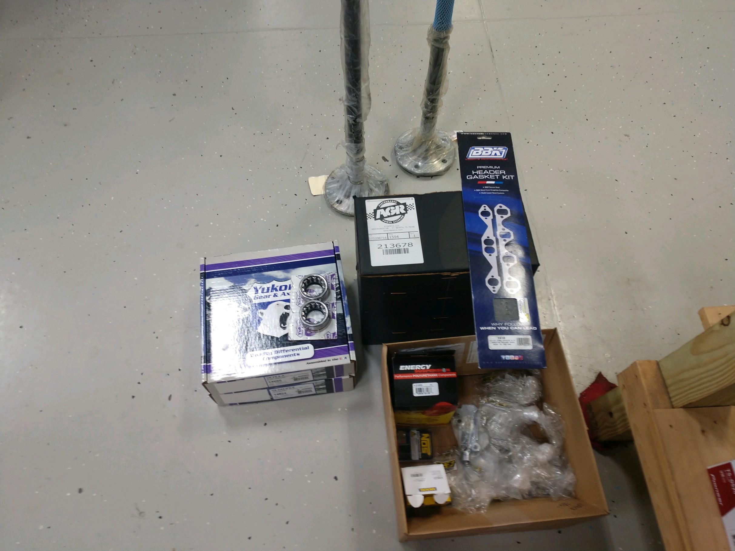

If you're needing some custom bits for the motor, Jason Lopez from CM Components does some nice work for the coyote motors. I had him do some billet coil covers for me.

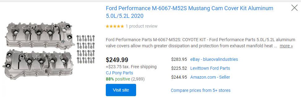

Also, while all this is out of the truck, there's a pretty sweet deal going on 2020 GT500 ALUMINUM valve(cam) covers. Like 250 bucks for BOTH. I was mainly thinking to pick up a set before they sky rocketed once Ford found out they can make a buck off them and sanding/grinding down any non important things and polish/clear coat them.

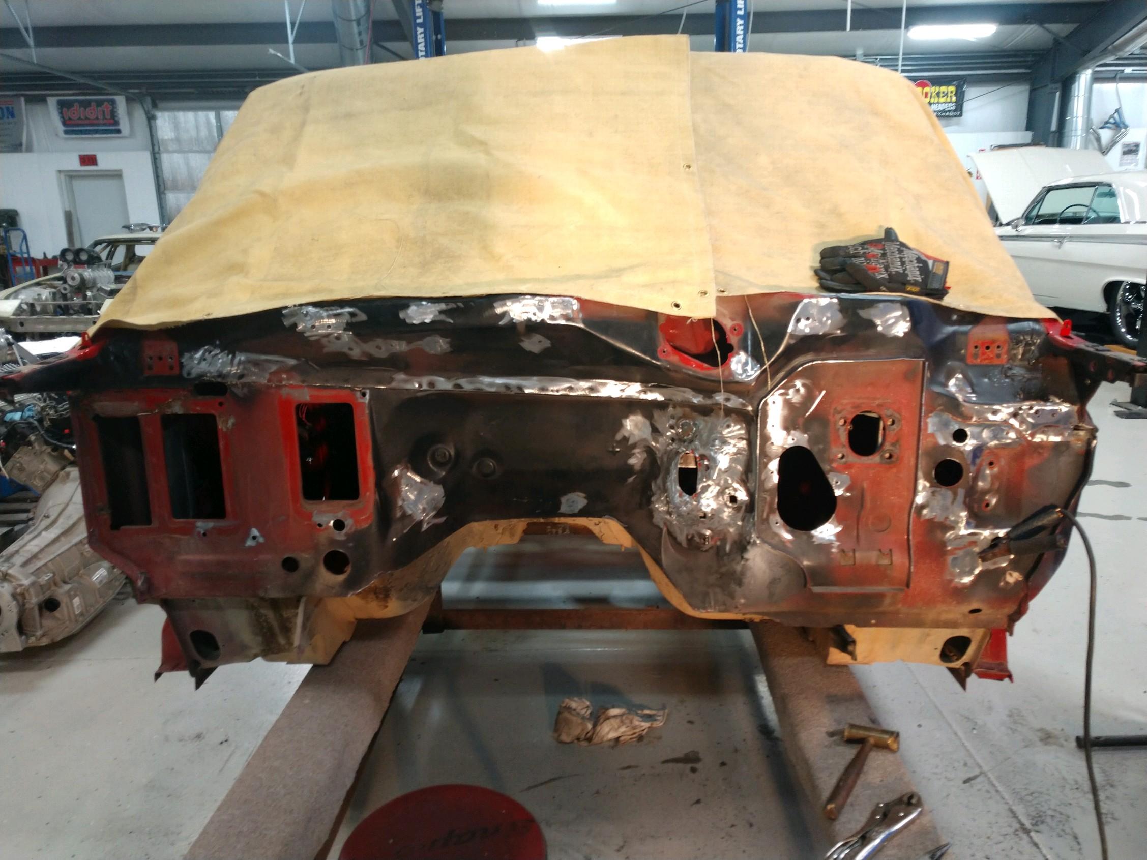

Just painting the firewall and inner fenders, the rest is show quality already.

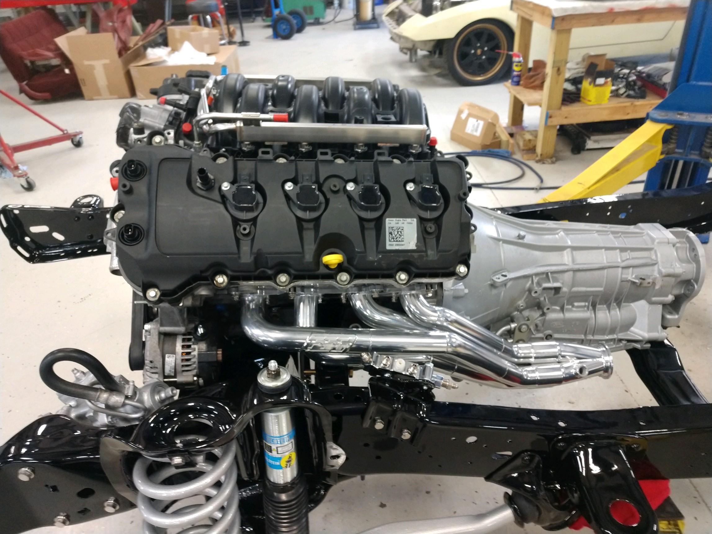

Couple more pics

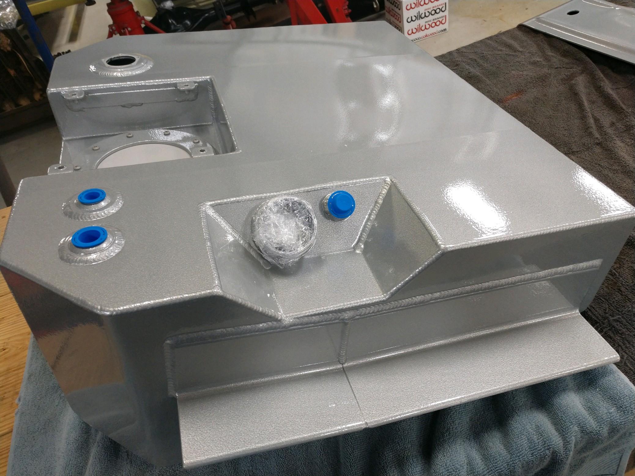

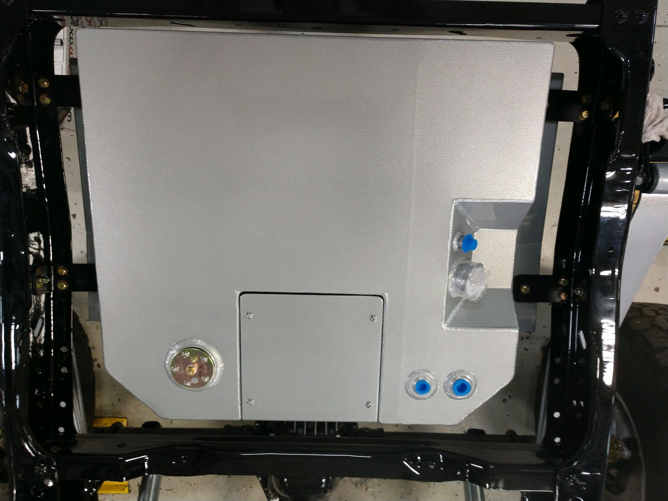

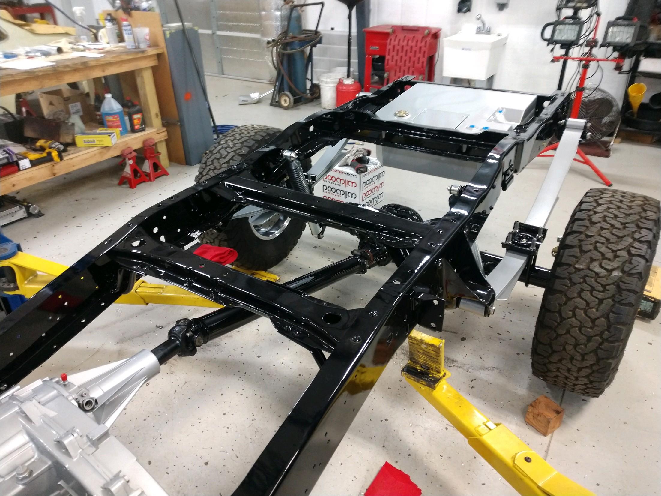

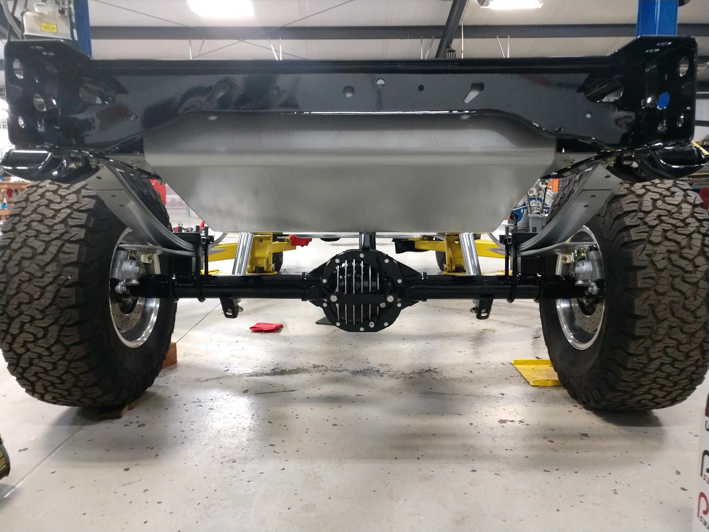

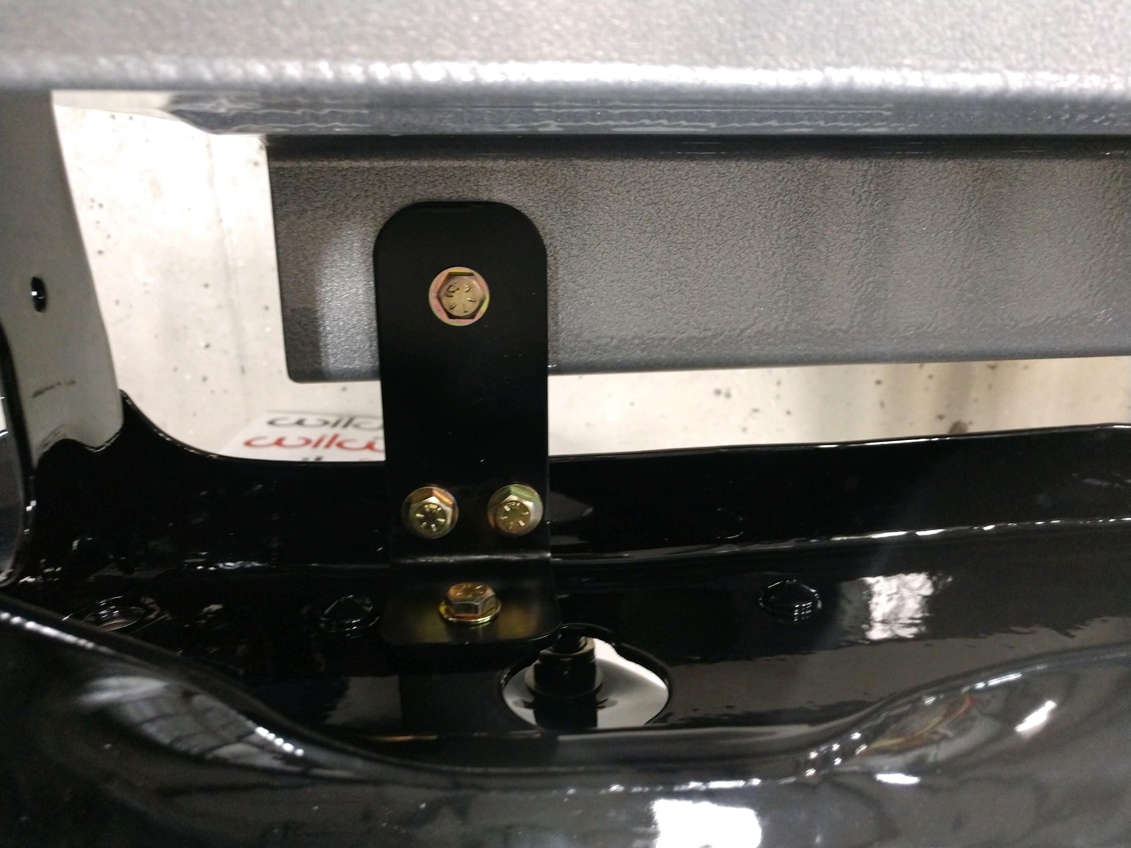

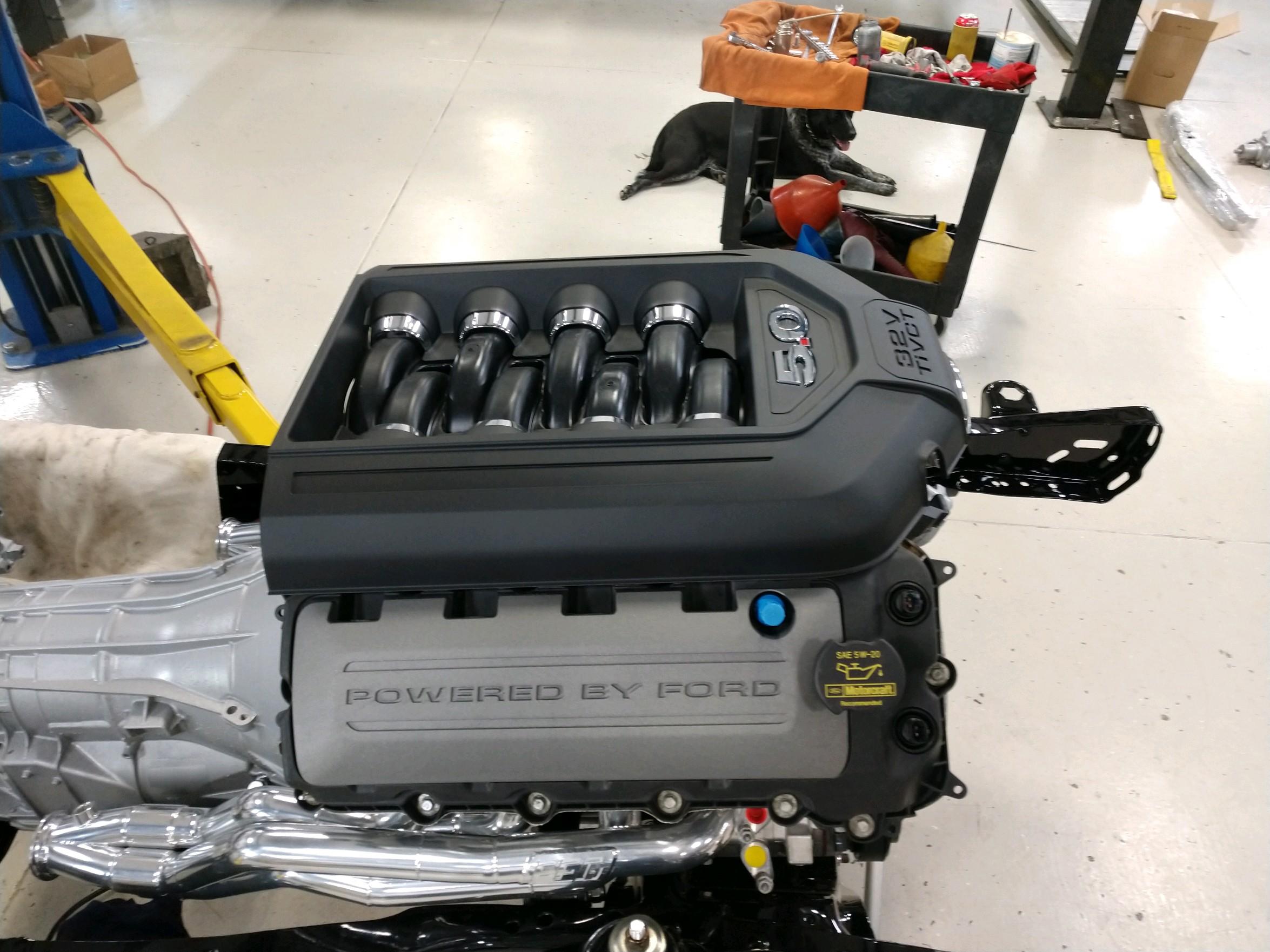

Fuel tank and rear drive shaft in, once again I can't brag on Randy enough for getting it this far this fast and Coyote Coating in Hueytown AL for the amazing job on the powder coating

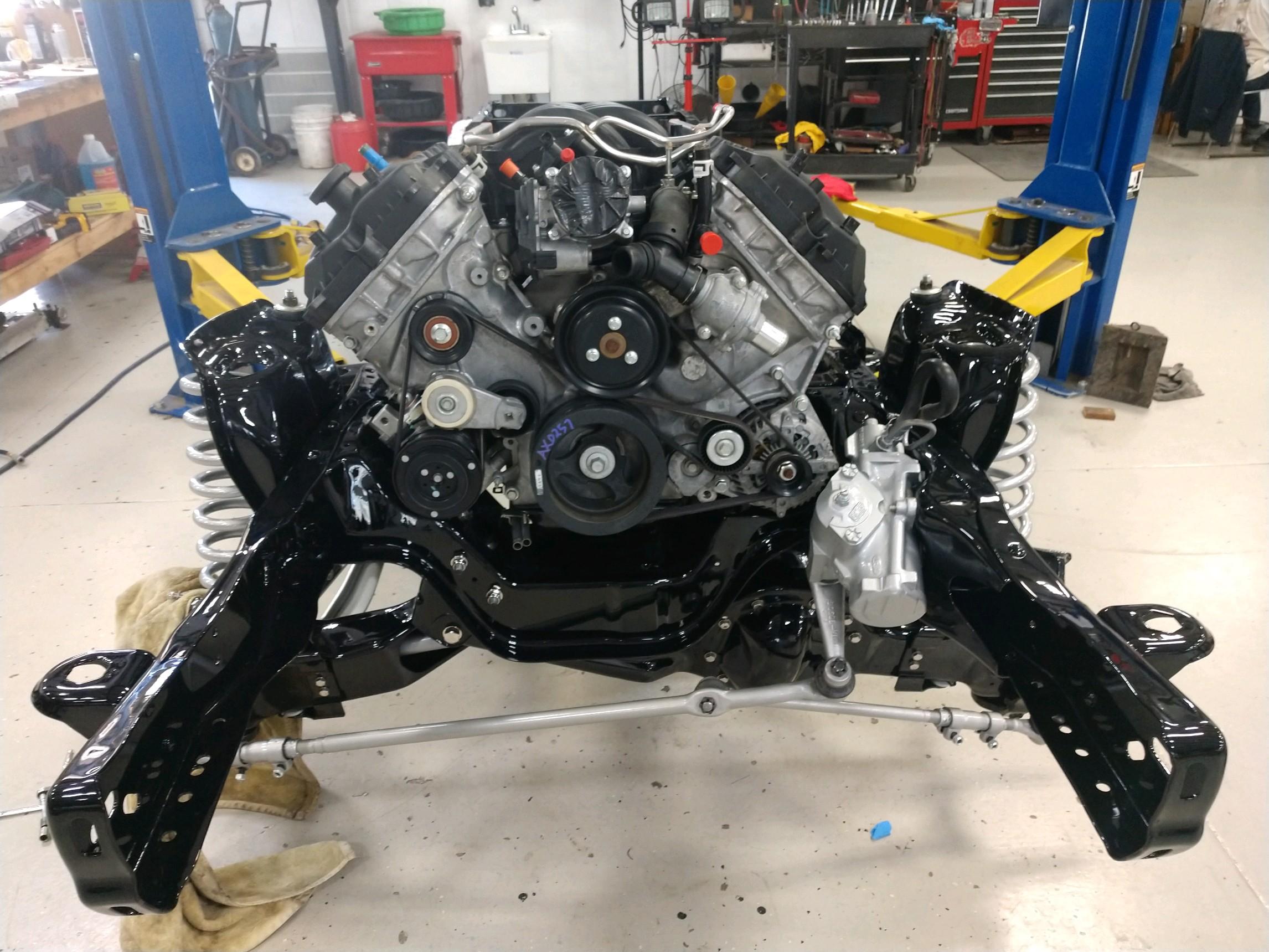

set up

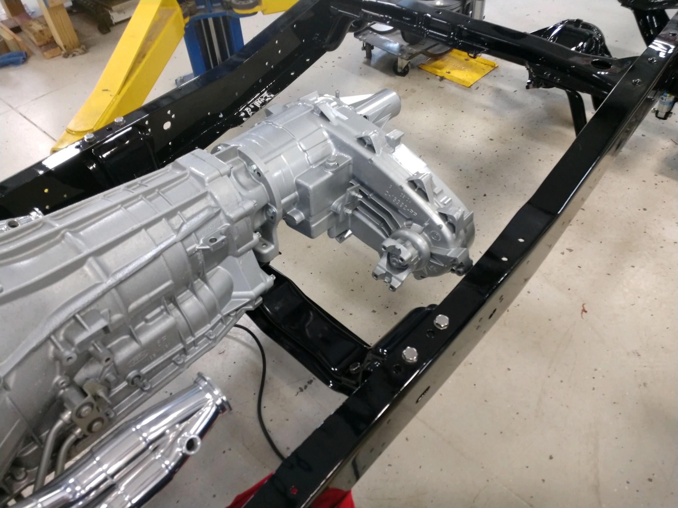

Replacing with 2014 Coyote 5.0
6R80 Transmission
Atlas to 6r80 adapter worked perfect with NP208

Fat fender custom 1 7/8" primary long tube headers, their radiator set up, KRC steering conversion, H pipe cooling connection from Fat Fender.
Will have all stainless exhaust, cut outs and Magnaflow. Also will have to build a custom cold air intake. Will be running a Willwood master cylinder.

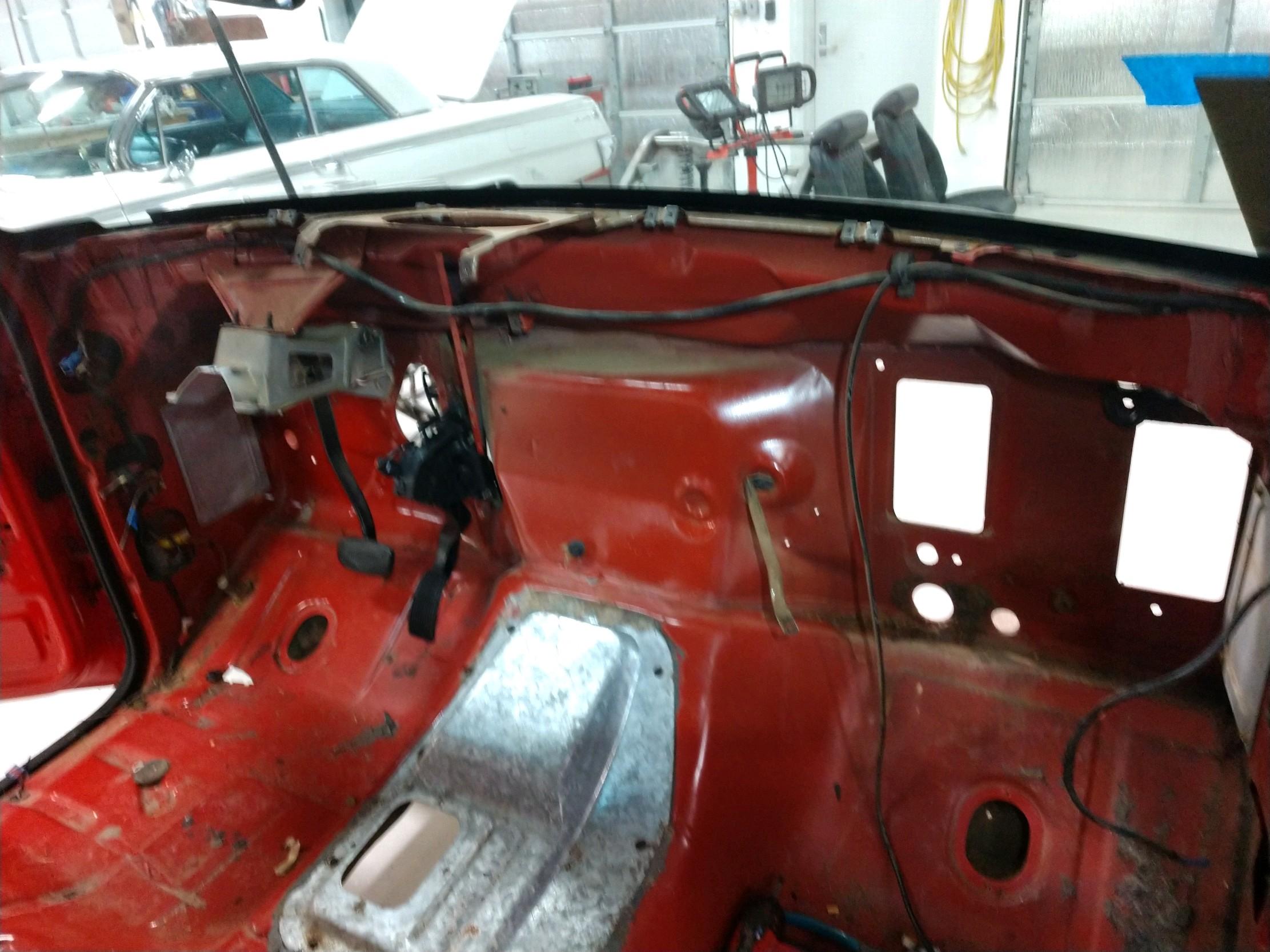

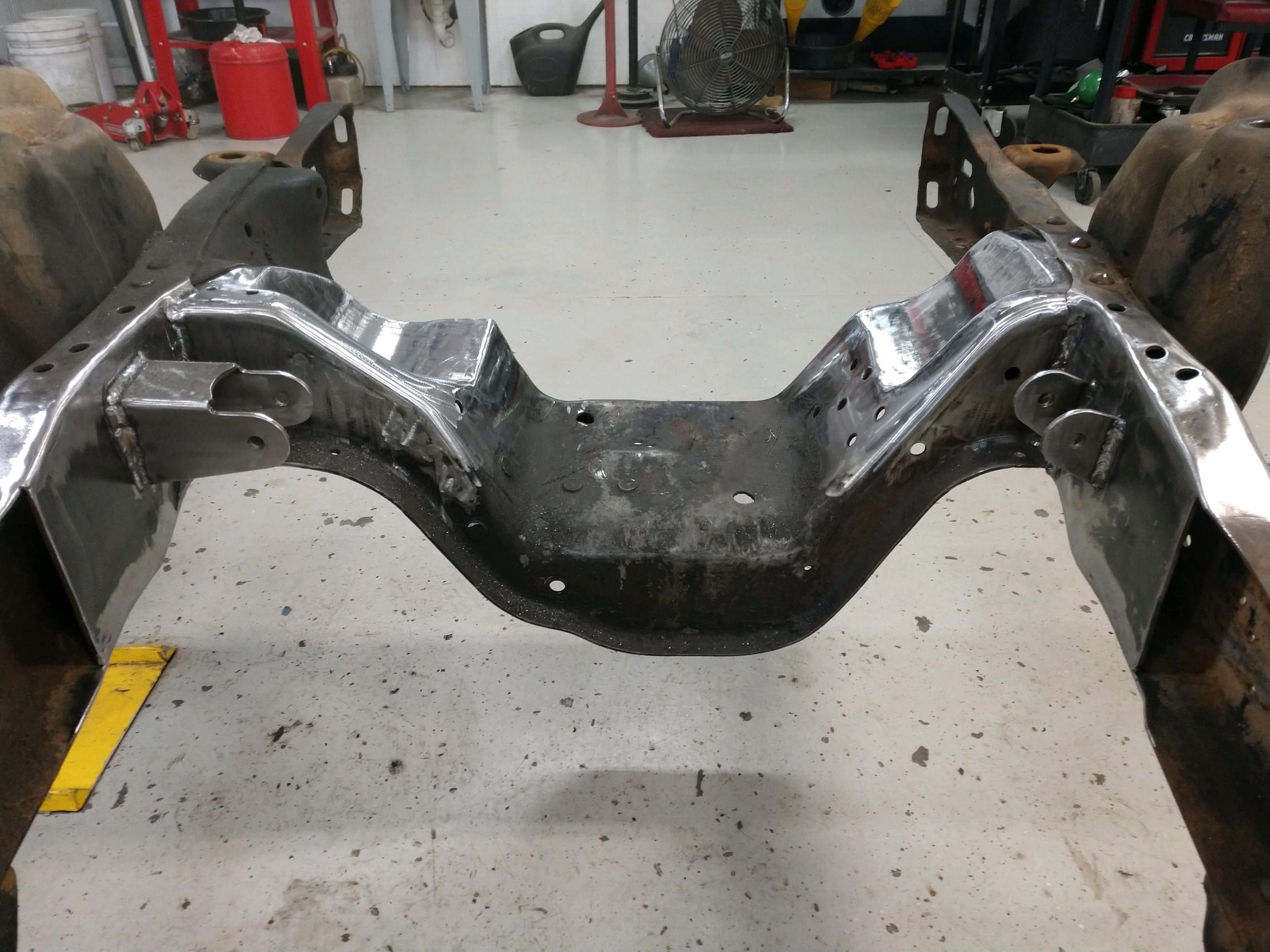

Pics so far, she is torn down, was waiting on parts until today.
