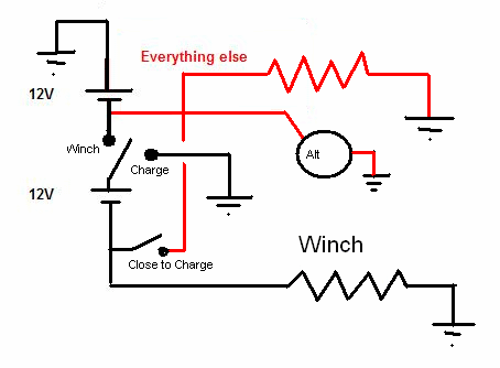

would this work. Just hook up your normal vehicle system to 1 battery and then wire the winch across two. In theory I see the voltage loop of the normal vehicle system not changing while you get a 24v potential for the winch.

Bobbo3234 said:
would this work.
That should work, but to be able to charge the second battery, you'd have to have a bunch of big ass switches. The 24V side of the system would have to work in two distinct modes; 12V parallel for charging, and 24V series for operating the winch. Hence, much complexity.
Well OK one big ass switch, but it has to be a double pole, and then another medium switch.
('Xcuse my while I butcher your drawing :D )
