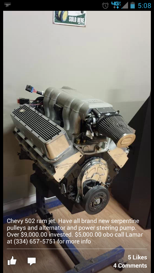

Freaknick said:it is a 454 block with a 427 crank is what he told me with the 502 ram jet intake
F-Bomb said:502 RamJet is a tall deck and 454 is short deck block so 502 intake should not fit unless other mods have ben made. 427 Tall deck block with 454 crank maybe??
