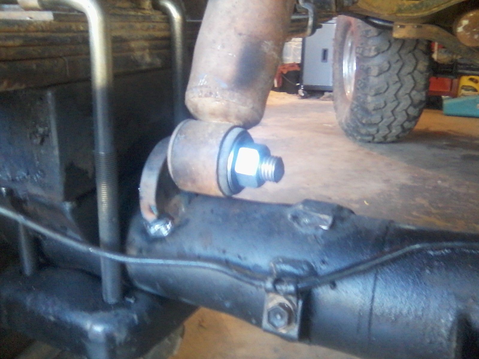

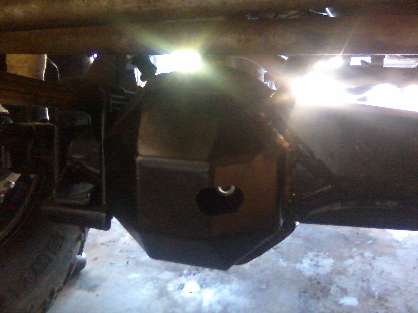

Been on the road for a while but made some proses the few days if been in town here and there welded on ballistic fab front armor moved shocks and more tube work'and 529s to the rear third

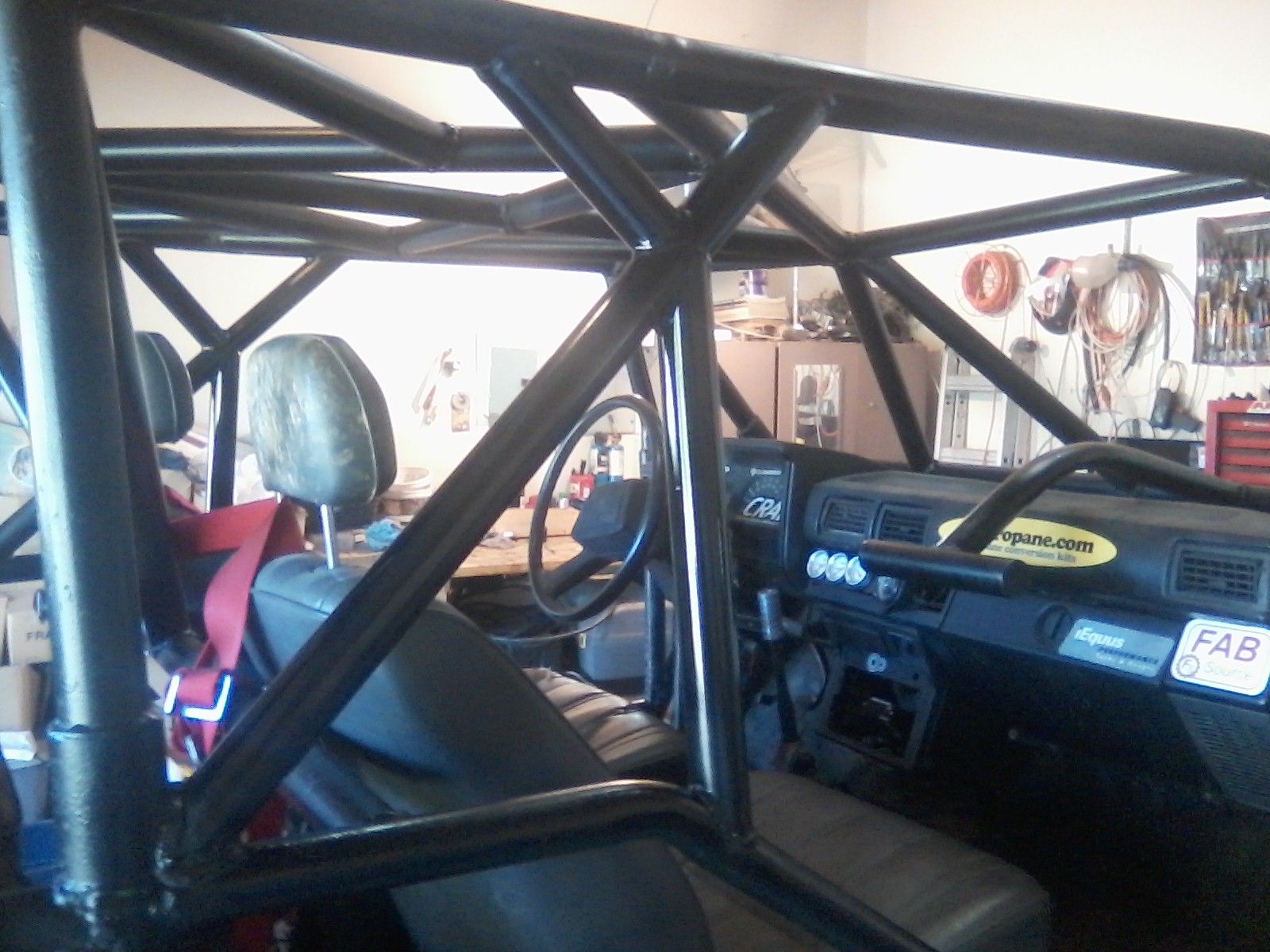

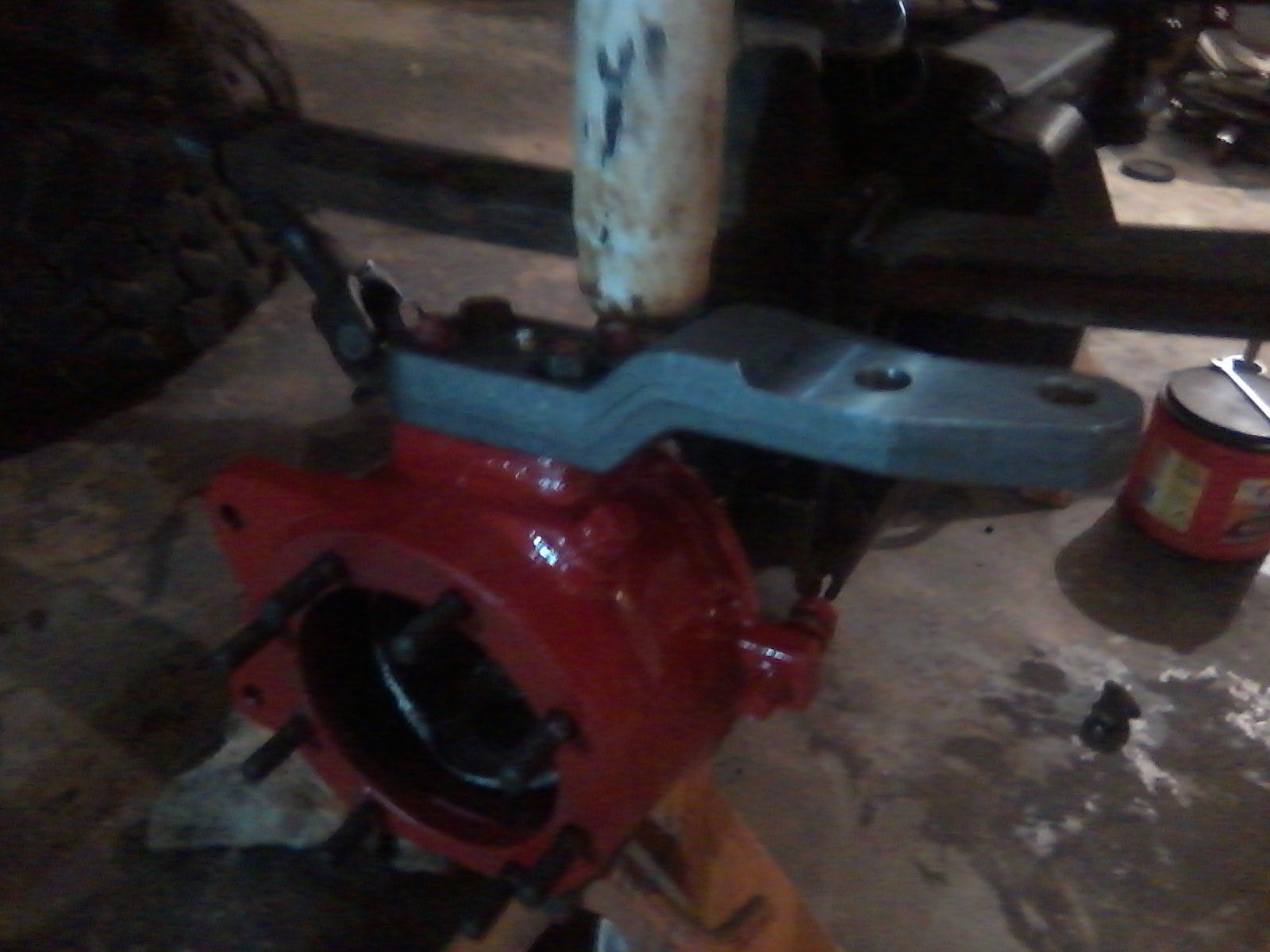

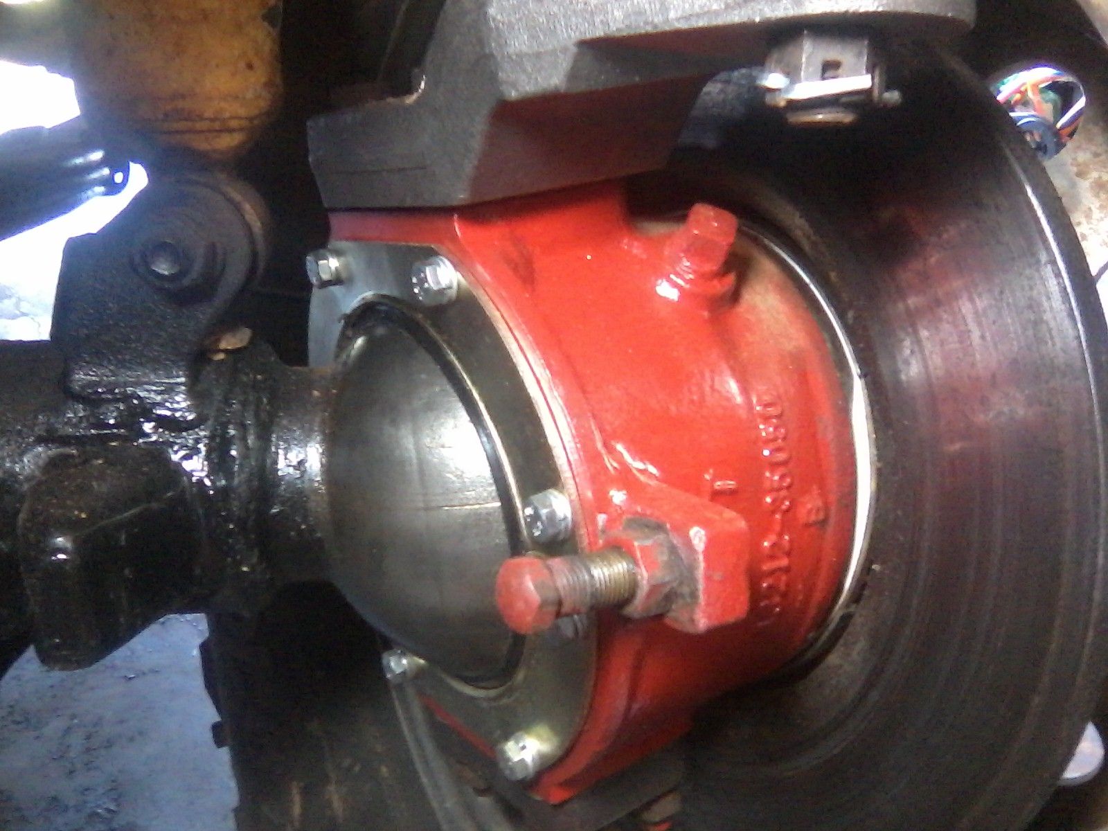

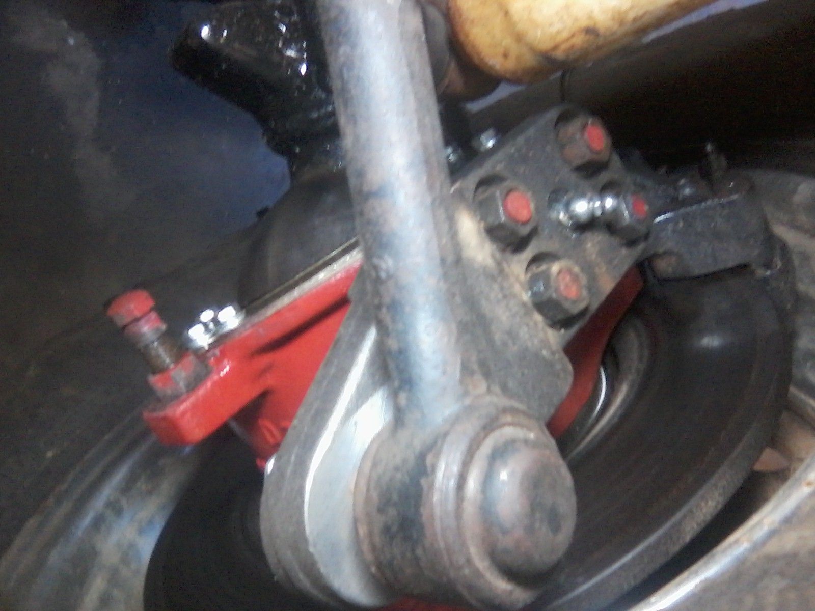

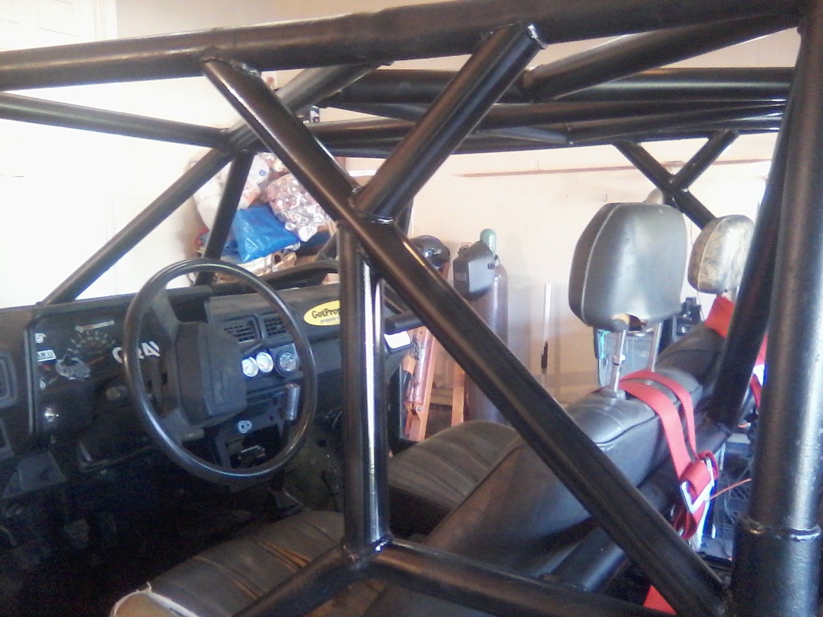

Rebuilt my knuckles added trail gear high steer arms and trunnion bearing eliminators and still stumped on the rear passenger roof

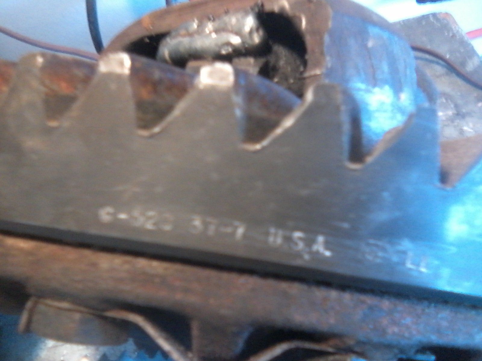

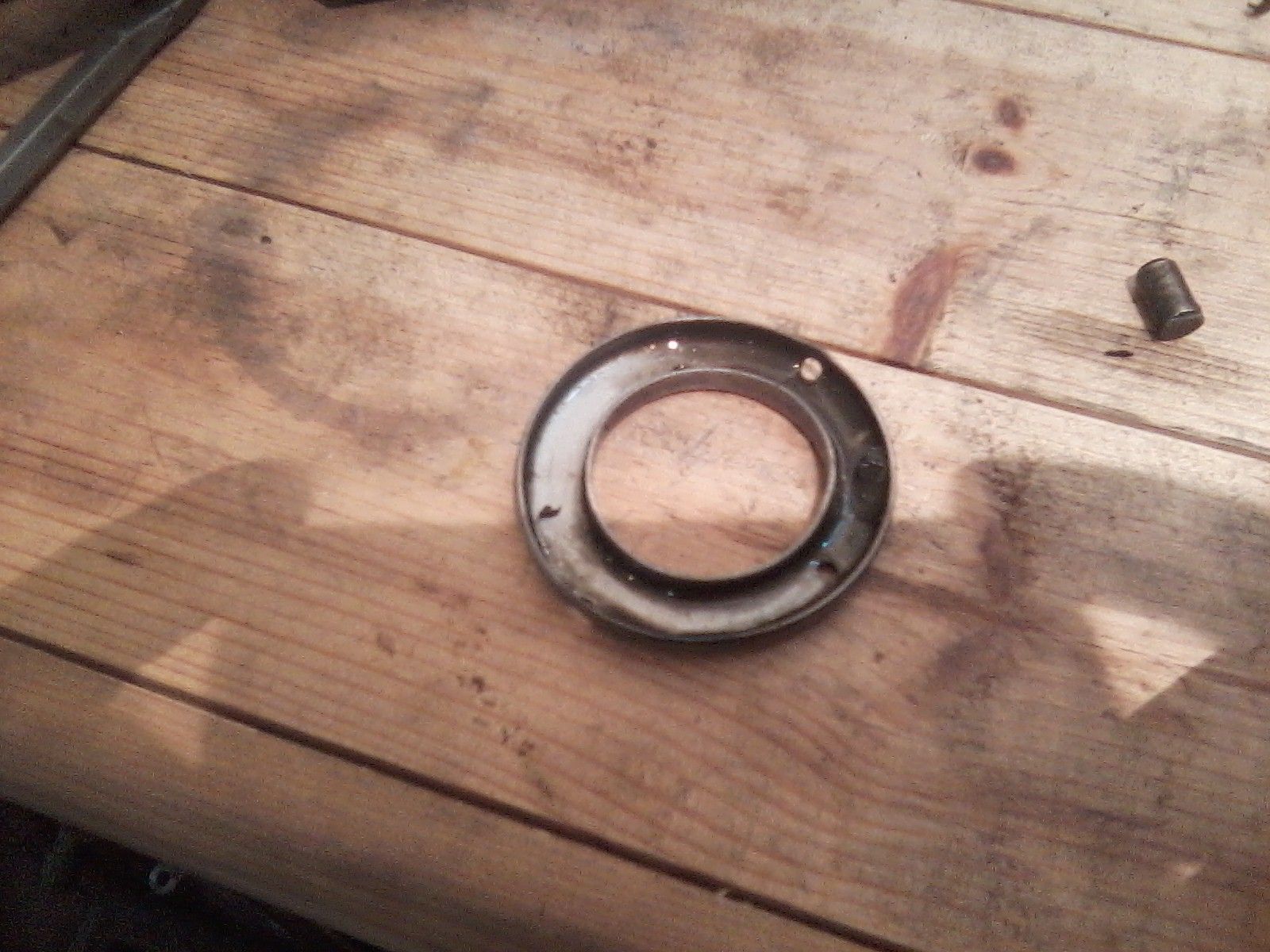

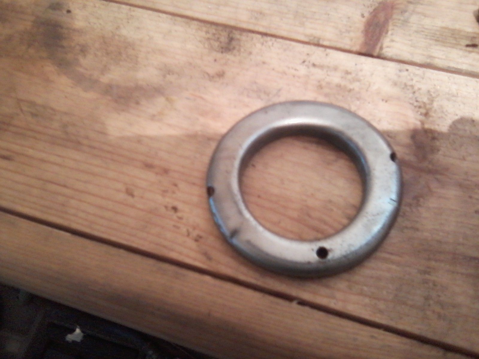

I also found this in my front axle under the dope any know what it is it a pic of both sides of it
Re: Re: 85 4 runner truggy build
They go behind the axle oil seals. Kind of keep most of the oil away from them. A pain to put in when they come out because they are installed from the inside not the outside.
When mine fell out, I chucked them (also ran the marlin seals)
I just left I out only one feel out so the other one is still in there so 1 is better than none
