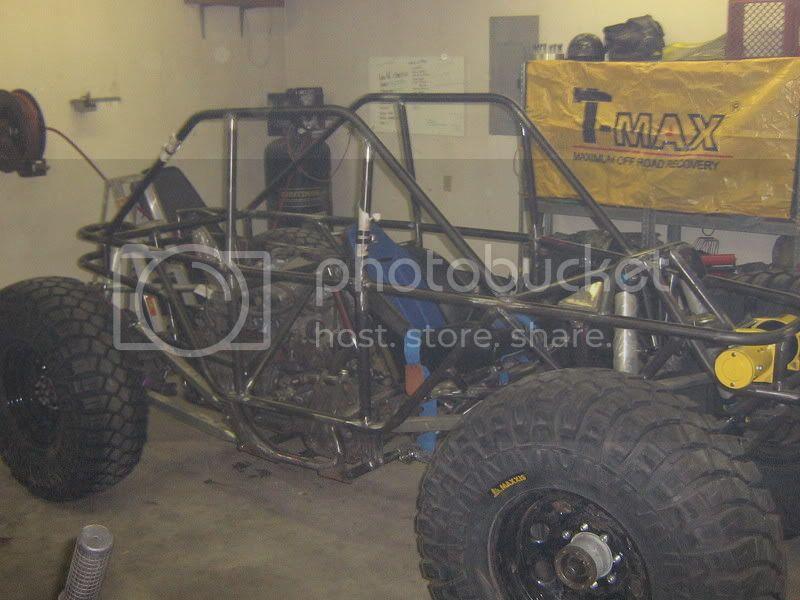

we're planning the entry and exit routes before too much is added
It's gonna be a squeeze in and out but i wanted to keep to s10 proportions and keep a good size for a std window net

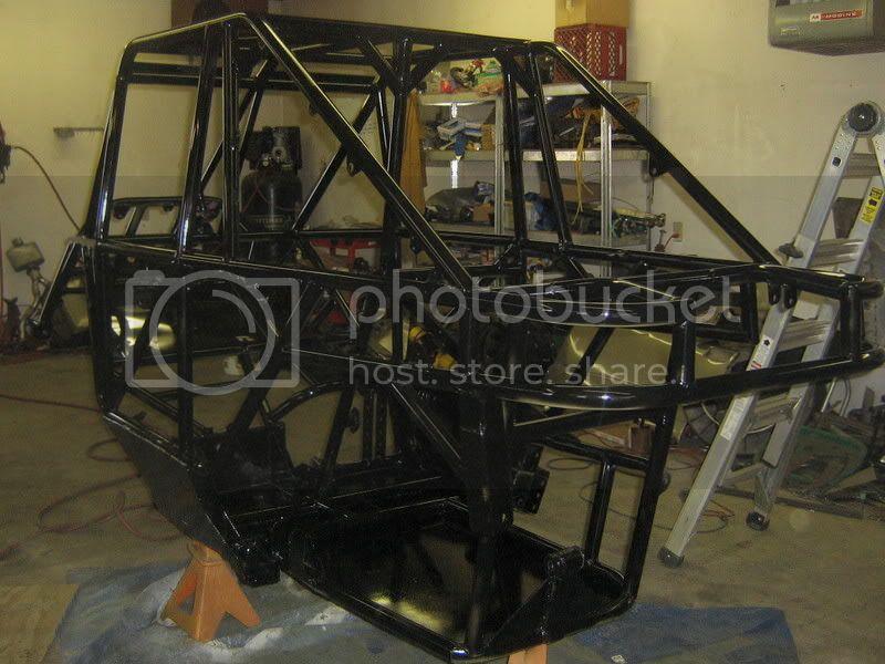

Well, chassis is welded and painted now. Gloss black so it will look good the first time it rolls out of the truck. Travis is going to finish up the front axle welds tonight and then we should be reassembling tomorrow. I don't have any pics here at work, but it does look good in black. We're cutting it close, but hope to have it running by the end of the weekend. Going to be tough though since we have my 30th bday party this Saturday.
The toter is getting worked on also, can't both be in the garage while he is painting. Can't wait for the season to get here just hope it holds off long enough to get this thing finished!
floors a little sticky but it'll cure!
We're in a hurry to bang this thing out
I still got few minor things to weld on but it's just rustoleum black so a can touch up is no biggy

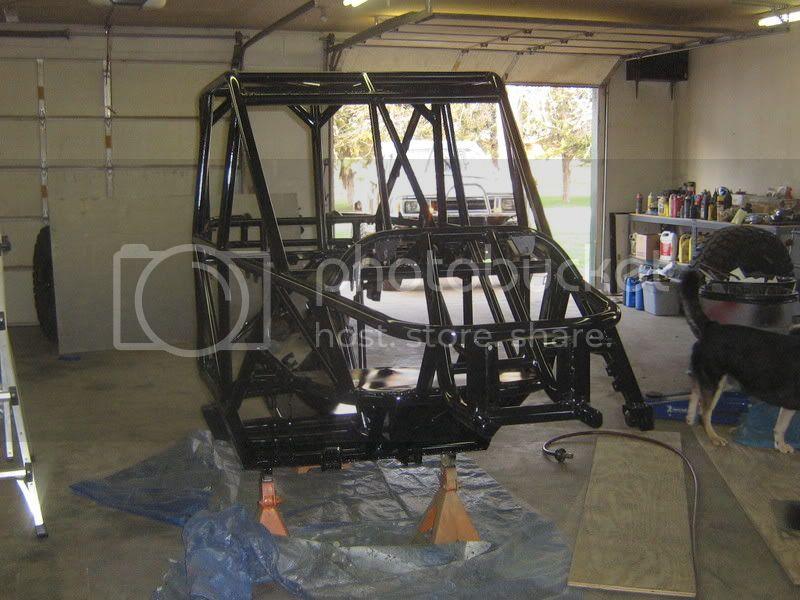

It is back under it's own weight again. Slowly getting things put back into place. The firewall is all done, just need to paint a couple pieces and get them installed. I've started the wiring, but it really sucks to do. Hopefully get it fired tonight again. I'll try and post some pics of the shorty shaft between the divorced case and transaxle. It turned out great.
