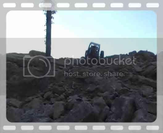

short vid of it working
at the end my brakes were sticking - a pad was installed backwards! That's a new one molaugh

With ZERO seat time, I took it slow - WAY slow. even though the pedal was floored sometimes it's not the quickest thing out there.
Damage report - 1 broke link (turned down too much) I have vid of the impact in the wrong spot

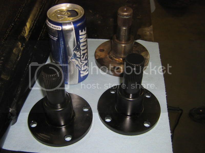

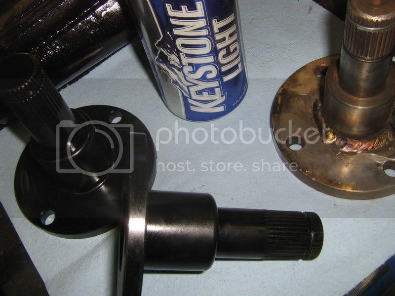

Last course I broke the intermediate shaft. It was 1310 stuff and just sheared both ujoints in one motion. I think it's just not big enough and i'm gonna try to get some 1410 junk in there. The branik output shaft held up wonderfully though.
My tranny leaks bad - hope it's just the pan but of course that's gonna be hard to remove and reseal
On the last course we let the winches out a little bit and the suspension settled some too. Like everyone saw it leans bad still
Only time it leans like that in 4wd was when the intermediate shaft has broke, I'm wondering if thats a sign that it's about to go

You need to work on that climb acceleration lean. No ****, you lifted the front left the whole way up those steps on that wall in Hannibal. Kelly and I were with the Branik guys watching and when it lifted they all went "OHHHHHHHHHHHHHH, WTF????????" That a major problem I'm work out before anything else.
so what's the problem?
What I noticed was that it only does that in 4wd right before the output/intermediate driveshaft breaks
It only did it real bad on the last course and BOOM the shaft let go.
I tried to show some other racers what it was doing and I couldn't even get it to do it????
Also before that last race we let the winches out and we think our shocks had settle a few inches causing or links to point upward from chassis to axles.
Now do you know why I was going so slow!! I have no idea what this thing is gonna do
Yeah dude, that needs to be worked out. That was some scary **** watching you go up that hill. Dont even think about changing motors until you get your suspension sorted out.

it took a hard hit on the part that was turned down too much
go here - http://s29.photobucket.com/albums/c291/91blaze/XRRA%20Hannibal%202008/
watch the vid that's called XRRA course3 and just watch the end - ignore the slowness at the begining :flipgotcha:
