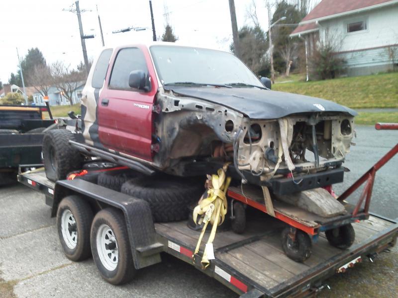

Just another build thread on a Tacoma some of you may remember.
I've had the tacoma for a few months now, but am finally getting to it!
So, this is how I received it and how I shall begin!
attachment.php
Yup, Max's old Tacoma.
