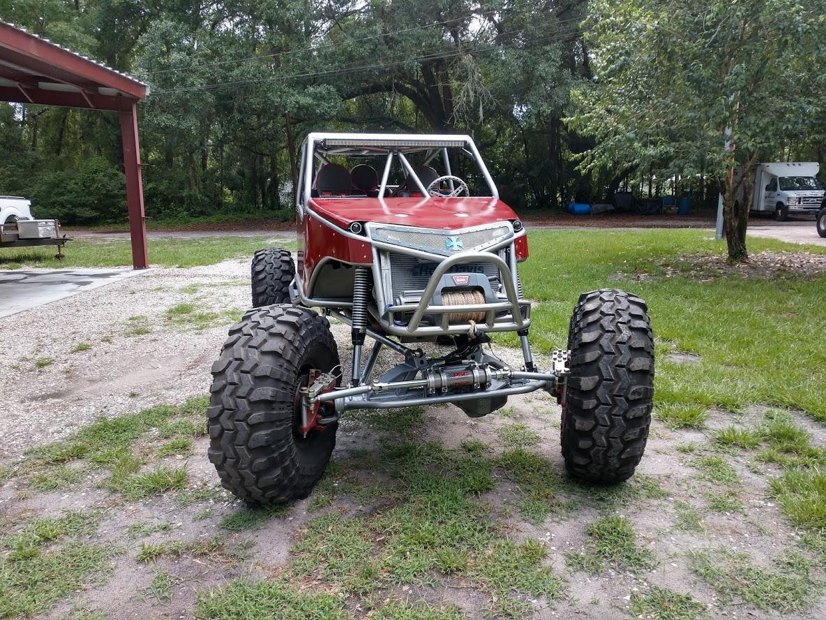

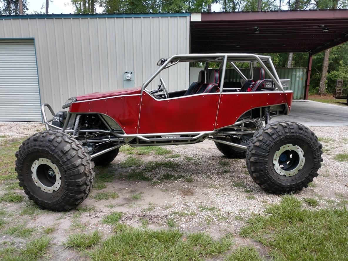

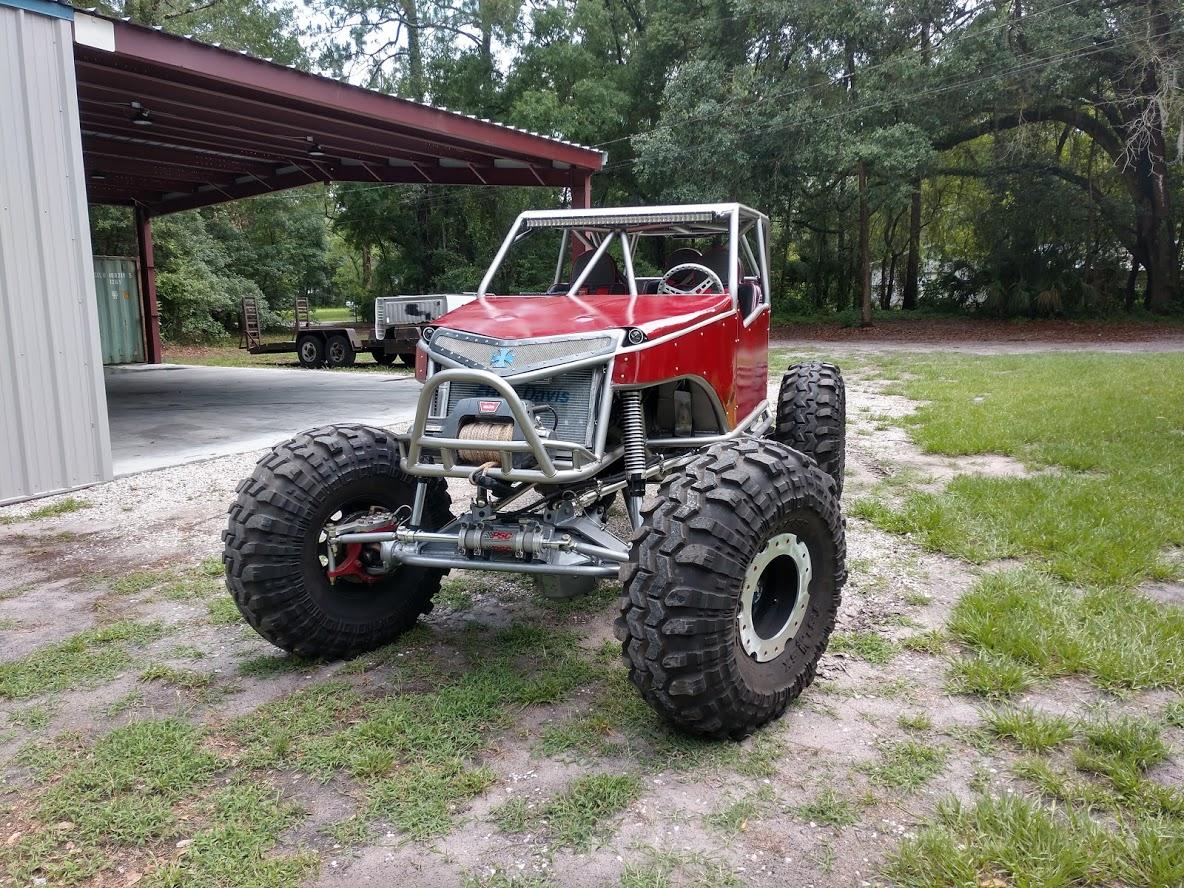

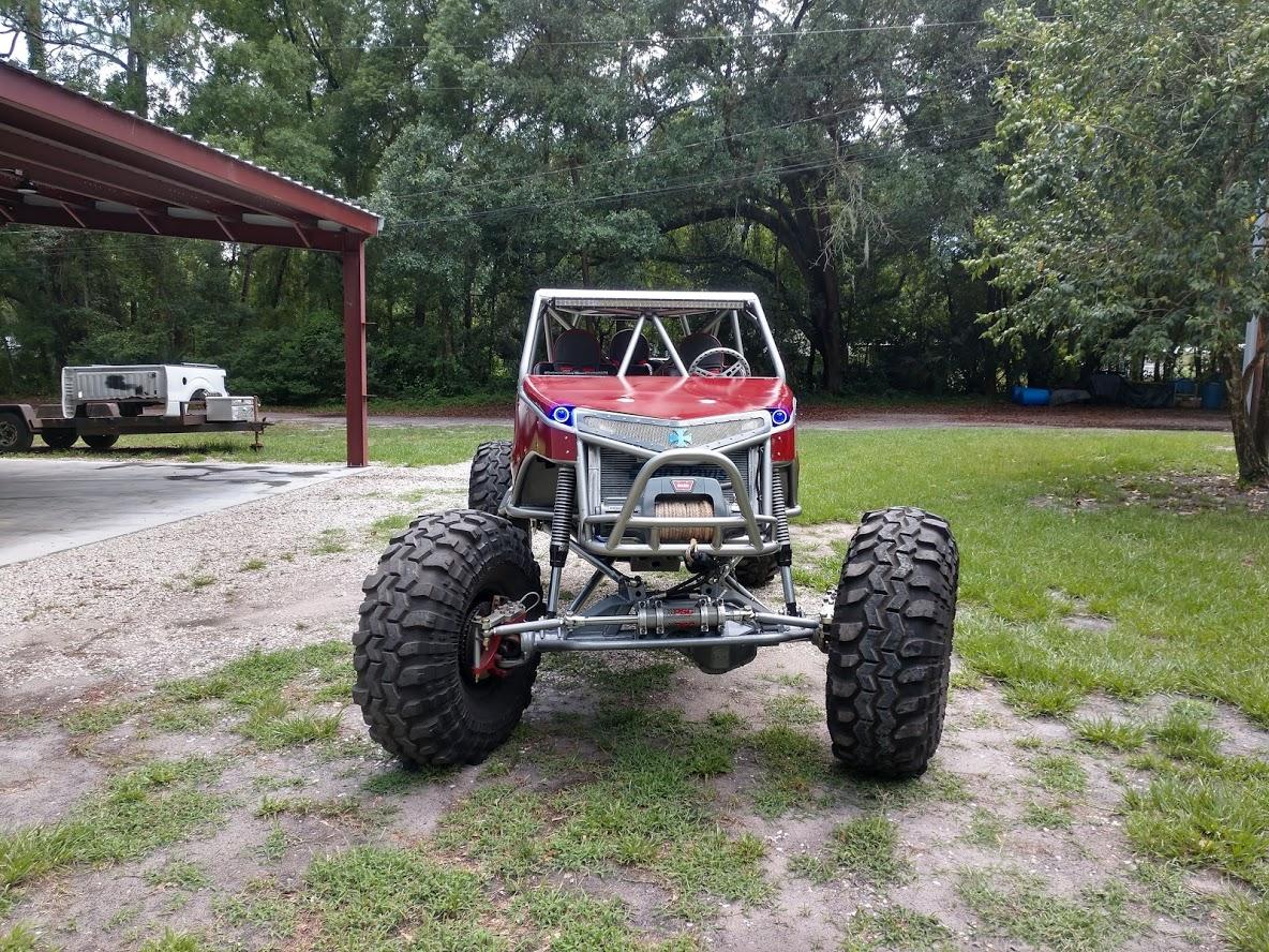

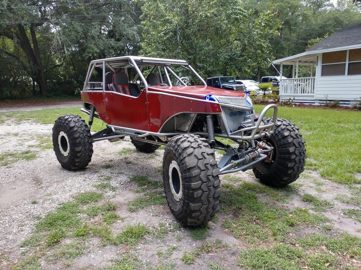

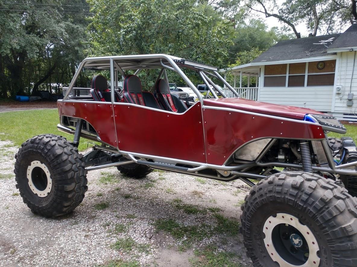

Well it took all of my sons life to do but i finally finished my buggy. Took it wheelin today for the first time. I need to finesse the tranny cooling but otherwise it did well.
Rig looks great! How did it perform on it's maiden voyage?
It did well overall as far as handling went. It turns like a battleship but I expected that as i designed it for rear steer but dont have it yet. I need to work on tuning the ORI's. I designed the buggy for a three inch lower stance. however I have the older ORI's that need to run at the 50/50 droop to compression. All of that was expected and known prior to the ride. Two unknown issues that showed up. The tranny was running hot, around 200 or so. I checked fluids etc and could not get it to cool down. When I went thru the tranny cooling system the next day the fan would not work. it worked at the park when I checked on it. Maybe it was intermittent? At any rate I am fixing fan and adding another plate cooler. Probably add a deeper pan also for more fluid. The other issue is it is choking out when i come off the throttle at low RPM's. Not sure if this is a tune issue or a tranny issue. I have to dig deeper into this. I believe the tune is looking for MAF/IAT and I dont have them on the buggy so it may be the culprit.
