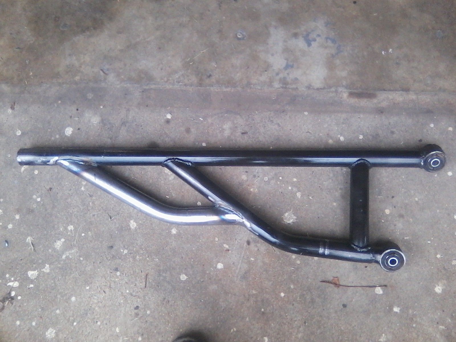

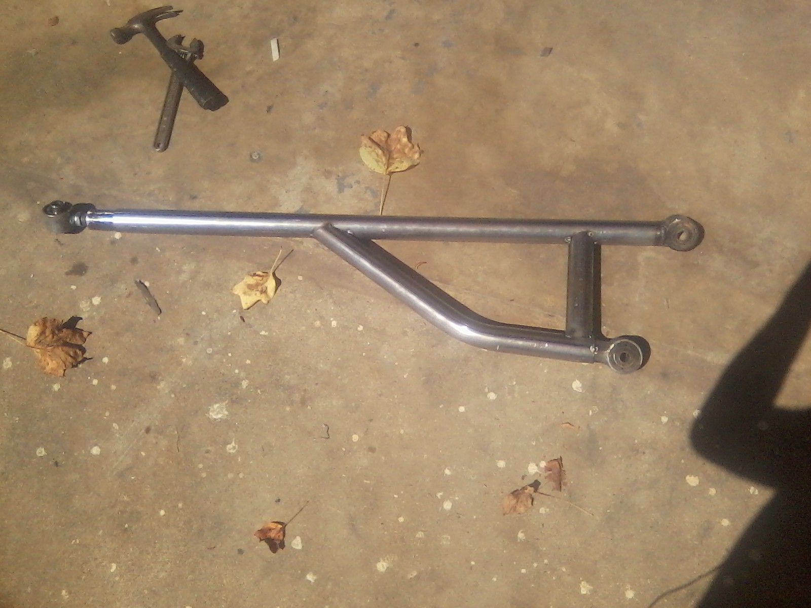

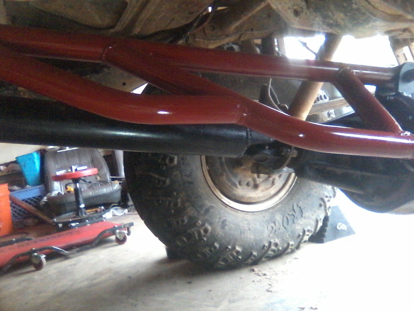

Well I finished up my anti wrap bar today here some pics and have to give thanks to Mo for the inspiration, :dblthumb: I believe I turned out a lot better that my original planned design using a shackle, now that i'm not gonna have any wrap to deal with next ride out I'll fide something else it needs probably all tho this and the duals I will pretty damn happy :****: now I wanna ride

molaugh molaugh molaugh molaugh we can go break it asap is my preference and you did have it until the moment it all went upside down then you lost it :****: at least I was nice enough to get a picture for u :flipoff1: and thanks for the comments guys I appreciate it I was gonna put one more piece of tubing in the middle of the y'd part but all the bent pieces of tubing I had looked nappy when I laid them in there so I went with that

Just an observation...
You'll want to add to the bar to the front like so.... it will break at the weld part or bend how you have it....been there...

I kind of though about that ...want it to at least go to were the 1.5 x .250 is huh well I'll do some mods to it today

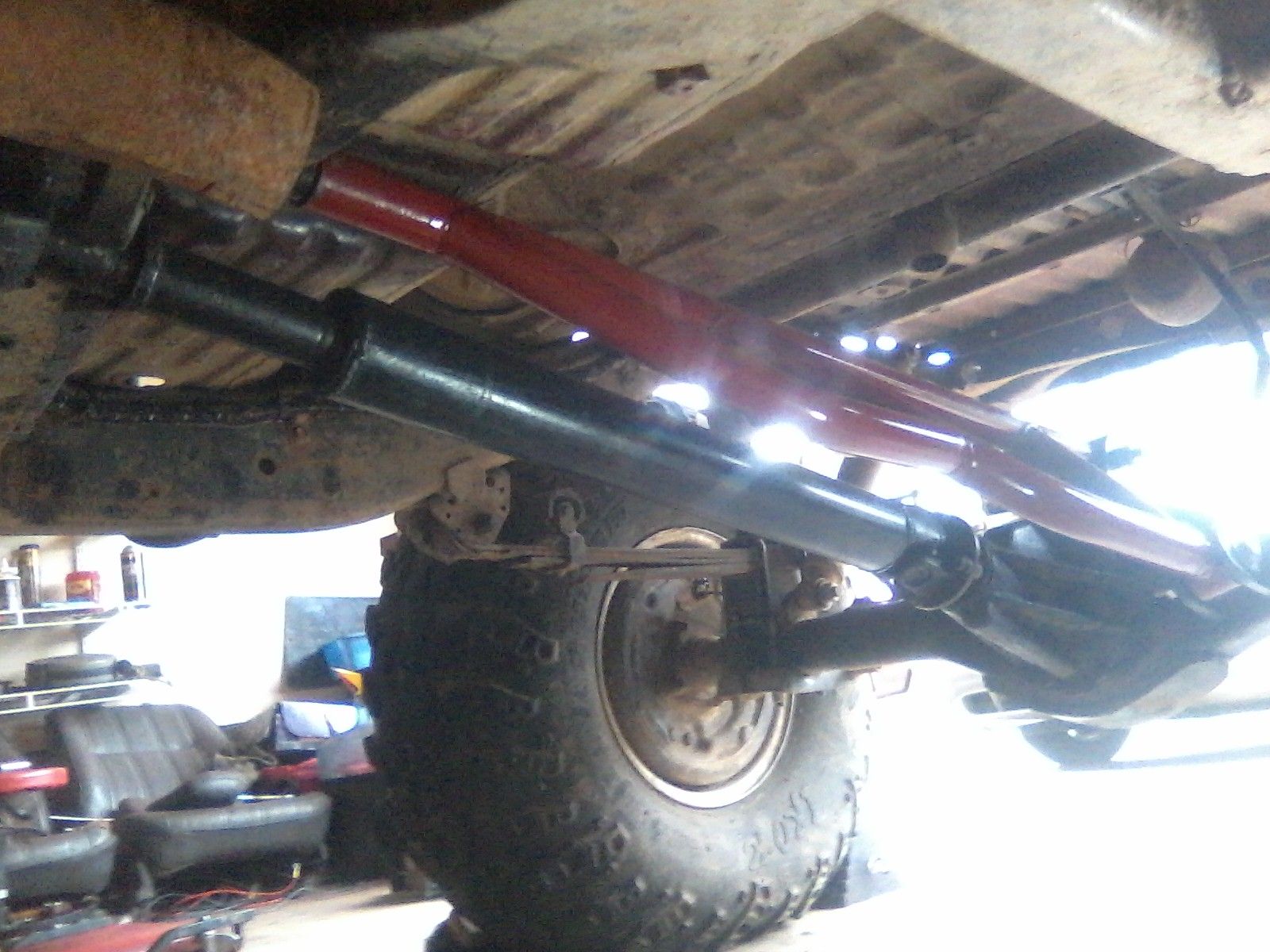

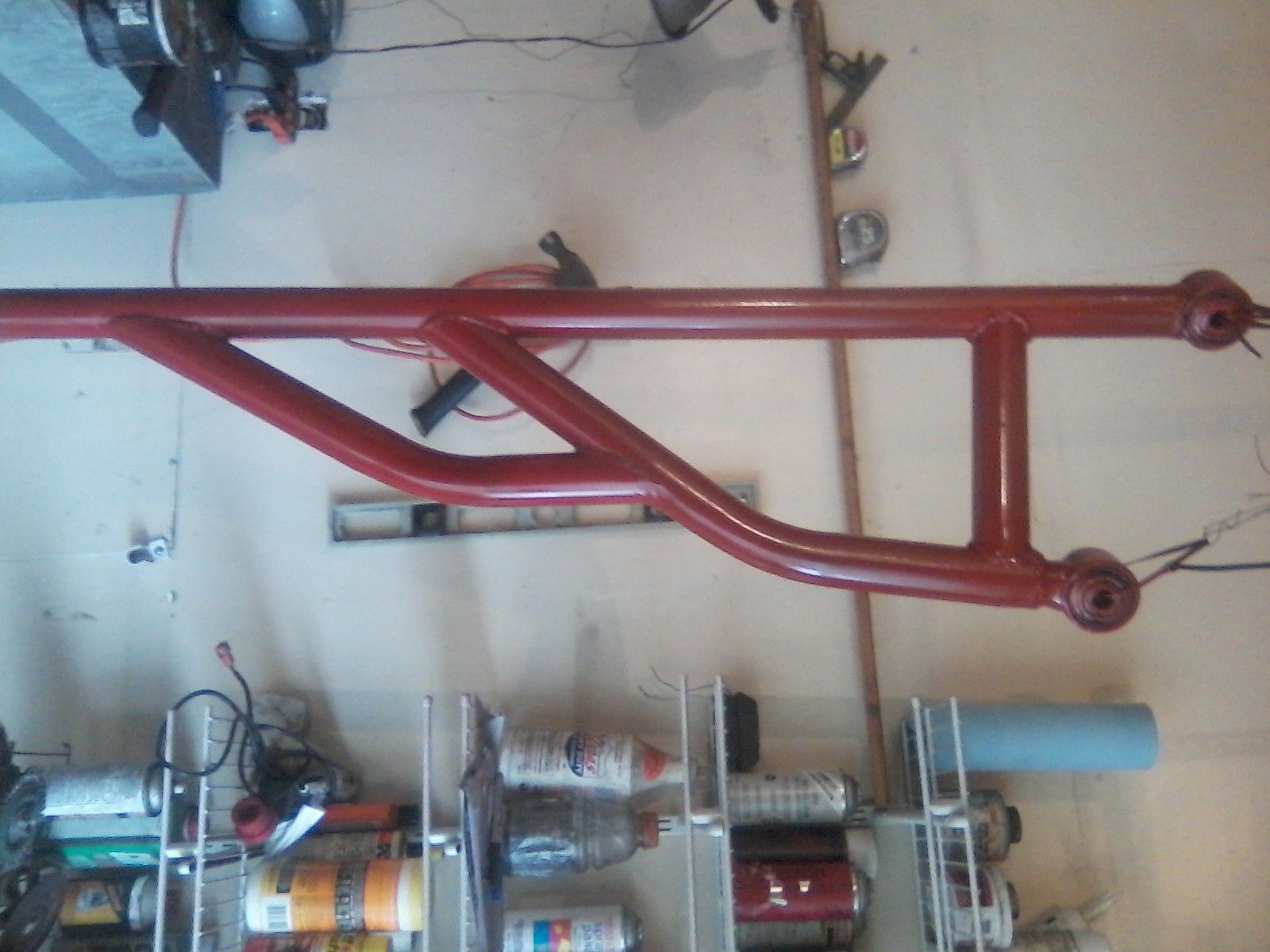

Well again taking Mo's advice I modified the bar and added another piece to it all tho after measuring my 1.5x.250 wall went past the y by 3 inches at ride height but I do like it better now here's some pics of the newer bar

Re: Re: anti wrap bar placement ?
Glad I could help.. on mine, the 1.5"x.25" inner is 18-20" to hit the most surface, yours should hold up tho!
