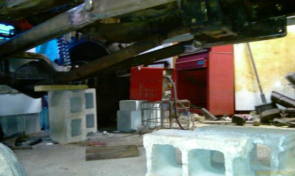

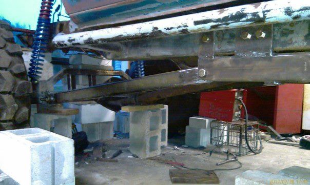

Here are the pics
Re: 4 link on a budget
Those are the ones you weld on? Just the spears? Have you beat on them at all how they hold up?
