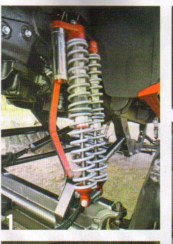

wtf? how the hell were those shocks mounted? would love to see what the fab work looked like before it fell apart.
It looks like they just sheered the lower bolts to the c/os. :eeek:

Looks like the coilovers were held on by one little bolt on the axle. Not even supported on both sides:haha:
No way that one bolt down there would hold up to that much weight :rolleyes:
paint budget was higher than the bolt and tab budget.

Yup, single shear and what looks like grade 5 bolts. :haha:
That would be a shock mount and not a very good one at that. Not a coilover shock mount........But it took such a prety picture that had to be good for something.:haha:

Two more tabs on each mount and they would be fine :haha:
